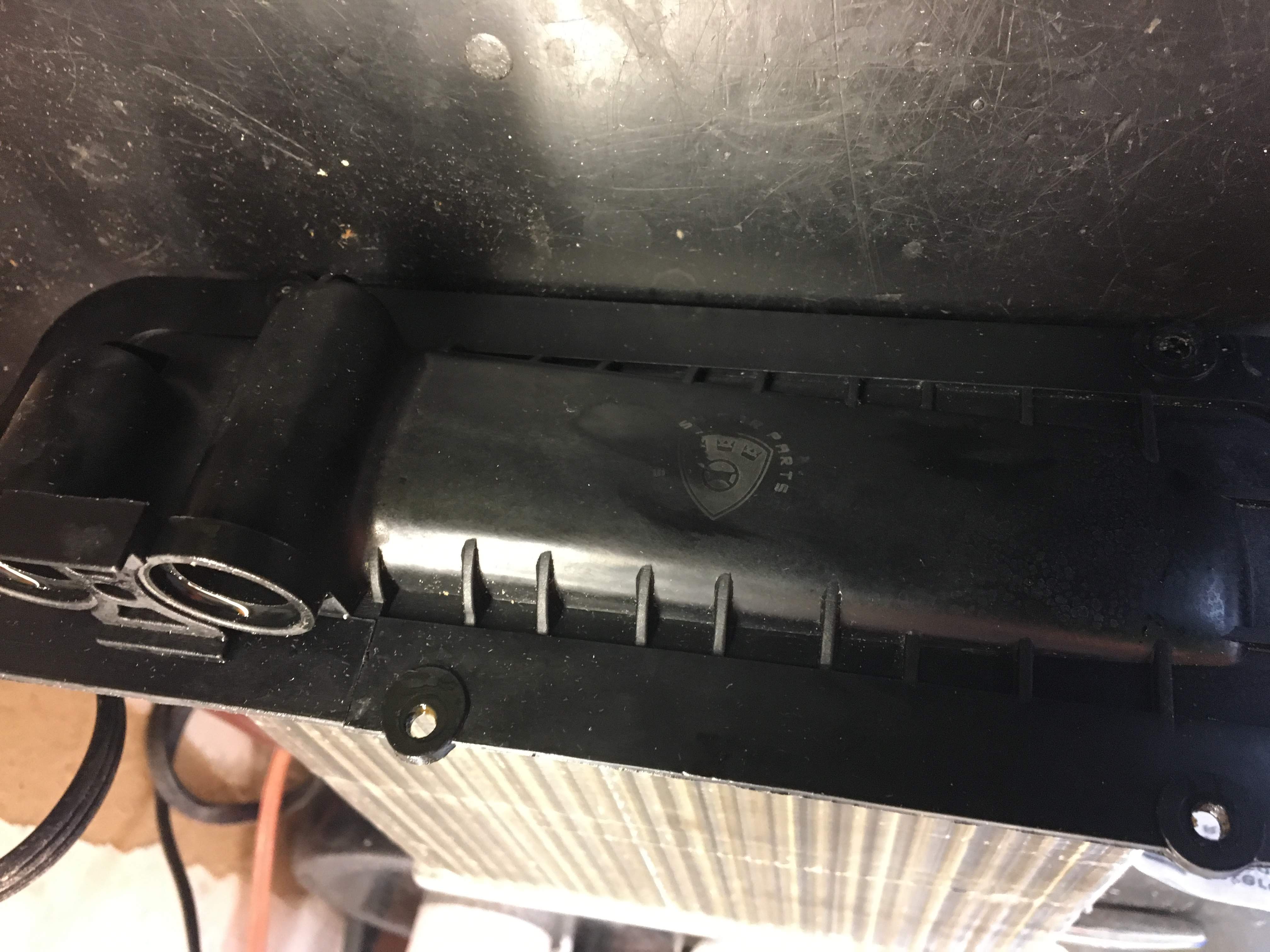

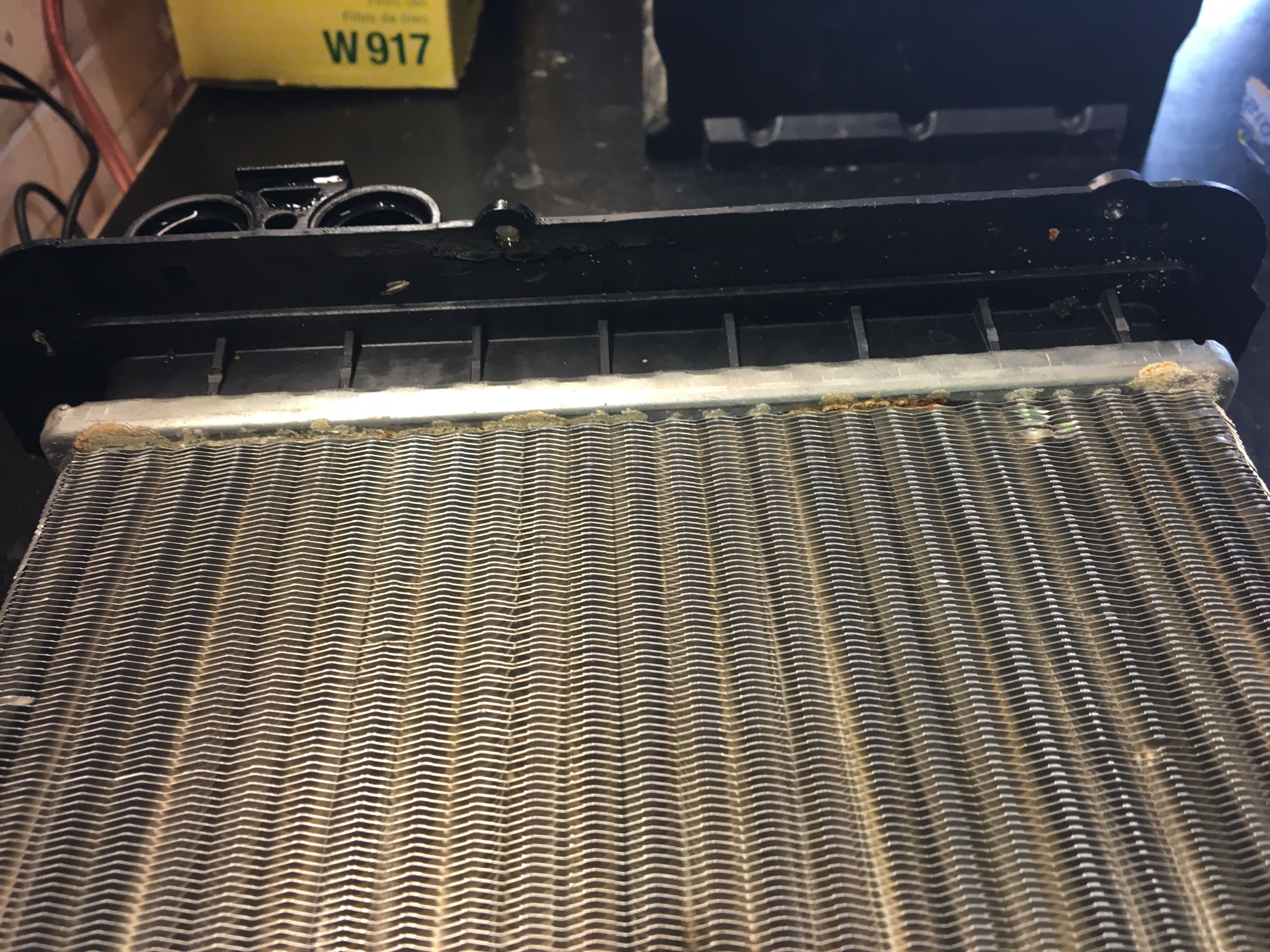

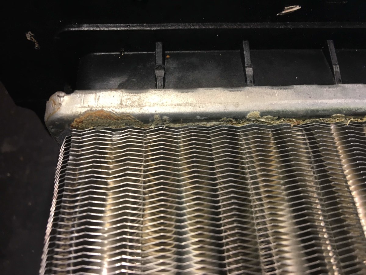

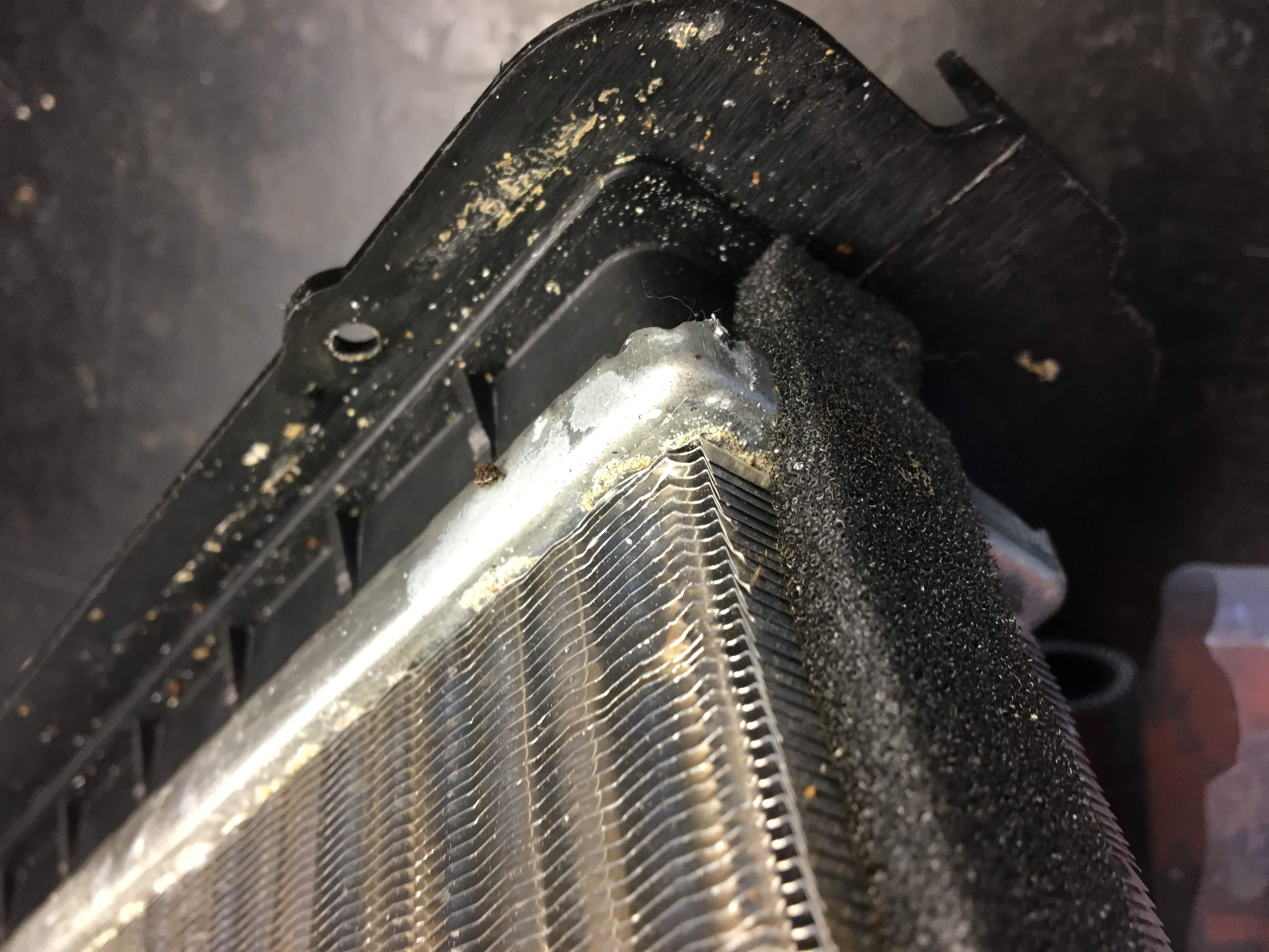

I changed the heater core in my GLT today, and the old one was a Swedish Car Parts unit. It hadn't blown out completely, but there is evidence of a leak (white crust around the bottom). It wasn't wet or anything, and I was surprised to not find any coolant anywhere.

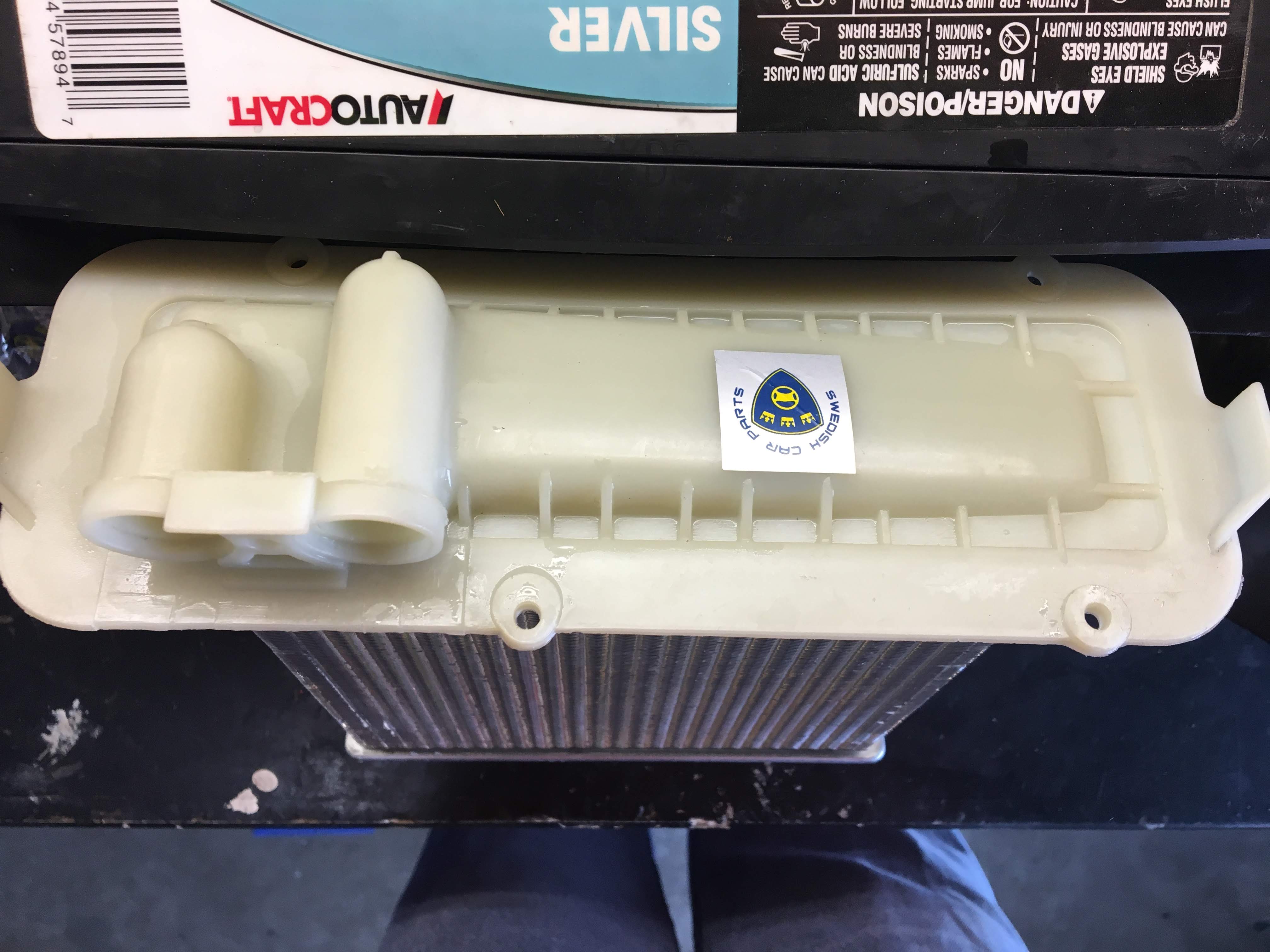

New SCP core went in. Interesting to see the older one (black plastic) has their logo printed on the tank rather than the sticker on the newer cores (white plastic). We'll see how long this one lasts!

My two Volvo originals were leaking at same exact spots. Metal tubes to metal base.
