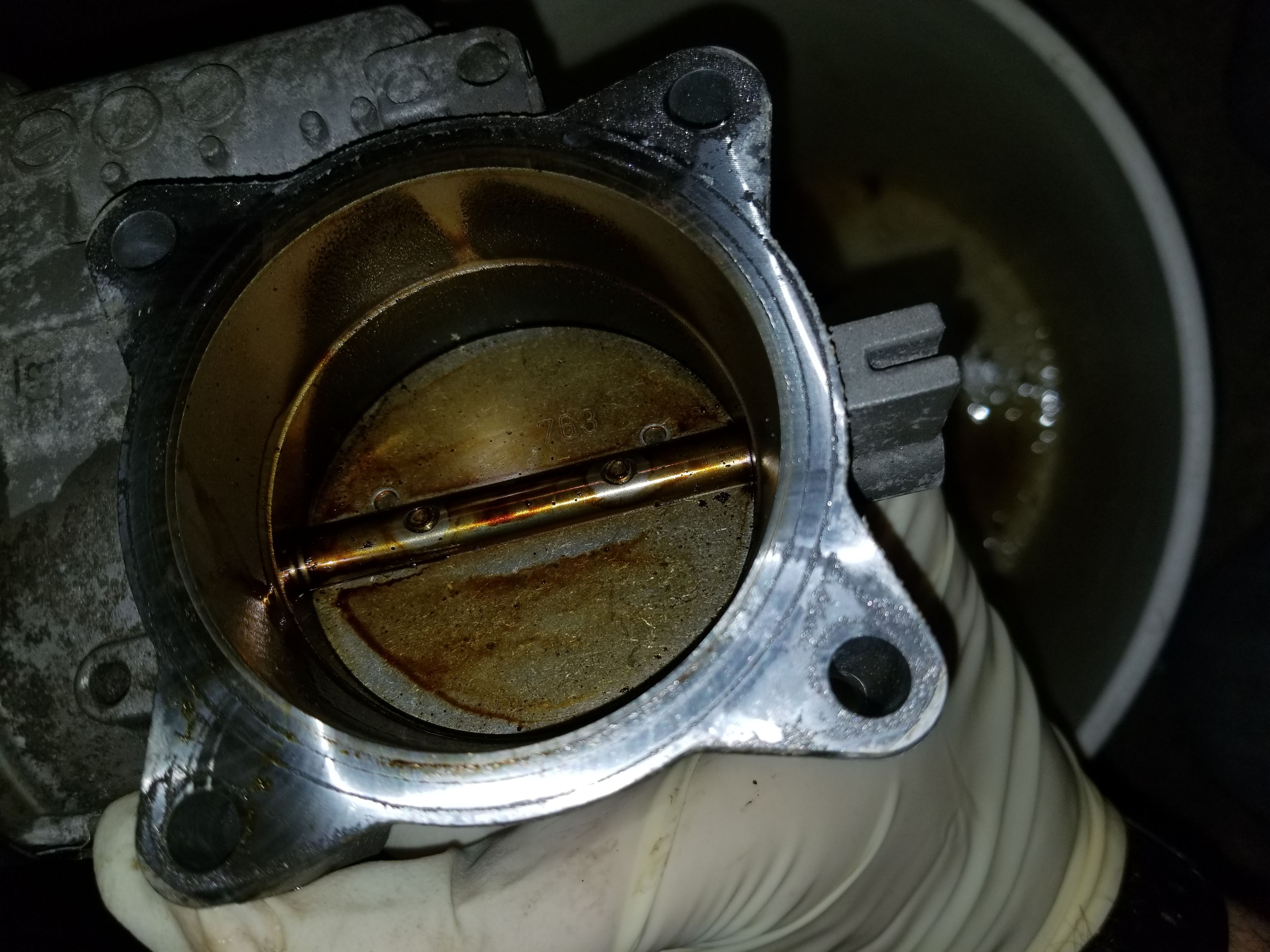

2. Cleaned ETM.

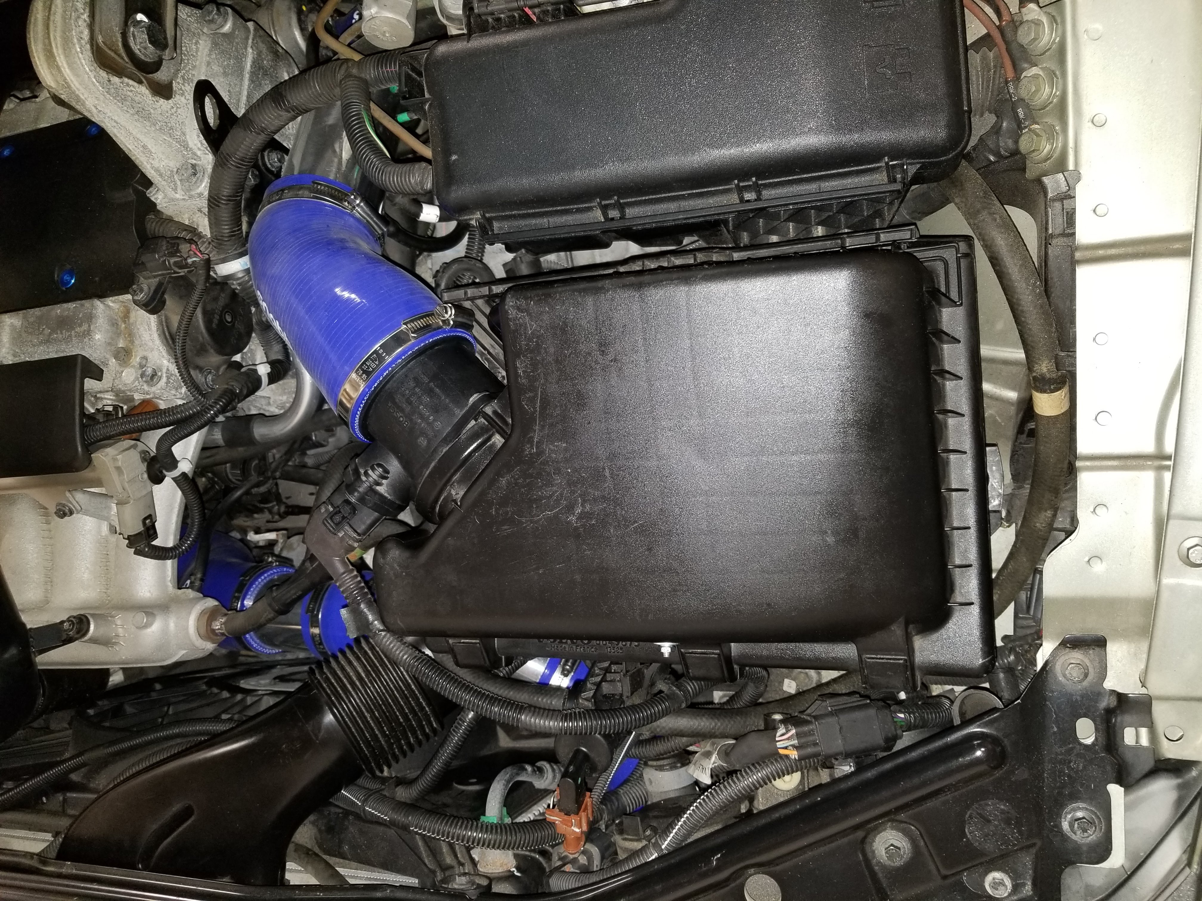

5. Installed Snabb intake pipe (have decided to keep stock airbox).
6. Installed Snabb Intercooler-to-Throttle Body pipe.

Dirty/Clean ETM:
Intake manifold and ETM cleaned prior to reinstall:
New snabb pipes in. The intake pipe was pretty easy, the lower one I installed after re-fitting the intake manifold and I had to adjust a lot to make sure it wasn't contacting the starter motor and had a good seat on the throttle body. The difference in sound with the intake pipe is very slight, but noticeable. I decided to keep the stock airbox.
