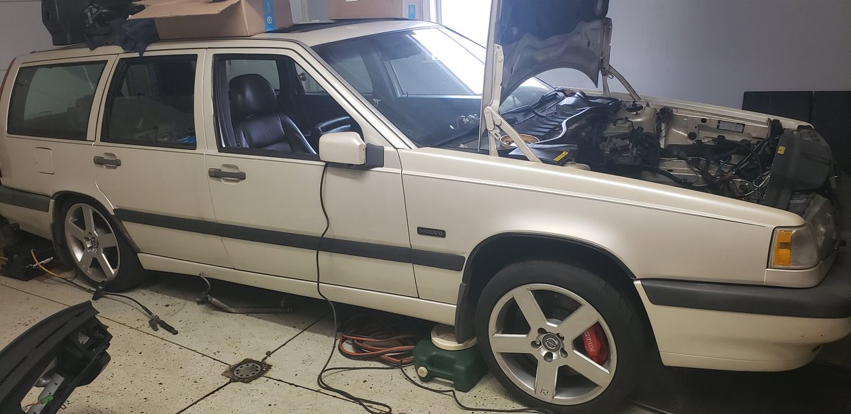

I'm new to this forum and figured I'd share a build thread for those of you that are interested. I'm 20 years old and have been saving for a long time to build this car, I've went through 3 autotragics in the past year 🙄

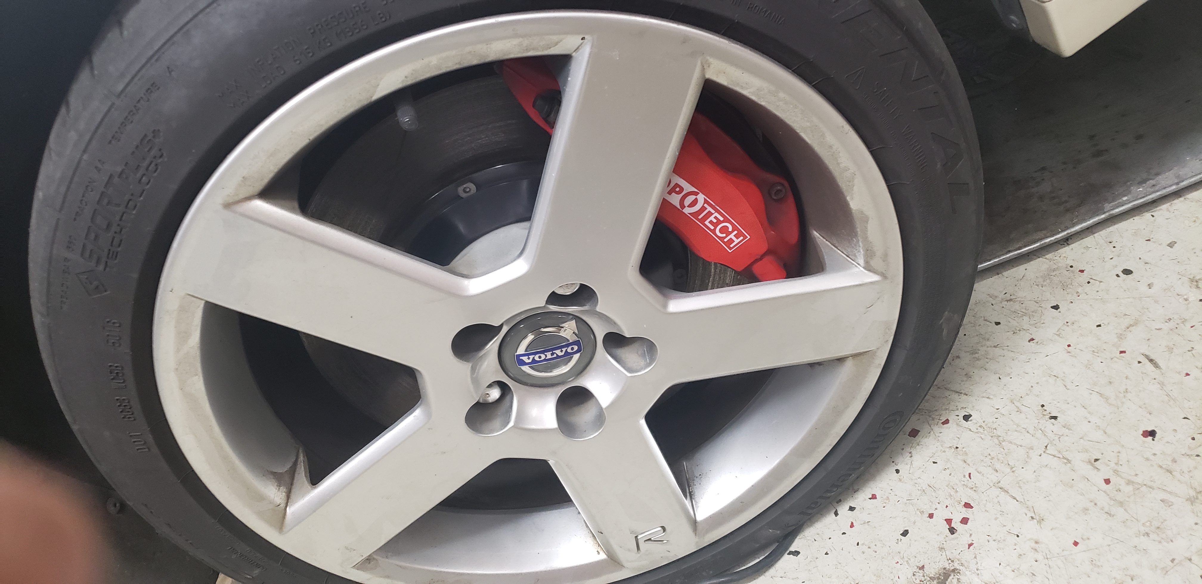

The mods the car had prior to tearing it apart was IPD full catless exhaust, IPD turbo controller valve, rebuilt td04hl 16t angled flange turbo, DO88 front mount intercooler, Reverse intercooler piping, All snabb boost piping, IPD sway bars, Koni lowering springs, brand new polyurethane bushings all over the suspension, StopTech big brake kit 2 piece rotor 4 piston caliper brakes. The car itself Is a 1996 Volvo 850 turbo Platinum Edition wagon with approx. 190k miles.
The manual swap came together when I found a 1997 Volvo 850 5 speed for 500$. I now have the motor and transmission pulled out of that car, and have my wagon in the garage with the motor and autotragic pulled out. The block itself is at the machine shop right now, and my parts list goes as follows, please feel free to give me any suggestions or ask any questions, as this is alot to take on at one time.

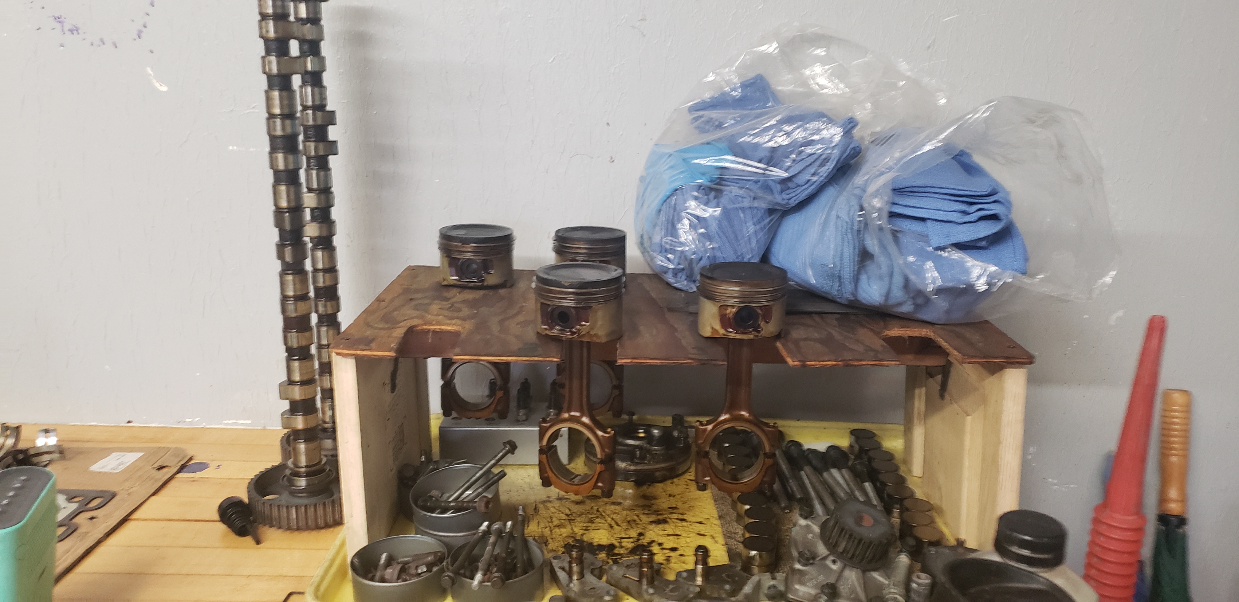

Stock internals
Stock internals

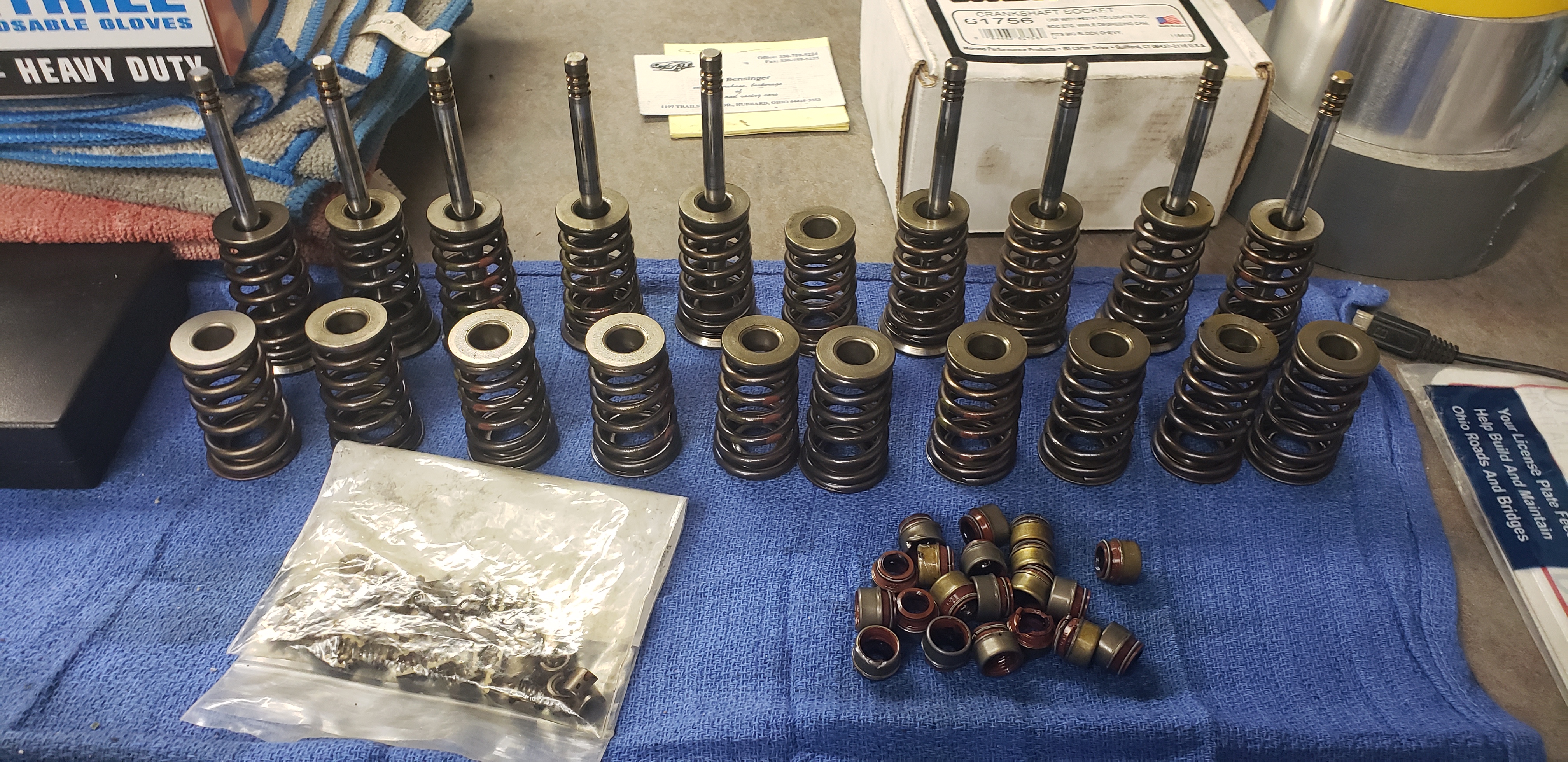

Stock valves
Stock valves

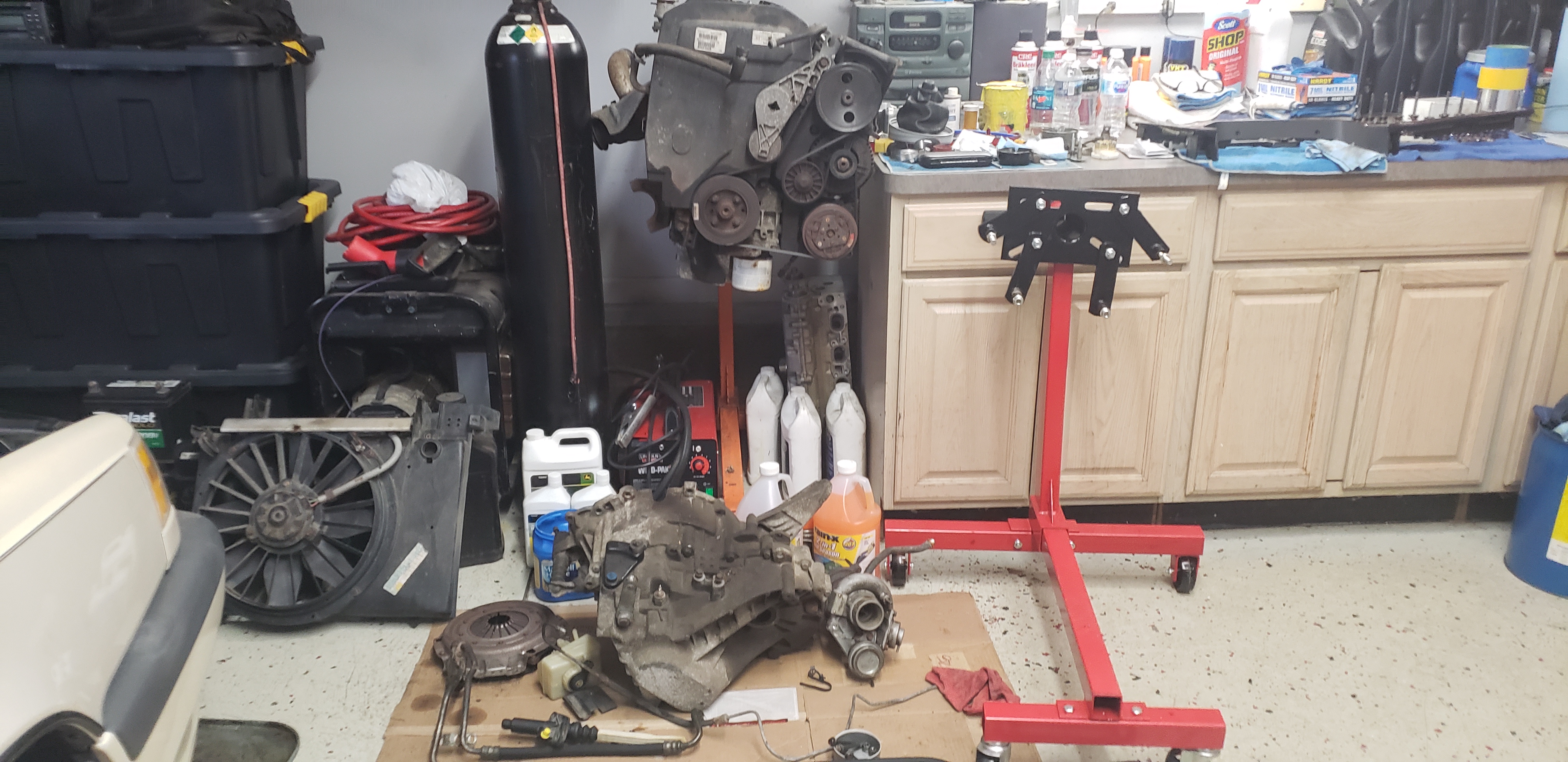

N/A engine manual transmission. Stock angled flange td04 16t turbo
