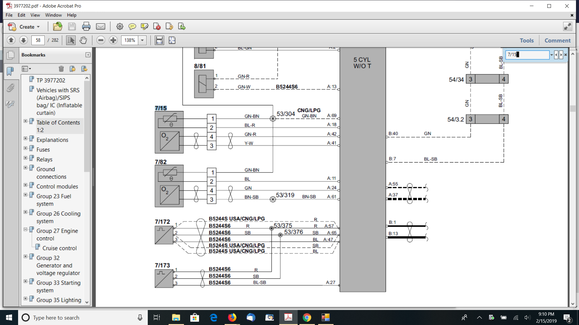

Where are you taking the measurements from?
Pins 1 & 2 are the heaters.
Pins 3 & 4 are the O2 sensor.
Did you check both wiring harnesses? The heater supply is common to both.

Checking pins 1 and 2 ( same color wires) for resistance on the sensor, getting about 6 ohms. And 3 and 4 on the connector. Getting 12.8 volts from the signal wire. Looking at the live data on the scanner also.

Oh and by the way, thanks for the response and the diagram. Very helpful. I can use it for further details and tracing the circuit. πŸ‘
