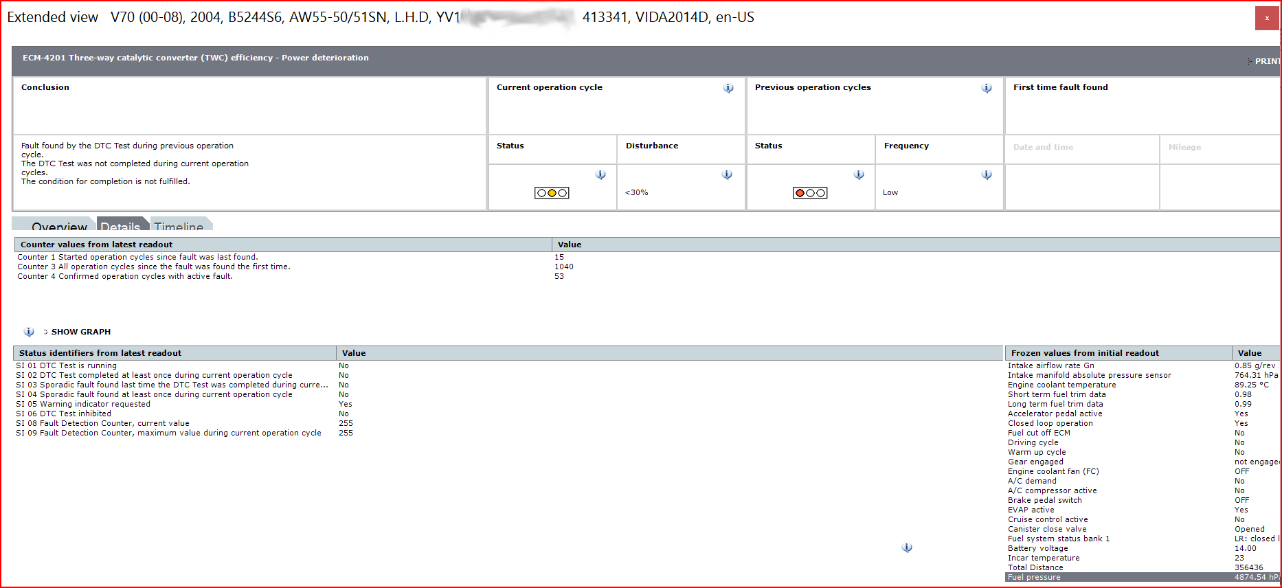

The VIDA counters (see attached screengrab) show:
Counter 1 - Started operation cycles since fault was last found........................15
Counter 3 - All operation cycles since the fault was found the first time........... 1040
Counter 4 - Confirmed operation cycles with active fault.................................. 53
So, this is a VERY intermittent issue.

Your attachment is displaying ECM-4201 (not ECM-4801).
A faulty MAF is one of a handful of things that can trigger the ECM-4201 code so do as Jones suggested and unplug the MAF next time it happens.
