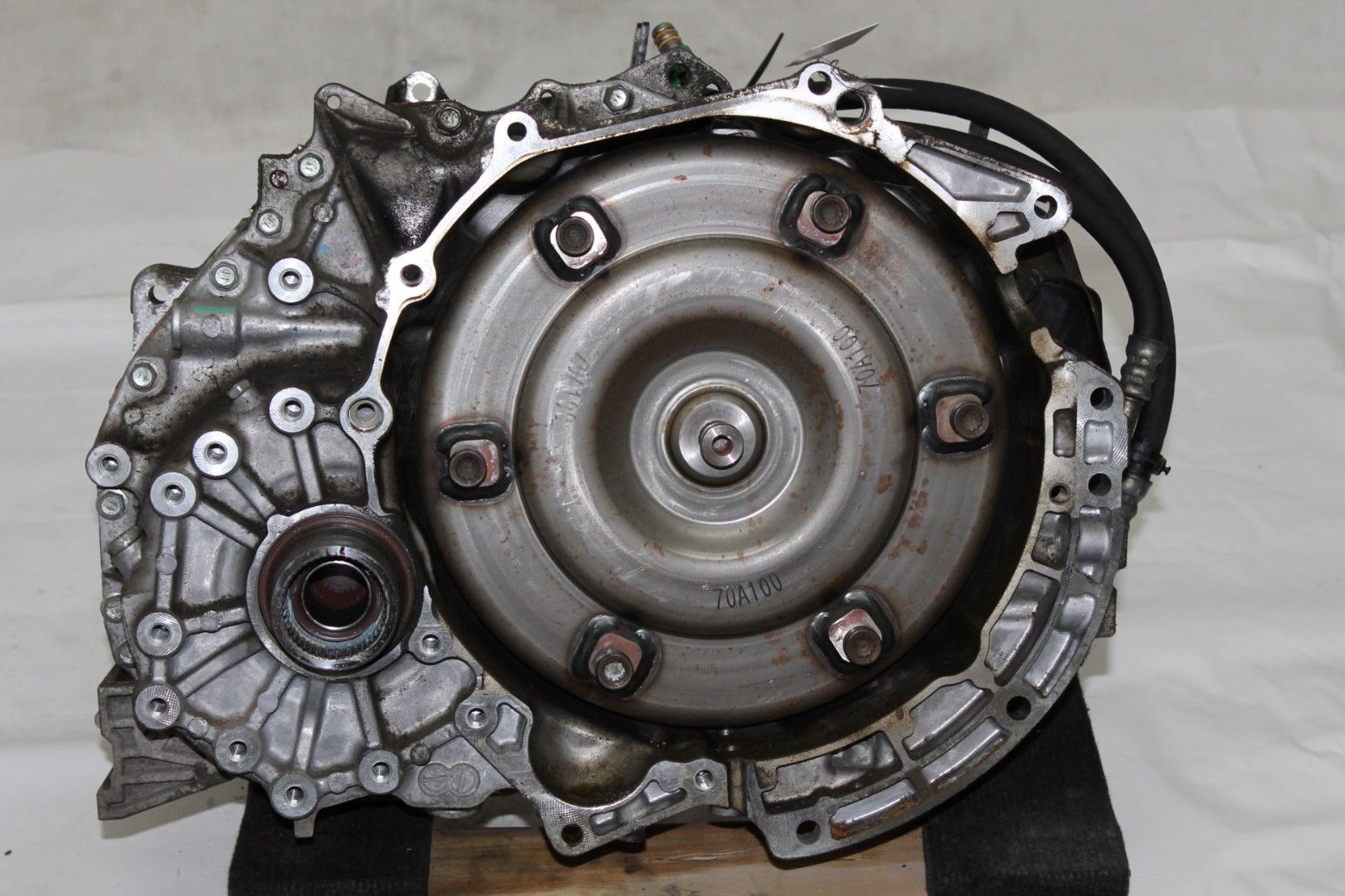

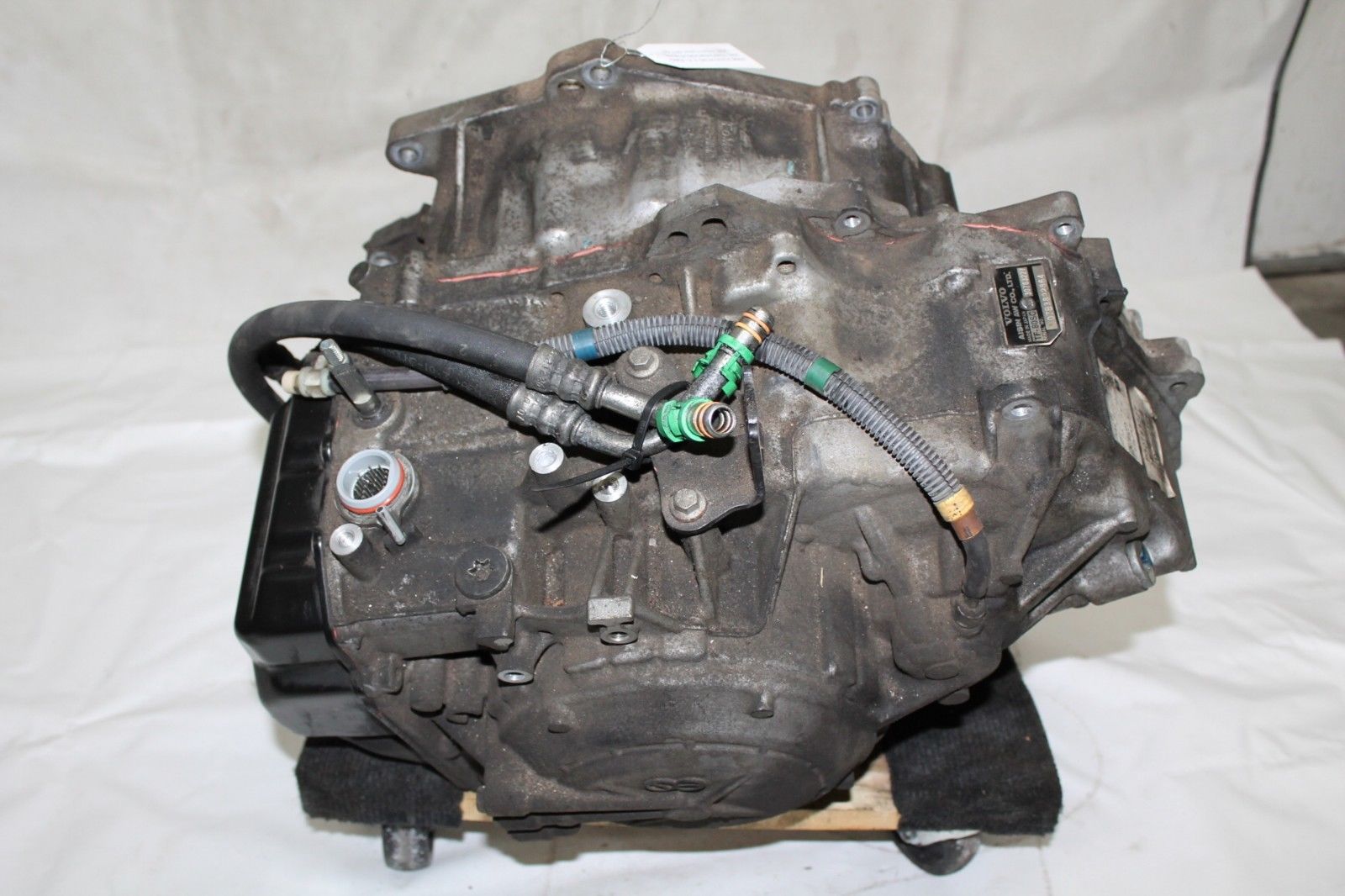

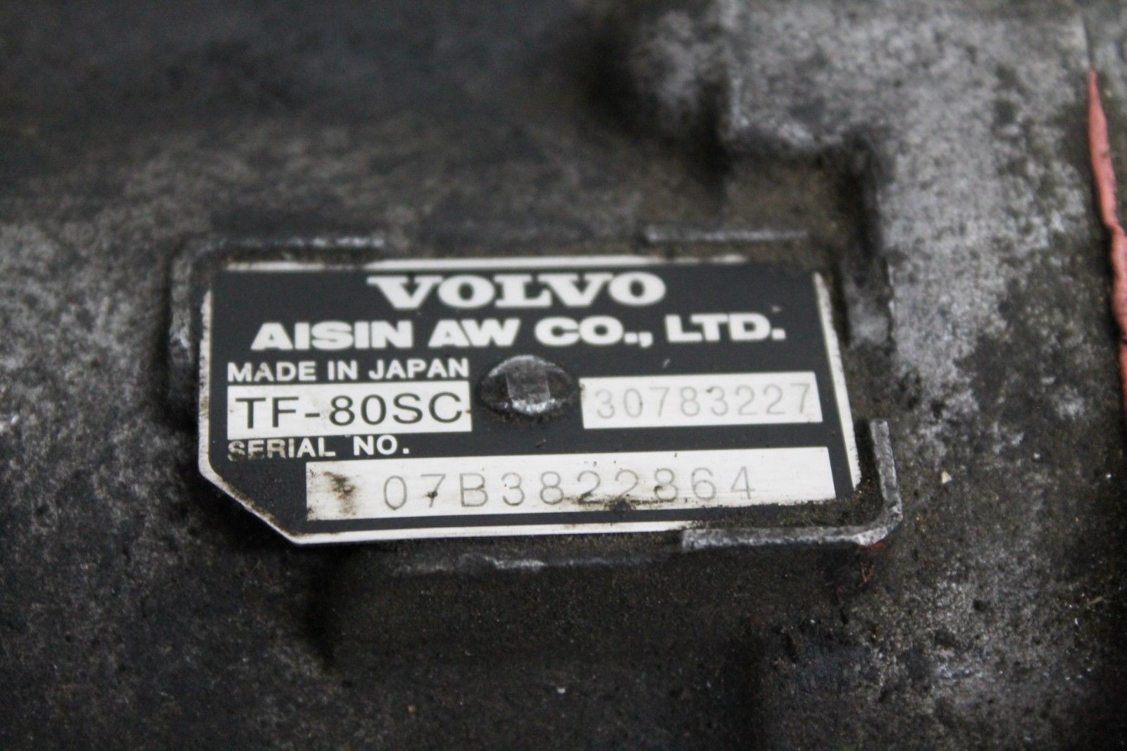

2008 XC90 - 3.2L - AWD - TF-80SC 30783227 tranny.
I'm swapping out the tranny next week with an identical year and numbers replacement. I have 115k miles and the new tranny 87k.
I'm also using the TCM from my existing tranny as the new one doesn't come with one (photo below)
Will I see all that needs reset in VIDA? I know there's a counter for fluid change.

Hi, I hope you dont mind a few questions!PoppySheaf wrote: ↑15 Feb 2019, 13:41 It's exhibiting the classic T6 symptoms I read about- shuddering from 2-3 & 3-4, flares and getting progressively worse.
Throwing no tranny codes. Local very reputable tranny shop drove it and said it fells very much like the torque converter.
Fluid is clean.
Definitely flushing and changing fluid. Also installing an hydraulic (Parker 10 micron) filter in-line on the cooling line.
GPMs and PSI rating are high enough not to slow fluid flow down.
Using the torque converter that came with the replacement.
Thanks for the reprogramming info - that's exactly what I needed!
