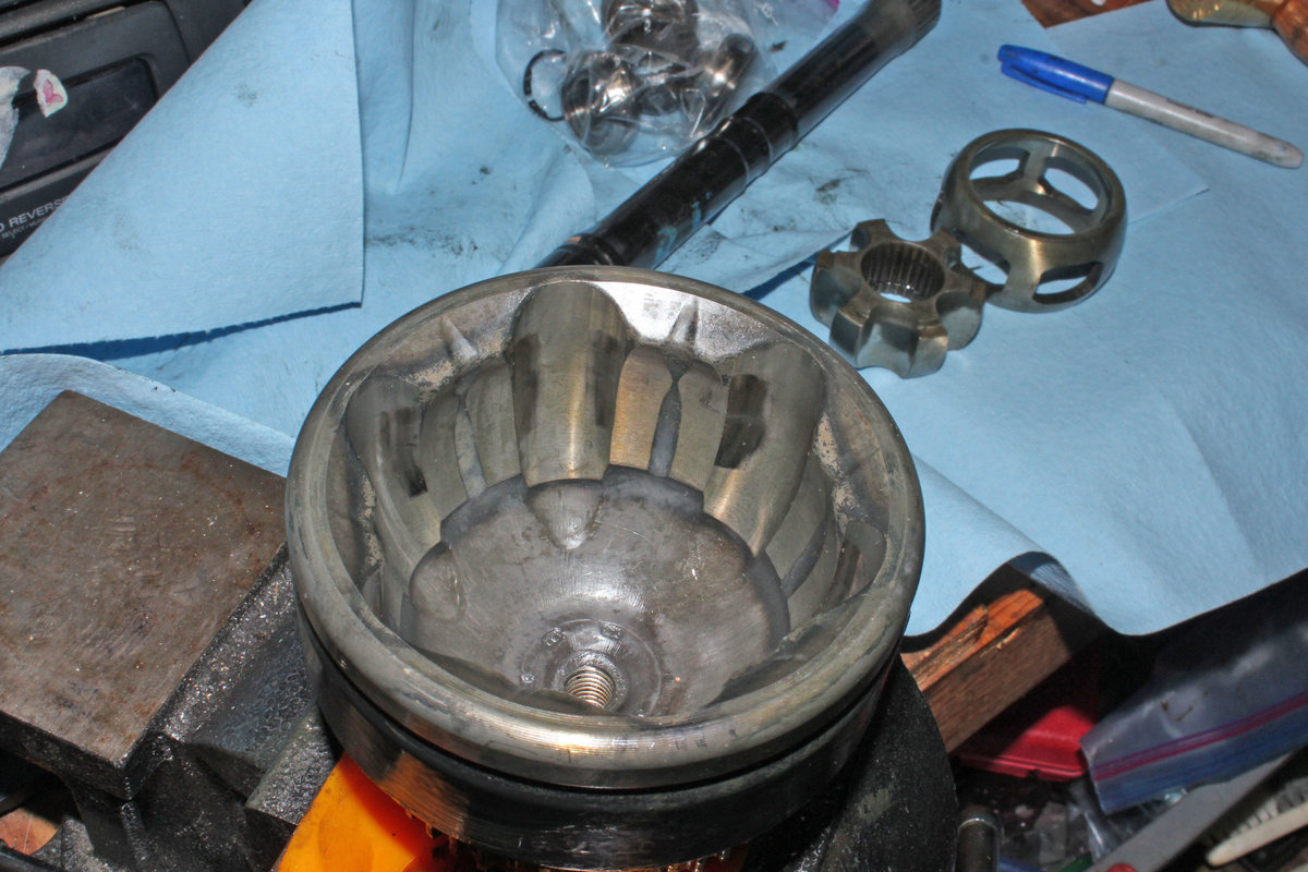

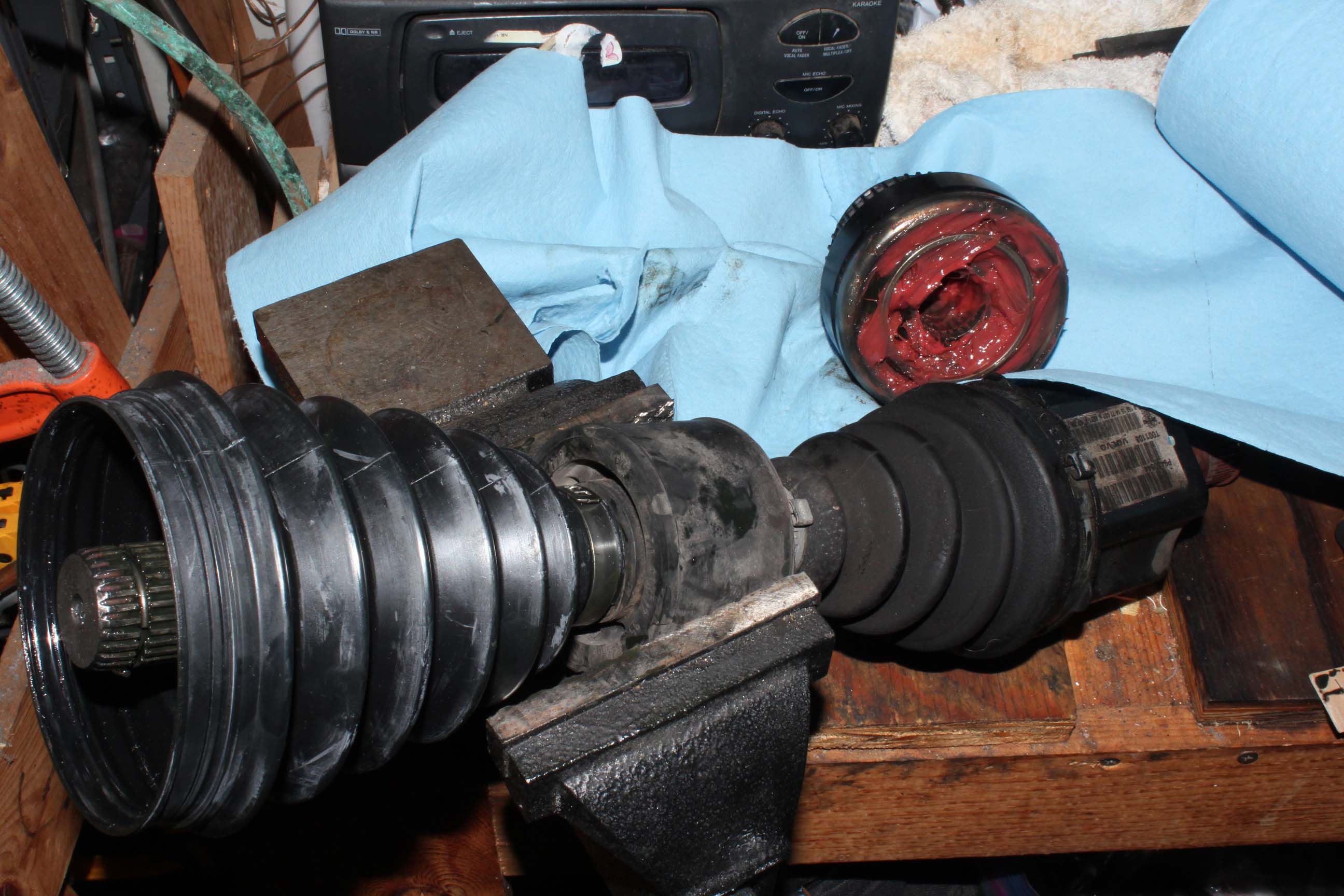

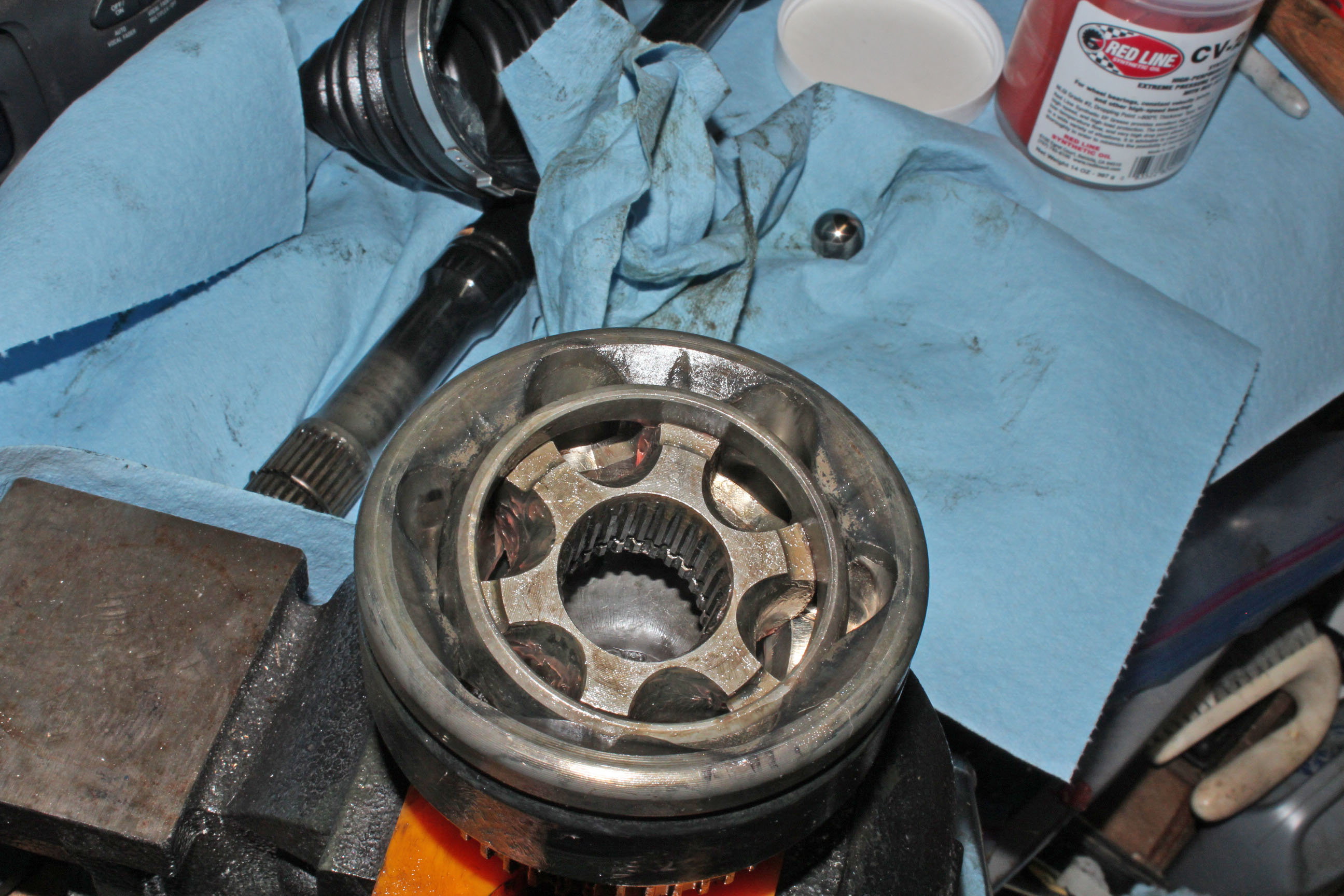

I rebuilt my passenger side outer CV joint a year ago on my 1999 s70.ogatrulle wrote: 18 Feb 2019, 18:31 06 V70 2.5T 130k miles
I apparently nicked the outer cv joint boot when I replaced a hub last month; now it's oozing grease.
VIDA has a whole teardown/rebuild procedure for each CV joint. I understand I have to remove the outer CV joint housing from the splined shaft in order to get the new boot on. Do I need to disassemble the joint further or can I just clean it out with brakleen and regrease?
Is it difficult to tap the outer joint back onto the drive shaft?
While I have the driveshaft out, do I need to secure the inner joint to prevent internal separation?
Thank you for your wisdom!
You can see why I did this here: viewtopic.php?f=1&t=85193&p=470583#p470452
I do not know if my experience will help you at all given mine was a 1999 s70 and your's is a 2006 V70.
But with your VIDA info you should be able to determine if your car uses a similar type of joint.
If my CV joint is similar to yours, then here is my observations.
1) The clip holding my outer CV joint to the shaft can be seen in the third picture on the link above. I had to spread those ear apart and then tap the joint off. I found this easier with a helper. My son held the ears apart while I used a large flat bladed screwdriver and hammer to gently tap the joint off. It came off easily.
2) I think my rebuild it came with a new clip and I seem to remember the joint sliding back on fairly easily once I cleaned the splines. You just have to spread the ears to get the clip to spread wide enough.
3) because my joint was ripped apart, I had to completely disassemble and clean the joint. I practiced putting it back together without grease in it first. It turned out that reassembling it without grease was more difficult (but less messy) than when I did it for real. practicing the reassembly dry felt like I needed an 10 hands because of all the moving parts.

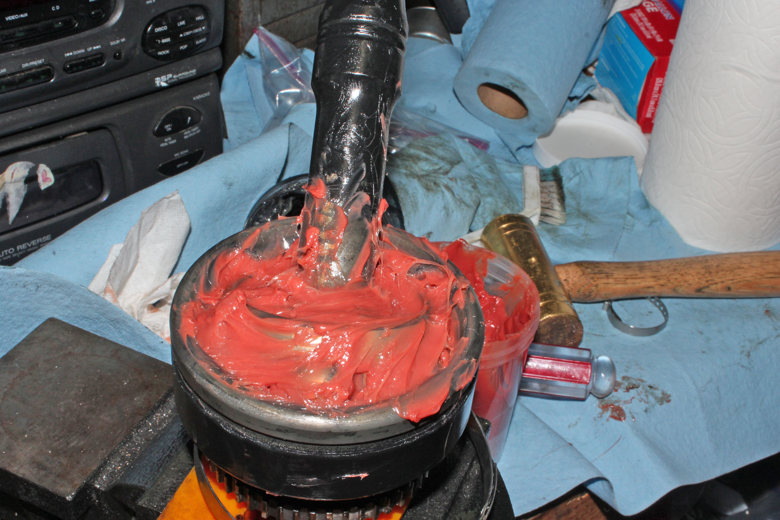

To replace the outer cv joint boot you cut off the old boot, hold the axle in a vise and strike the inner ball race near the axle with a hammer to release it from the circlip (see photo). I used a brass hammer to to knock the outer cv joint inner race off the axle. The inner tripod joint is staked (see photo) and will not come apart unless the small ridges have been ground off previously, which is unlikely if the axles has never been apart. If you caught the bad boot early and it's not contaminated with dirt you should be able just clean, repack and install a new boot. Before you knock the outer cv joint off the axle clean and mark the inner race location on the axle so you know the depth when it's reinstalled.ogatrulle wrote: 18 Feb 2019, 18:31 06 V70 2.5T 130k miles
