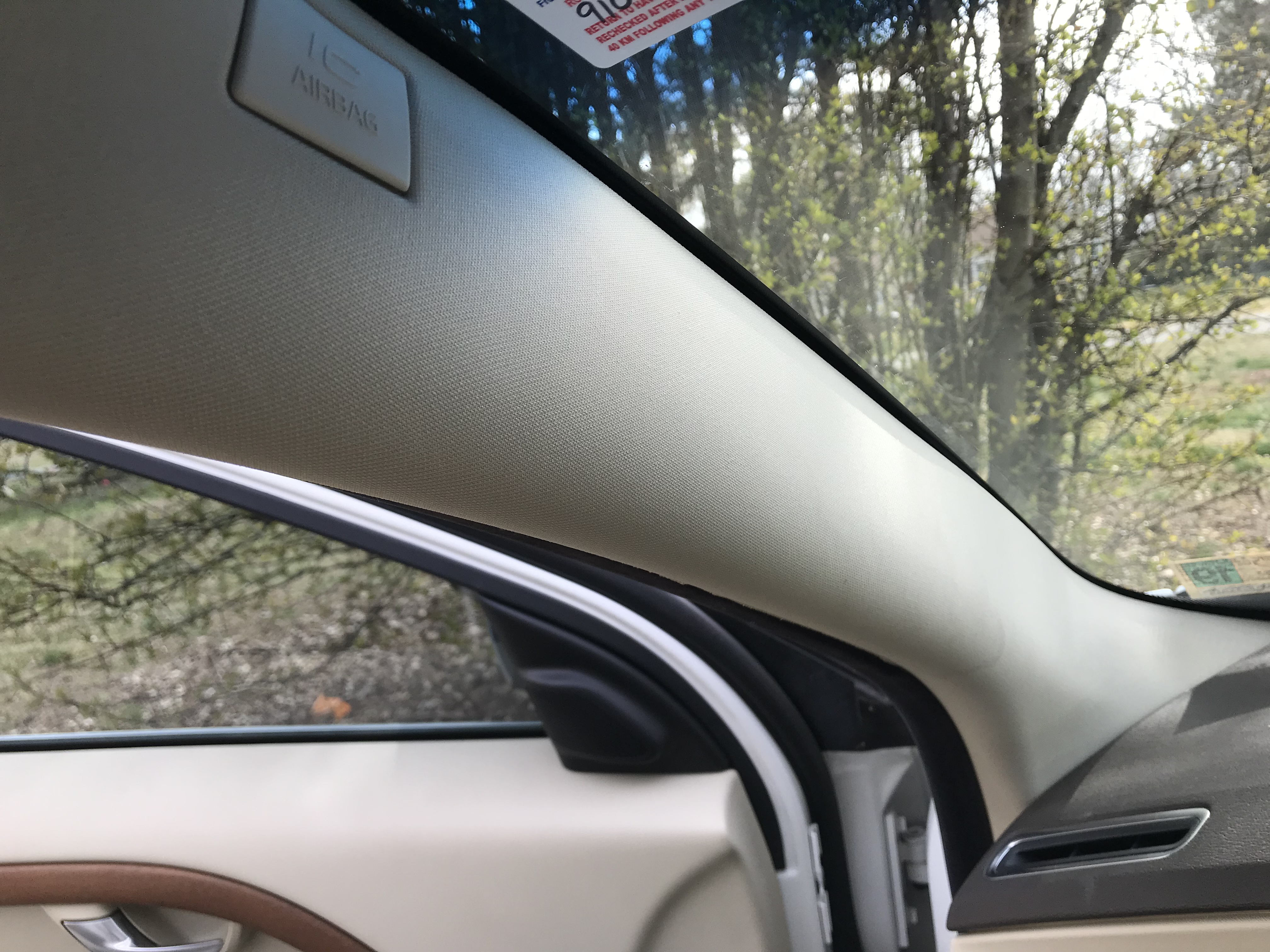

I’ve been finding that my driver’s side floor is constantly wet, and that the A-pillar is wet after it rains. I’m assuming this is due to an issue with the sunroof drain tubing.
I’m trying to remove the cover for the A-pillar, but I feel like I’m having to use a lot of force to get it to budge even a little. Most of the resistance seems to be coming from around the airbag port (“IC Airbag”). There is also the airbag that I’m worried I’m going to affect.
Anyone have any ideas? Attached is a picture so you can see what I have.

Thanks. I had seen some of these posts regarding removing the pillar cover on the first generation of S80s. But I’m thinking there might be something different on the second generation.
If you look closely on the picture I posted, you can see some water staining on the pillar cover.

For the P3 gently pull the air bag plate off with a small screwdriver or bone tool. Under that is a very long T30, I think, screw that must be removed. Then pull down the rubber door seal down to the dash and up beyond. Start at the top of the A pillar and pull away from the windshield from the top then you have a pop in pin to release about mid down and then you lift out the a pillar trim from the dash.

On P2 models, there is a plastic pin with a securing strap attaching the pillar to the metal frame. The idea for the strap is to keep the pillar cover trim in place when the curtain airbag deploys, so the trim doesn't flow with force into driver's face. If P3 has the same securing pin, careful to install it properly back in place for safety reasons.
Also, when the drain tubes clog and water overflows the sunroof tray and leaks down the roof liner, most surely the curtain airbag also gets wet. It is good to inspect it as this may happen over several years, so it stays wet long time plus in winter time it freezes up and ice expands and can damage the curtain material. It also takes long time to dry once with the pillar cover removed and it's exposed, mine took over 1 week to dry in summer time.

Thank you, everyone. I actually figured it out myself a while ago. I posted a reply with the solution, but it’s not here anymore. I don’t know what happened to it.
The drain tubes were actually fine. I could only replicate the problem by spraying water on the car with a hose, and the water was coming in from the top left corner of the windshield and dripping down the a-pillar, making it seem like a sunroof drain problem.
