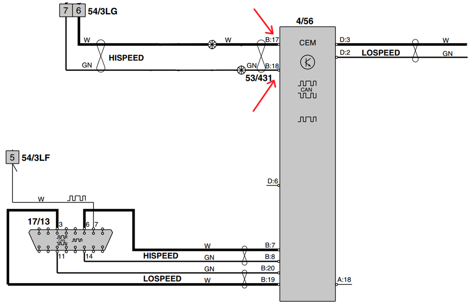

You can't get 60 ohms from OBD connector on 1999-2004 MY cars. There are separated CAN bus segments for that cars. When you connect DiCE and start to read car, same time DiCE send special commands to CEM for turn on relay and connect OBD CAN bus segments to car CAN bus segments. Only after that DiCE can read all modules.

So there must be a hack to tap into the CAN line and view the wave forms. Is it as simple as tapping into the line like I have done at the Infotainment connector, using a USB cable? If so, which wires in the USB cable should I use?

You should to connect to active High speed CAN segment. If you have a "good hands" you can connect directly to wires.
You can find it clothe to CEM connector (B:17 and B:18 contacts).
Look attached image.
