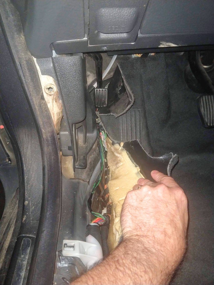

Also, has the truck leaked from the sunroof drain yet? Down on near the floor on drivers side like, 3 inches from door frame is a wire loom, there is one kind of by itself, mine looked fine from outside but was all burnt inside. I was told it had something to do with the fuel tank pressurizer. Anyway I cut the wires back and soldered them. my codes went away.

Thanks, but no sunroof but I did just replace the headliner and everything went well. Replaced the gas cap too. Drives great!!
