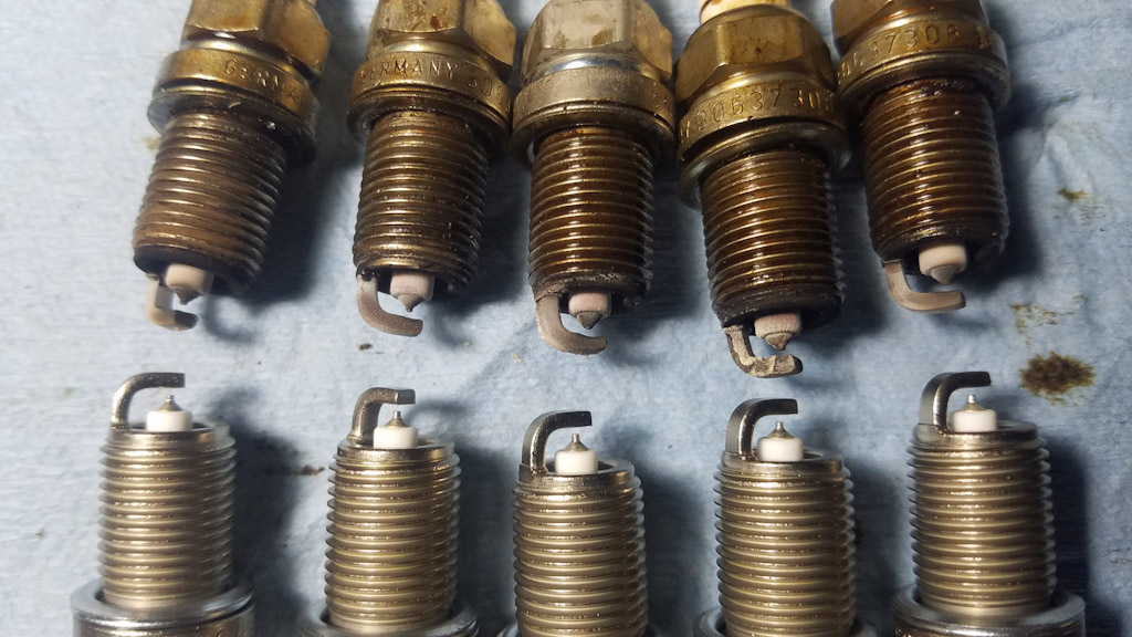

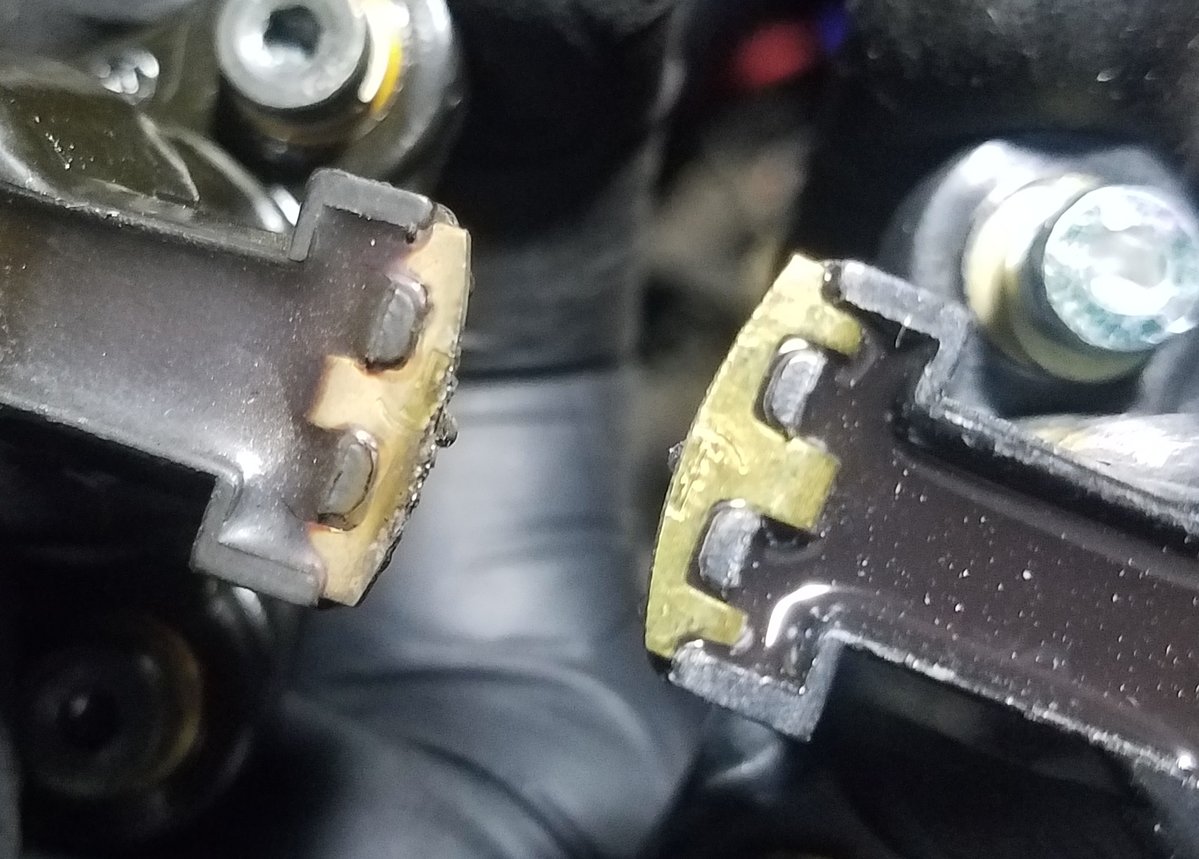

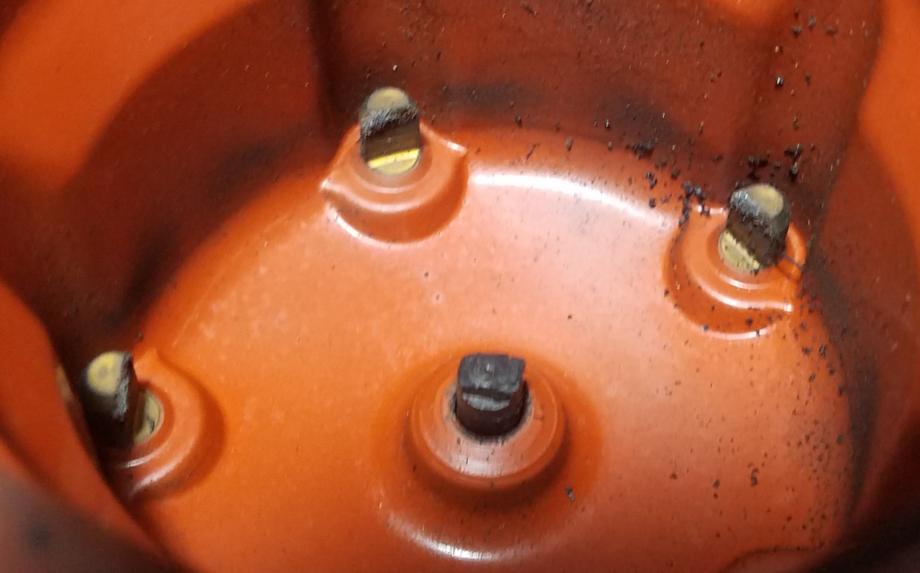

Took another step towards stage 0 with new volvo spark plugs, bougicord wires, Bosch cap and rotor. Doesn't feel much different but I feel better about replacing parts that may be original. I dont have any service history beyond 12 years. Everything looked pretty good, no oil in the cap, no oil in the spark plug wells. Some expected amounts of oil on the top of the engine.

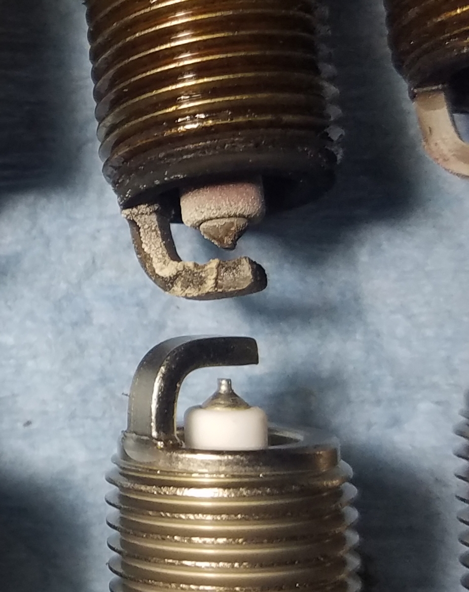

Spark plug #4 had some interesting build up, any thoughts?

Nasty cap and rotor. Ugh.

That was all definitely due for replacement!

Zion, those gaps look fat? For a turbo, get them to O.O28 inches
