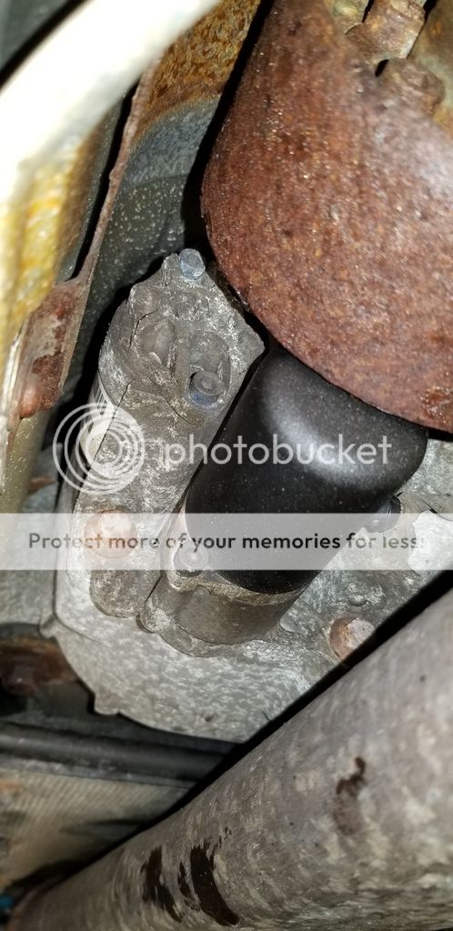

Bumping this thread to see if any active members can explain how to remove the propeller shaft flange? There are 6 large allen bolts that need removal but Metallo couldn't move the shaft more than 1/2" after removing those flange bolts.
In the top right are the prop flange allen bolts I've been PB blasting for weeks.
As noted by VTL only a small percent of Haldex oil can be siphoned out thru the fill plug. The oil pump needs removal to drain all the Haldex oil.
vtl wrote: ↑11 Apr 2017, 19:44 In about two hours after working in a very tight space and handcrafting your own tools you will regret you didn't drop exhaust and prop shaft. Also it's impossible to change all oil without removing the pump. Last time I replaced oil with pump on I was able to evacuate maybe 150 ml. With the pump out it's more like 600-700 ml.
