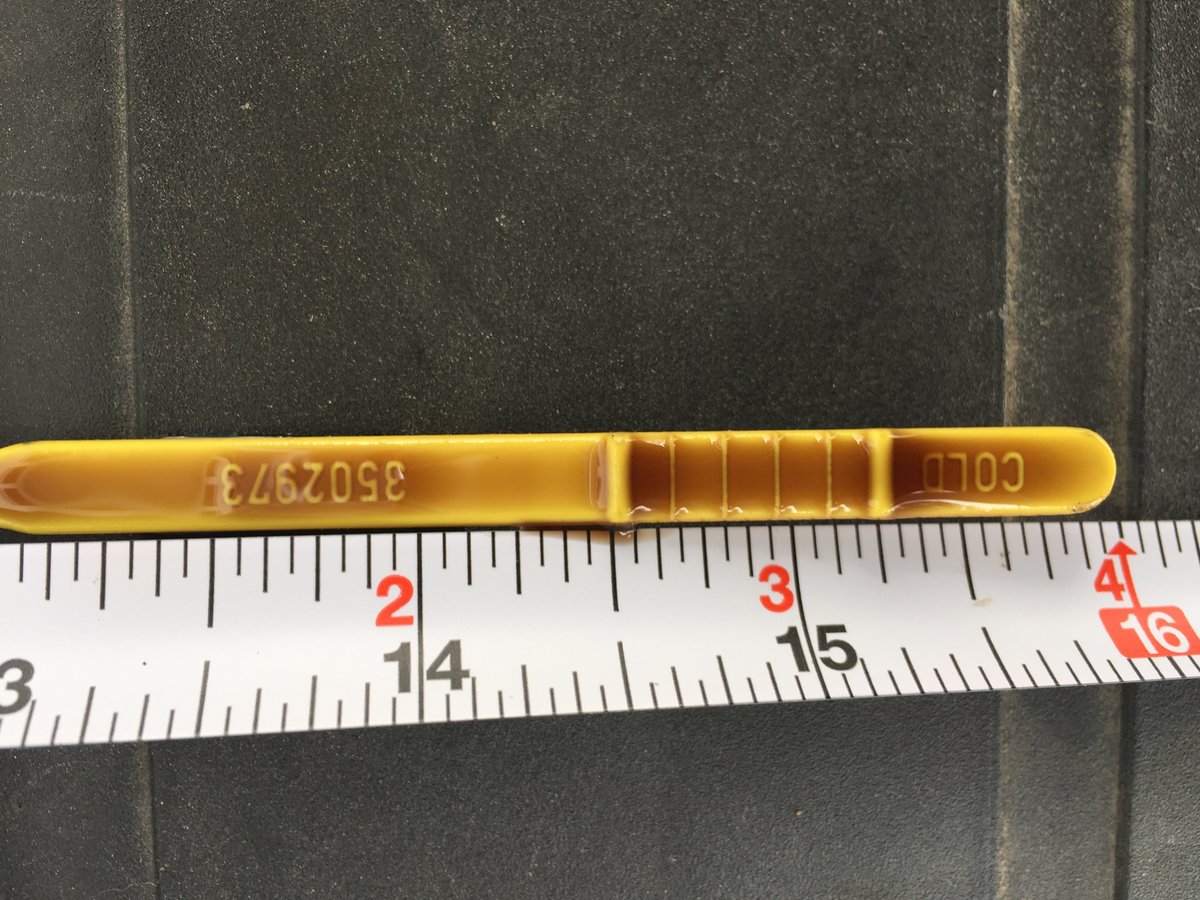

So I recently went it do a drain and fill to find the top of my trans dipstick was broken off. After some fighting I got it out, and idiotically set it on the edge of the bench, it ended up getting snapped and I’m pretty sure I lot a piece, I tried to piece it together but it broke in a few places. I am just trying to figure out the correct length, couldn’t find it in the forums or Haynes book, I think they no longer make them but I ordered a new one anyways, was planning to compare it to the old but that’s no longer possible. I have the end of the stick where I can mark the proper lengths for hot cold, but how long should it be!? Thank you so much. It’s a 98 v70 awd 2.4t auto trans

I bought my first AT Volvo,just so that I could answer this one. I’m away from car until this evening, though,
Stand by,
Stand by,

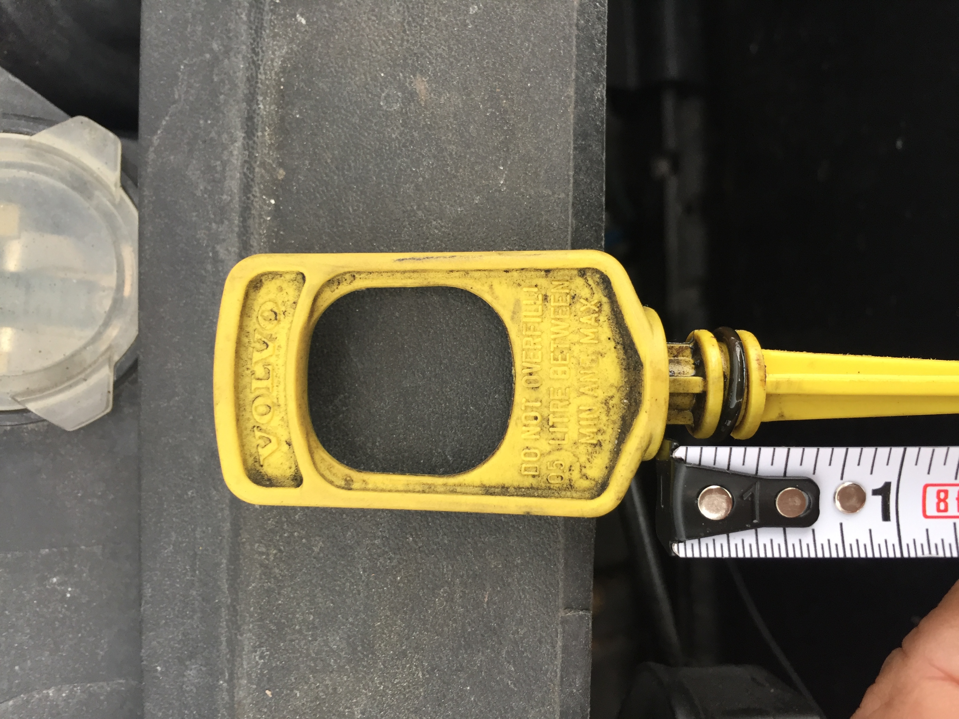

- Posts: 35299
- Has thanked: 1505 times
- Been thanked: 3818 times
Site went down during post.
Here you go
Here you go
