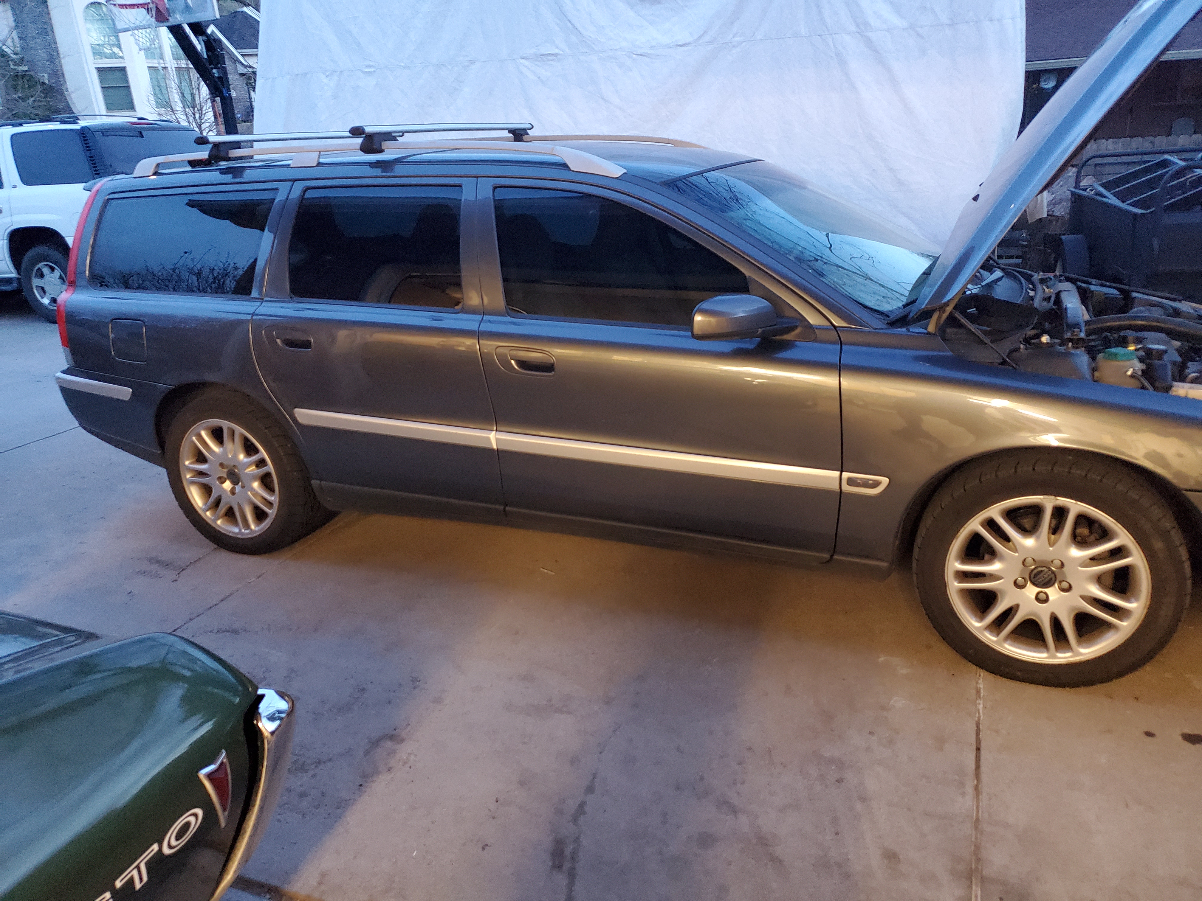

Today while driving at about 10mph I heard a noise. I parked and noticed antifreeze dripping from the cam cover. I picked up my wife, restarted car, car ran ok. Car then died another block down the street and upon quick inspection I determined the belt broke. I'm guessing a potential water pump failure which took the belt with it. The pump belt and tensioner were replaced 50k miles ago.
I'd like to do a leakdown test to see if valves are damaged. How can I properly align the cams so all valves will be closed when testing a particular cylinder? Any tricks to this?
