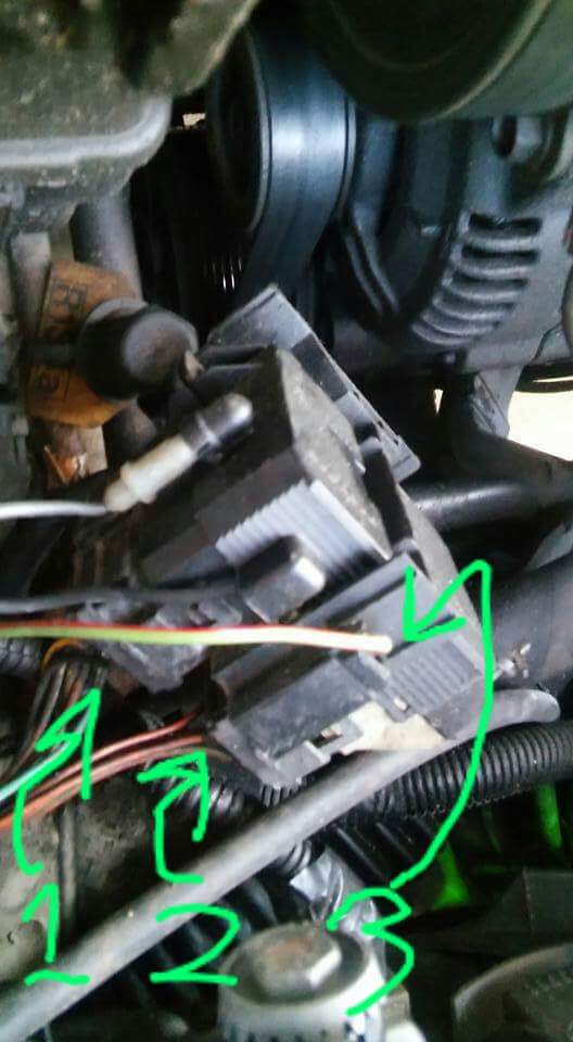

firestarterpro wrote: 11 Mar 2016, 15:50 I lied, there are three. Two big ones at the bottom and one small green one on the side
What is the third wire for? Mine doesn't appear to connect to anything and has plenty of corrosion.
