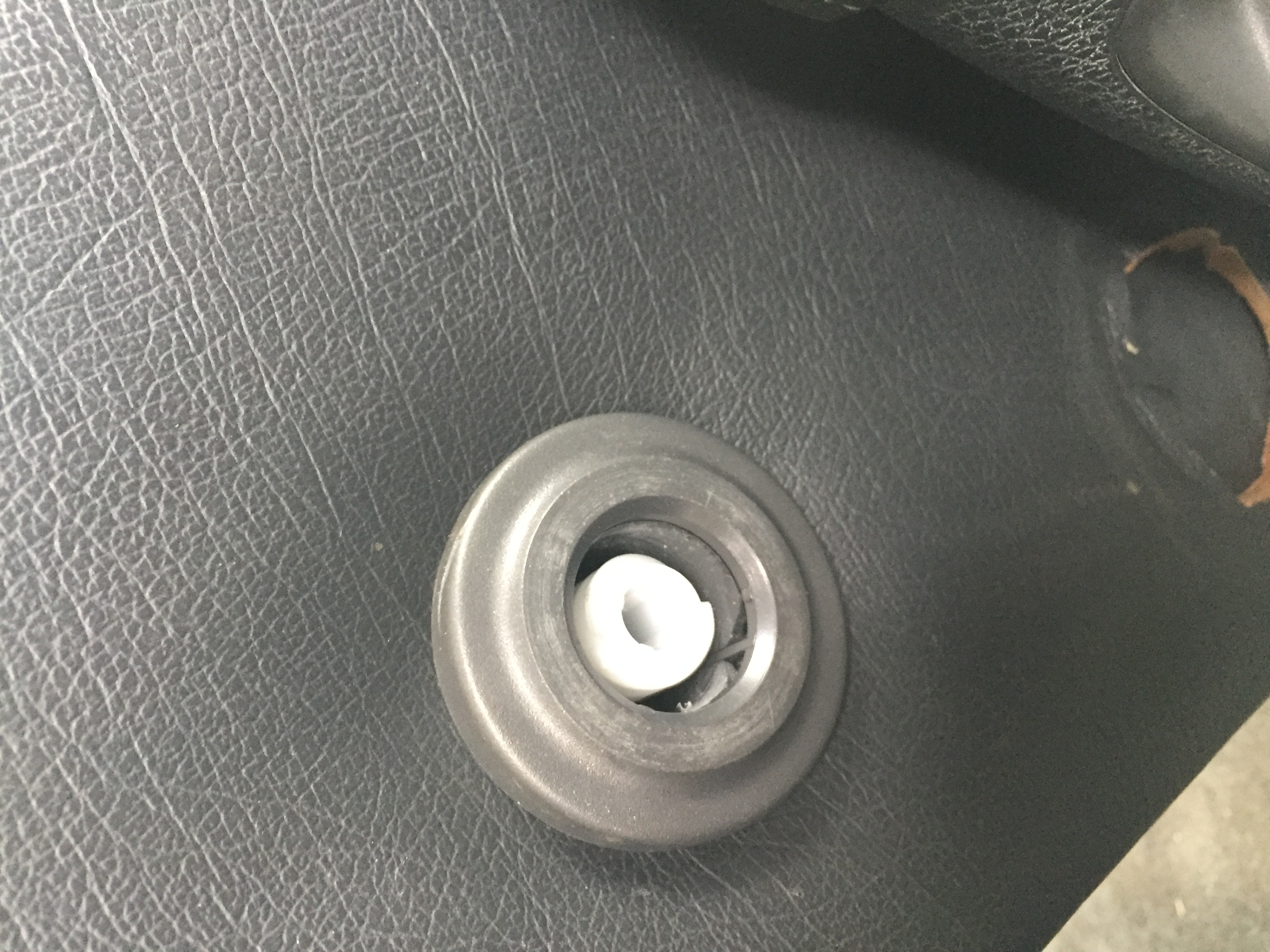

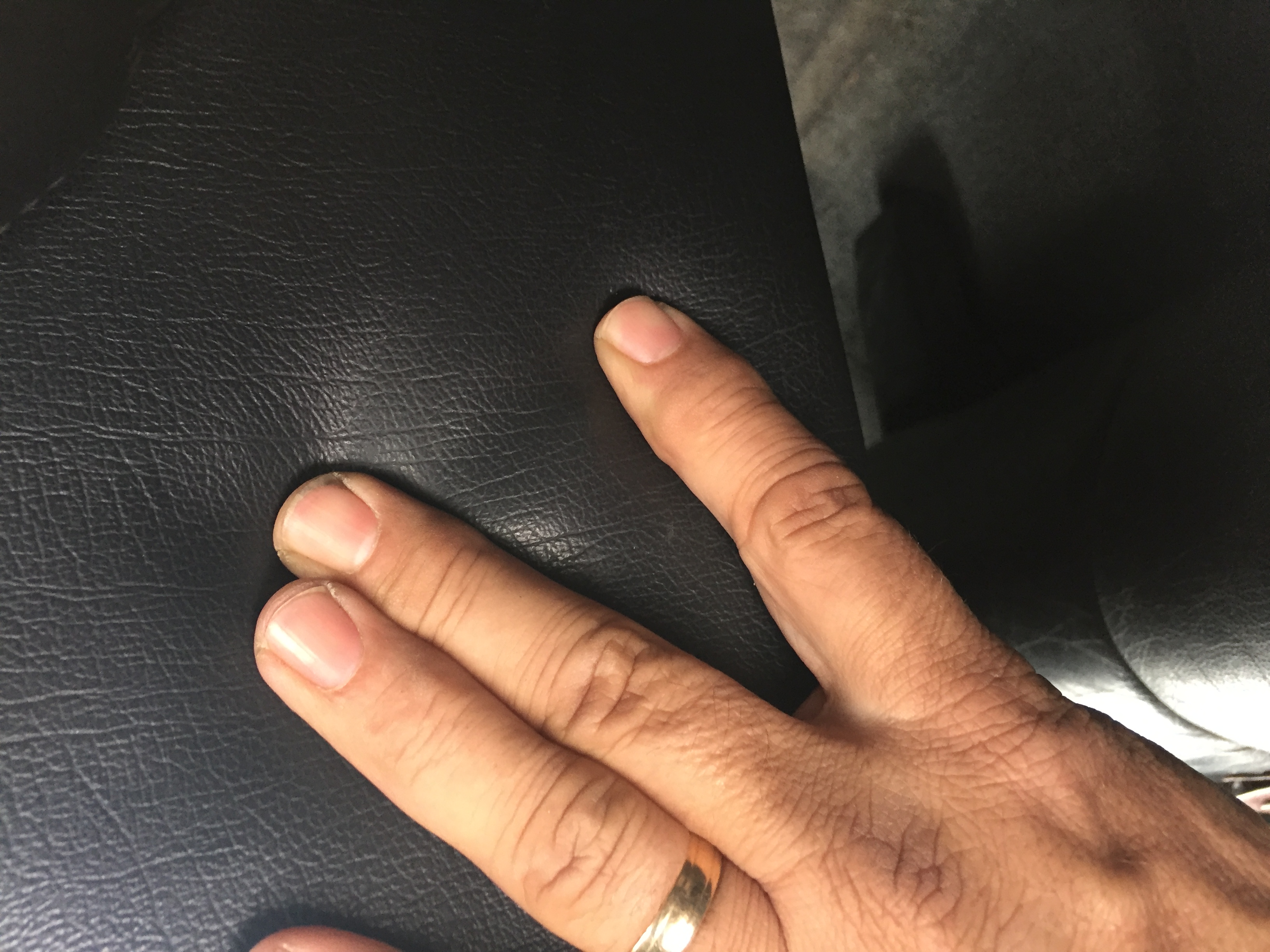

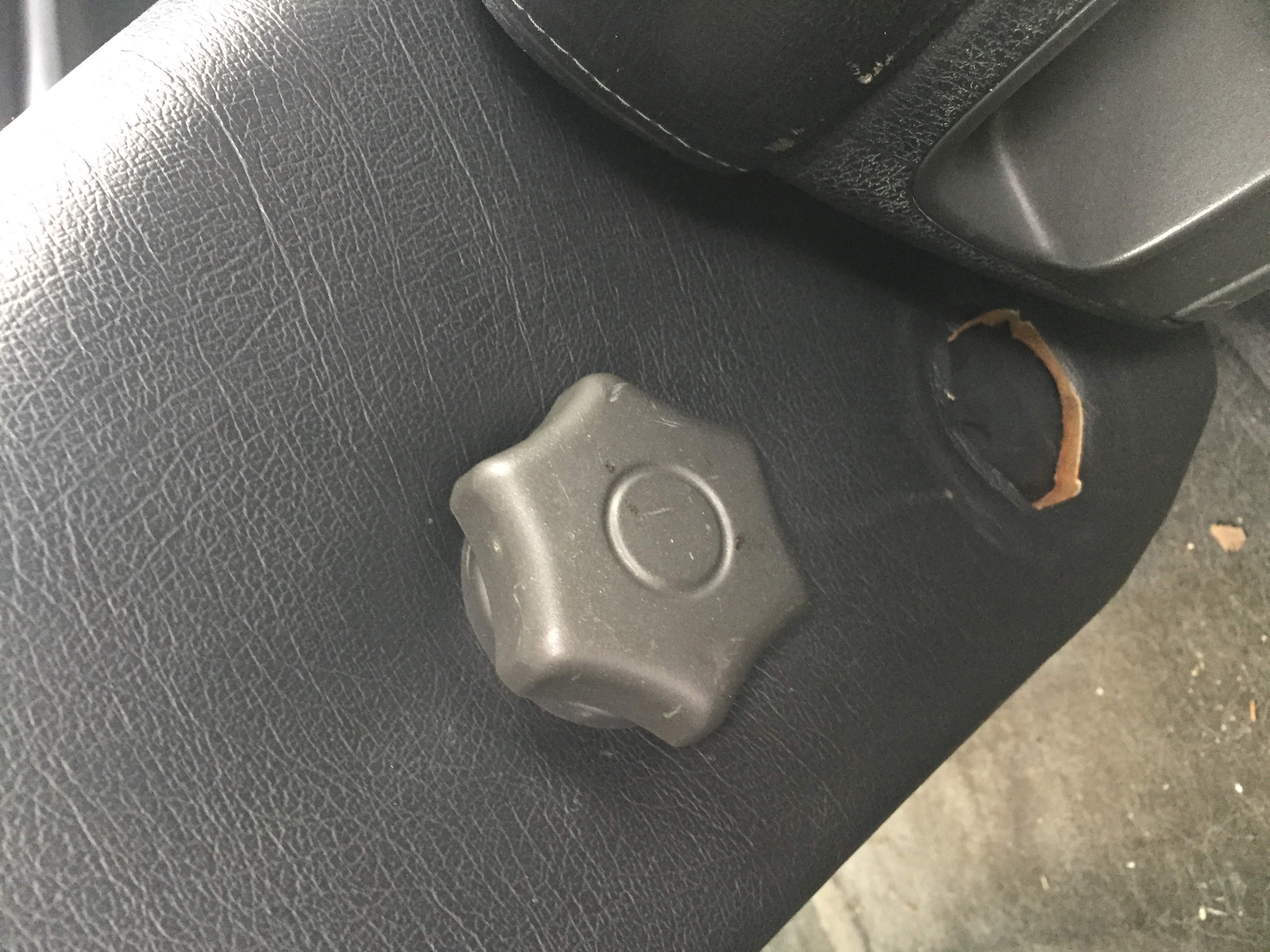

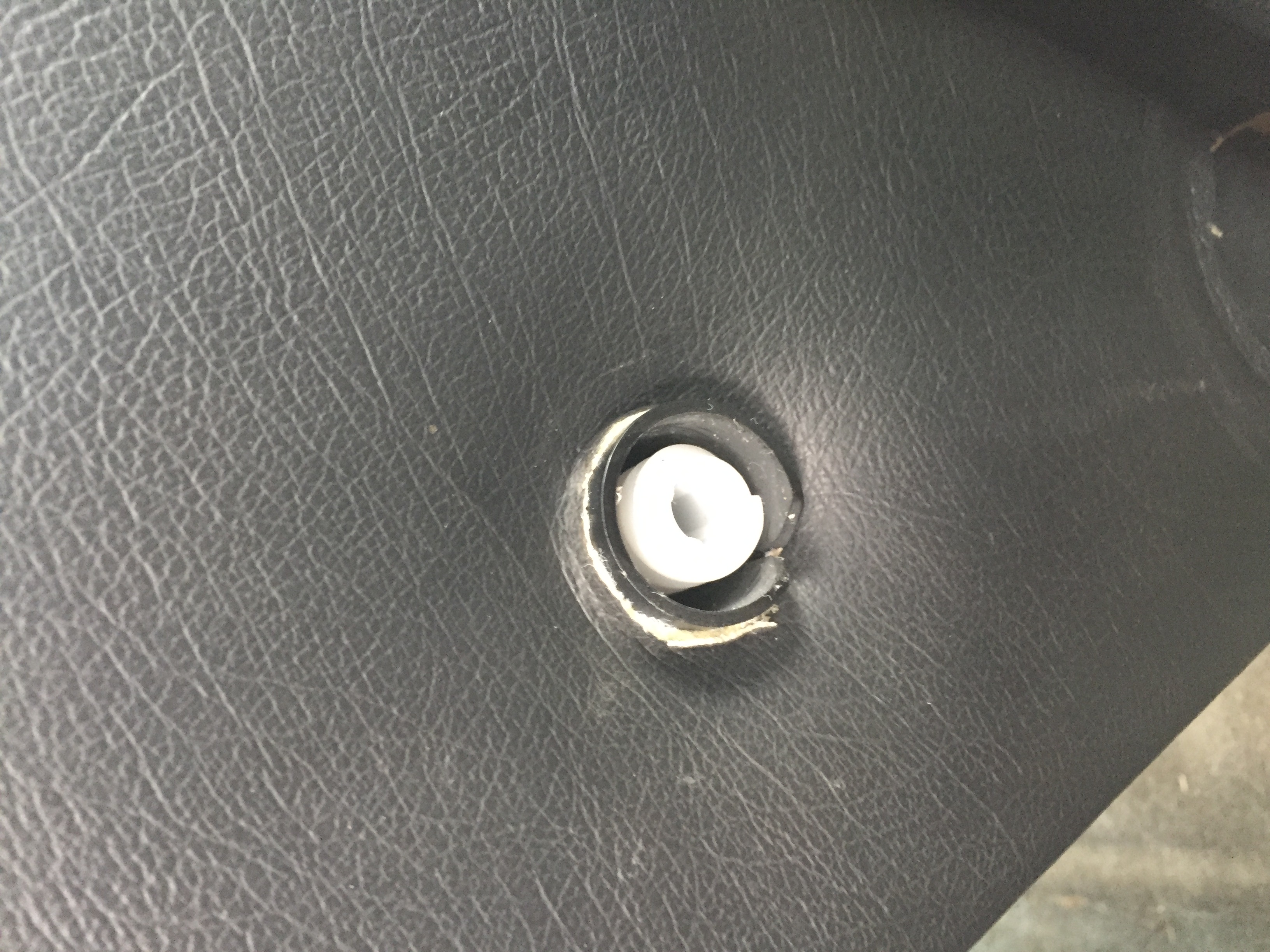

Finally finished this one today while changing oil - about 3 minute job
Find the lumbar knob by feel
Small slice...June can lend you a Phillips screwdriver to punch a hole in that if you like
Stretch Naug over lumbar knob shaft
Outer collar
Thread on knob
