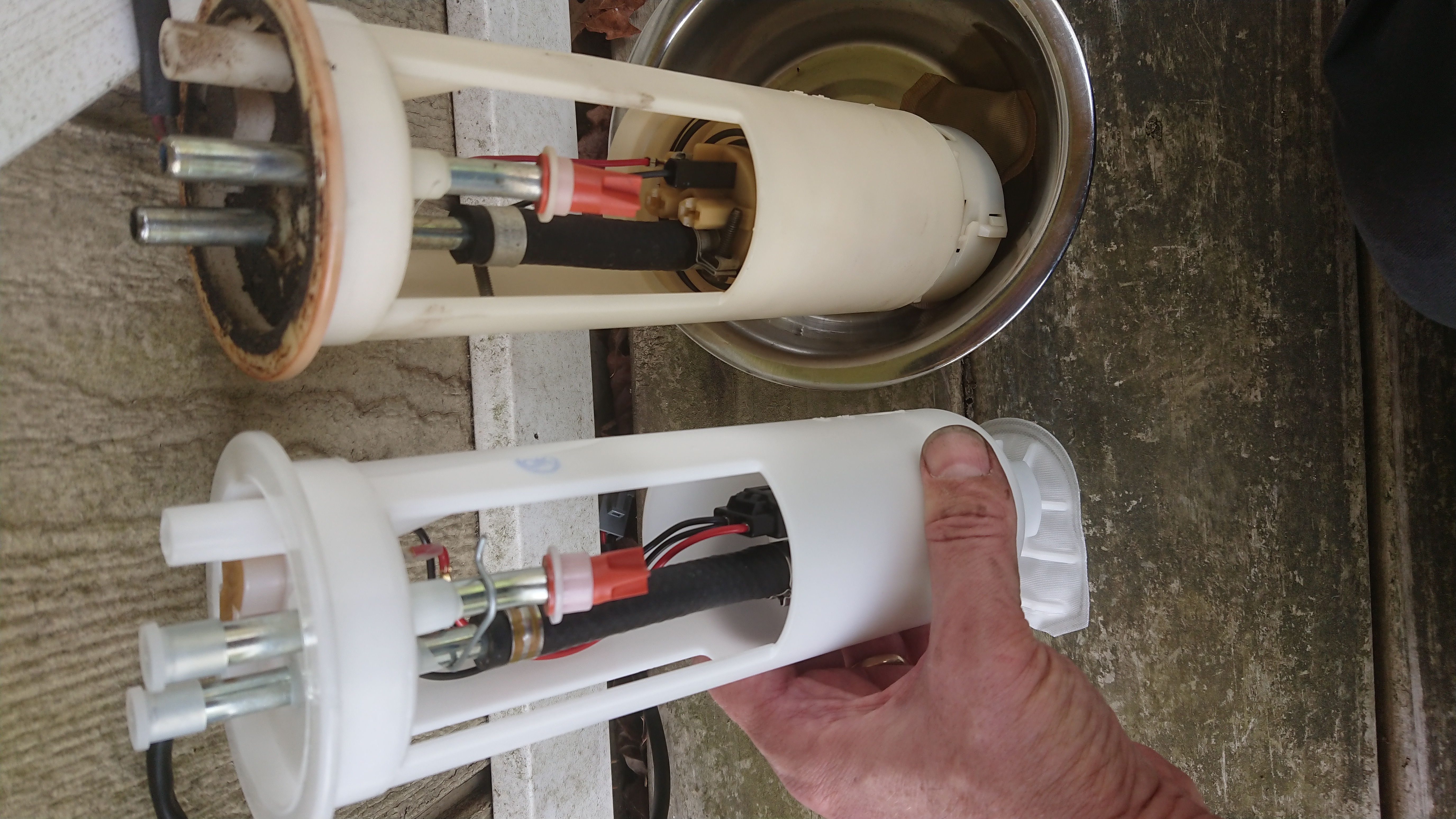

On Friday Eeuroparts really surprised me with a super speedy delivery of my OEM fuel pump, so yesterday I went right to work.
The first thing I noticed was that I was not the first one to be in there, as the cables to the pump were secured by Gorilla tape
The next surprise was the fuel pump that was in there. It looked different than the OEM and it was very dirty up on top.
This looks to me like someone installed an old used aftermarket pump in this car.
The reason why this is intruiging is that the car only has 108k on it now. That means the original pump failed very early. And whoever changed it didn't use an OEM one and possibly not a new one.
Here is old and new side by side. Doesn't really matter, the 850 is running again, yay!

I think people run these pumps down to the idiot man light coming on - and that's the reason for early demise.
Im on my original pump and relay at 230k
