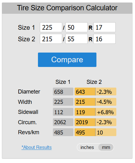

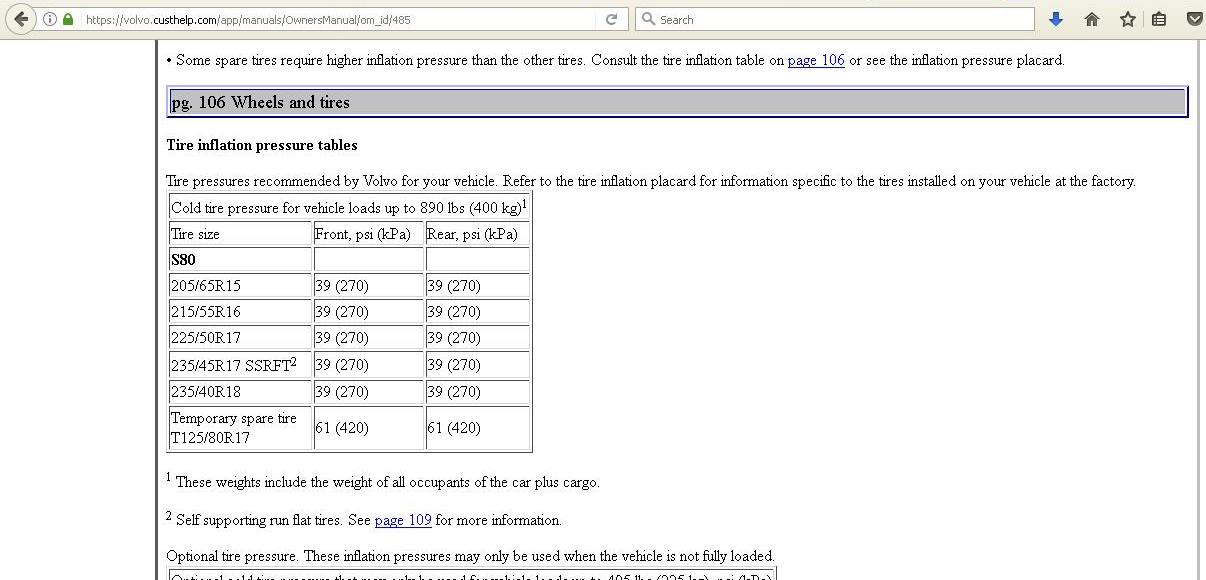

Post by precopster »
Tire diameter of a 215/55/16 is 643mm and is correct size for a 2004 S80
Tire diameter of a 225/50/17 is 647mm and is approximately 0.62% larger
Both sizes are in the 2006 owner's manual so should be OK for the 2004 if brake size is not an issue
RickHaleParker
Posts: 7129
Joined: 25 May 2015
Location: Kansas
Has thanked: 8 times
Been thanked: 958 times
Post by RickHaleParker »
Tire circumference is -2.3% shorter. The speedometer would be off -2.3%.
Unless the ECM was re-calibrated to the new tire size.
At a indicated speed of 70 MPH. The car would be moving 70 mph * .977 = 68.39 mph.
Looking through the dimension. If you have a rubbing problems, it is most likely the offset of the rims.
