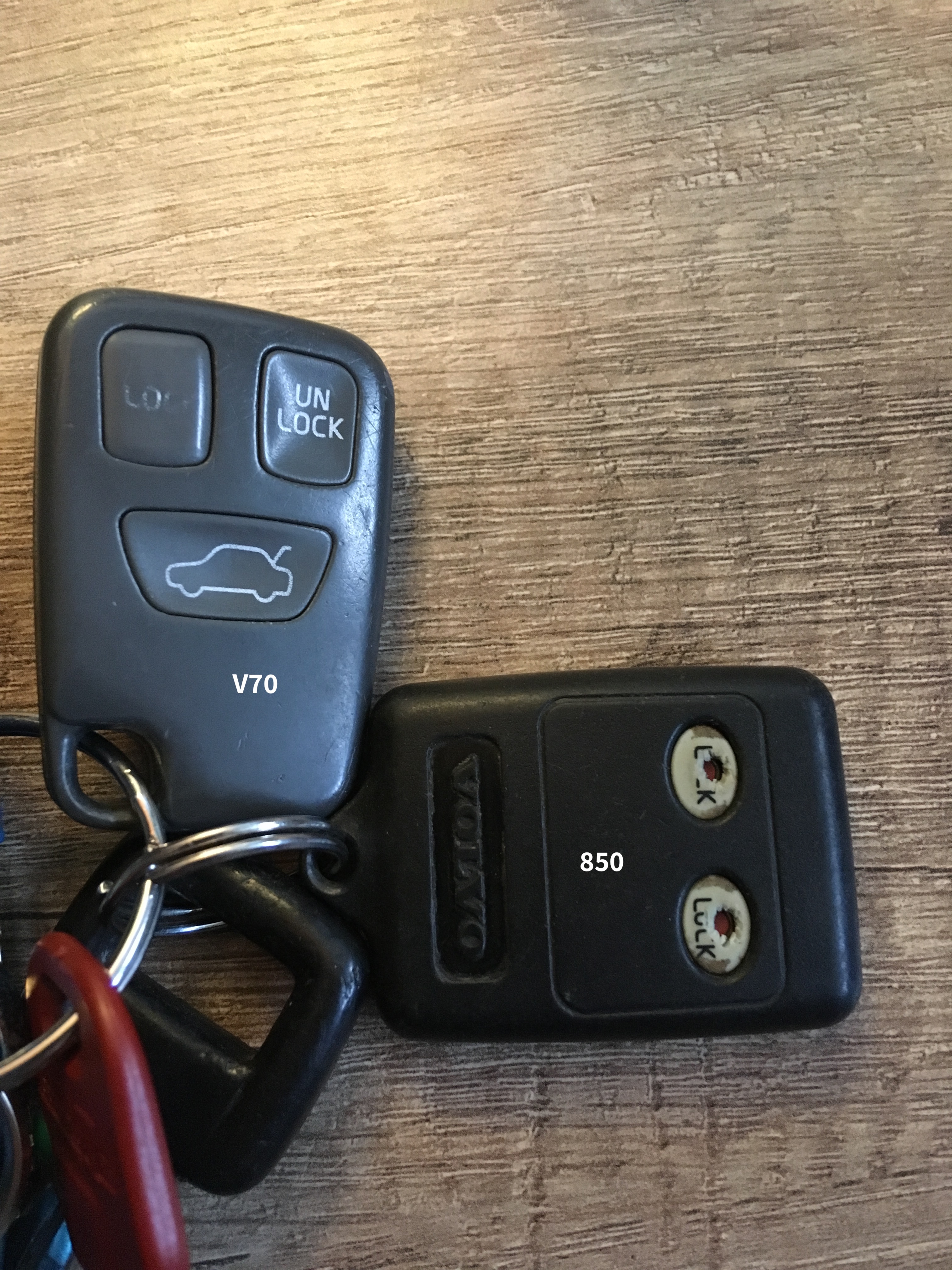

If the security set ups across the pond are anything like
the ones in US spec P80's, you have two very different
systems between late MY 850's and the '98 70 series cars.
Can you post pics of the two fobs?

Older one 433.93MHz is made by TRW with specified temperatures -20C to 50C
Newer is 418MHz - by some AFL/Stribel Gmbh and specified operating temperatures -10C (14F) to 70C (158F)
Edit: Older one i mean buttons are aligned in horizontal.
Newer one has vertical alignment and larger buttons.

BEJinFbk wrote: 08 May 2019, 19:26 If the security set ups across the pond are anything like
Hy buddies,
Here they are. And thanks so much for sharing yours knowledges.
