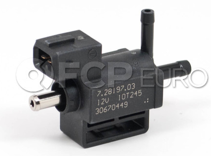

Reviving an old (but good) post on TCV/BCS solenoid compatibility... The part listed above (Pierburg Volvo PN 9465528) isn't available from my favorite parts store (FCP https://www.fcpeuro.com/products/volvo- ... o-30670449). They have the newer version for the 2004-2007 V70. Has anybody had experience good or bad with installing this one in a 850? Thanks! :D
Pierburg BCS/TCV for Volvo 2004-2007
Screen Shot 2019-05-18 at 7.51.28 AM.png (118.74 KiB) Viewed 1548 times

I just got that one straight from the dealership as a replacement for my iPD HD one, which I managed to mangle... :P
Works great - I’d say it feels even sharper than the iPD unit. Pop it in there. :)

I actually ended up using the AC Delco unit, found one, and a pigtail, inexpensively, works fine. Search ac delco tcv and Volvo 850 it pops up. But the Pierburg (updated one) looks like a great solution as well, probably the simplest one. I wouldn't hesitate to do this simple upgrade if you suspect your old unit is on the weak side.

The AC Delco aren't readily available in europe (at least when I tried to find them). The Pierburg are also used by a range of other european manufactuerers.
@jreed I guess you can use the even newer parts, (it looks exactly the same as the one I used) - I think als long as they have 3 ports they most likely will work.

I was in the junkyard a couple weeks ago and found a valve like the one shown above on a '98 V70 turbo. Once my old style valve starts failing or slowing down, I'll likely put in the newer one.
