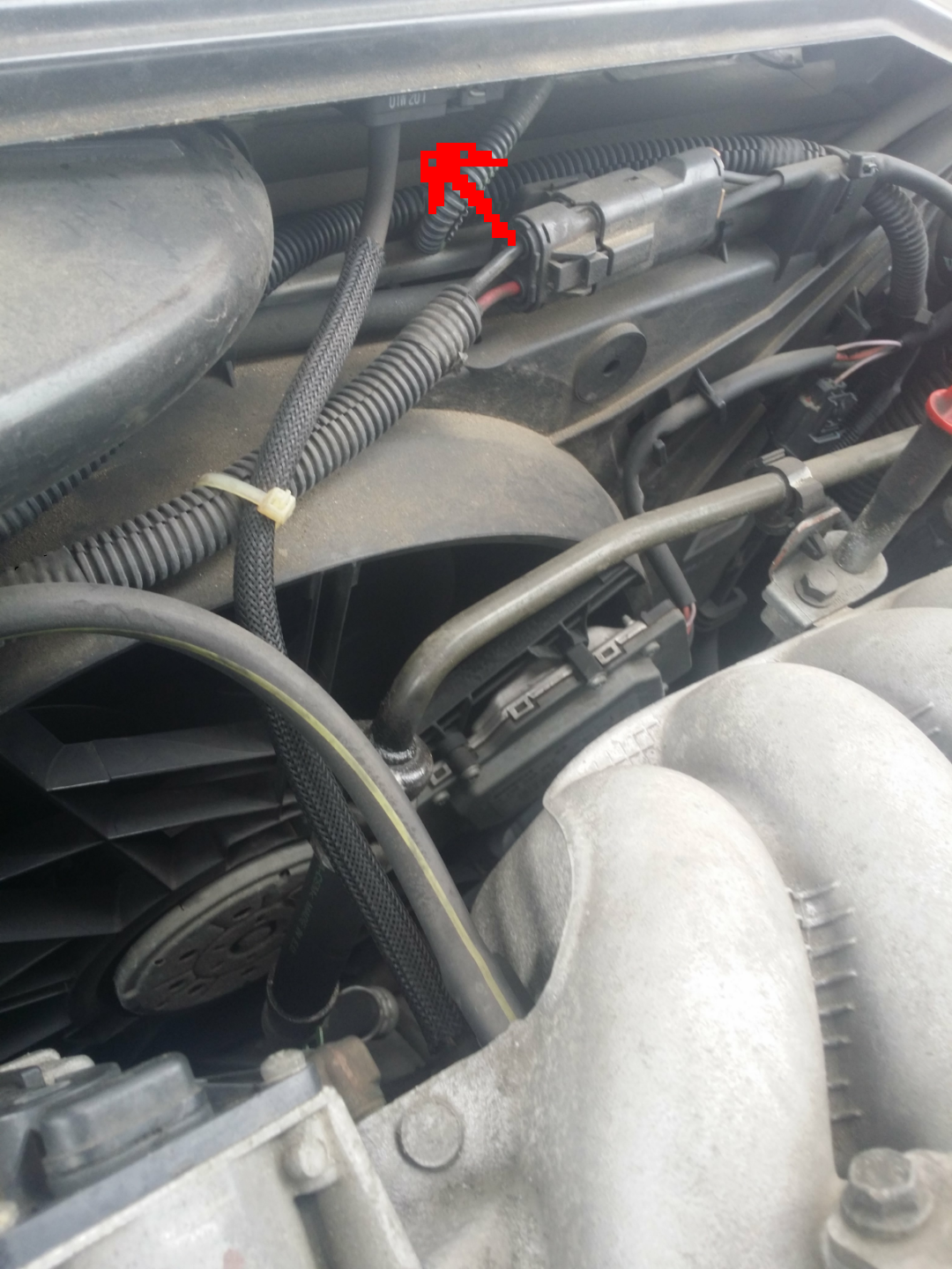

For the location of the MAP sensor see attached image (02 V70 NA). You can check the MAP in VIDA. Look for atmospheric pressure when engine is off and expected changes when throttle changes.
But it seems likely that you introduced the probIem during repair. I suggest to check wiring and also hoses of everything you moved. The hose to the MAP sensor was quite brittle on mine and needed replacement. Sensors seem to fail very rarely though from what I read.

I did check the MAP sensor and I fund it was disconected from the manifold. So it read the atmospheric pressure. After reconecting it is good.
Interesting is that vida was indicating the MAF sensor.
