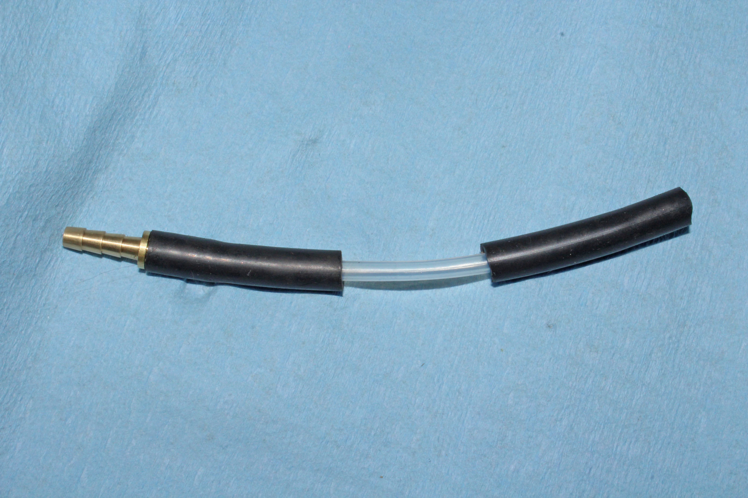

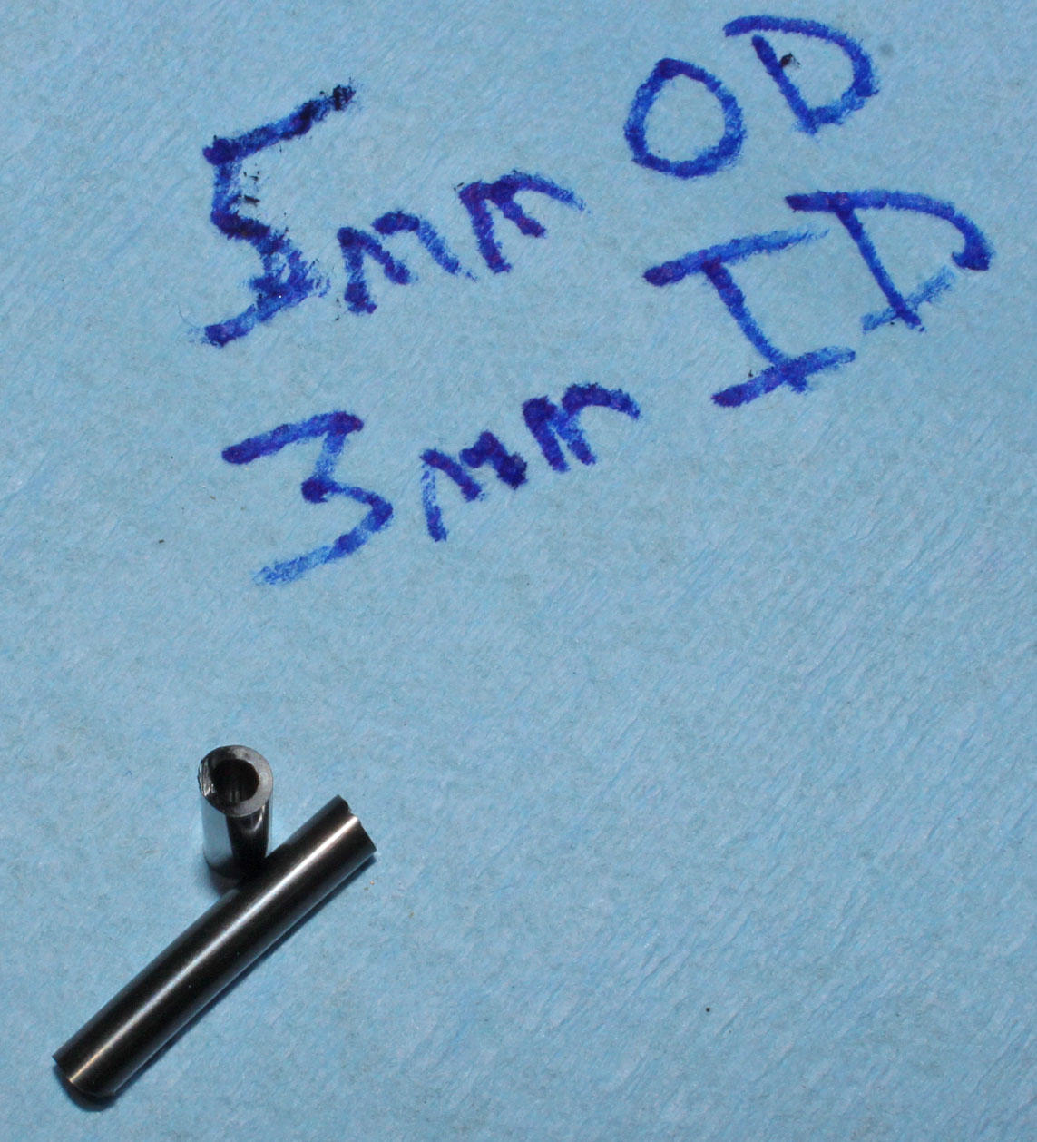

I have a 2001 V70 and I recently replaced this hose, the old one I took off was 3mm ID and 5mm OD. To replaced it I purchased a PFA hose from Mcmaster Carr with the same dimensions. I think it would be best to use the Volvo hose and banjo fitting or replace with a high temp, high chemical resistant, hard plastic type hose of the same dimensions since, in my opinion, the small ID of the hose helps create a restriction between the manifold under boost conditions and the crankcase. Would also highly recommend using the latest rev banjo bolt, which has a check valve and a better design than previous versions. 31325709
