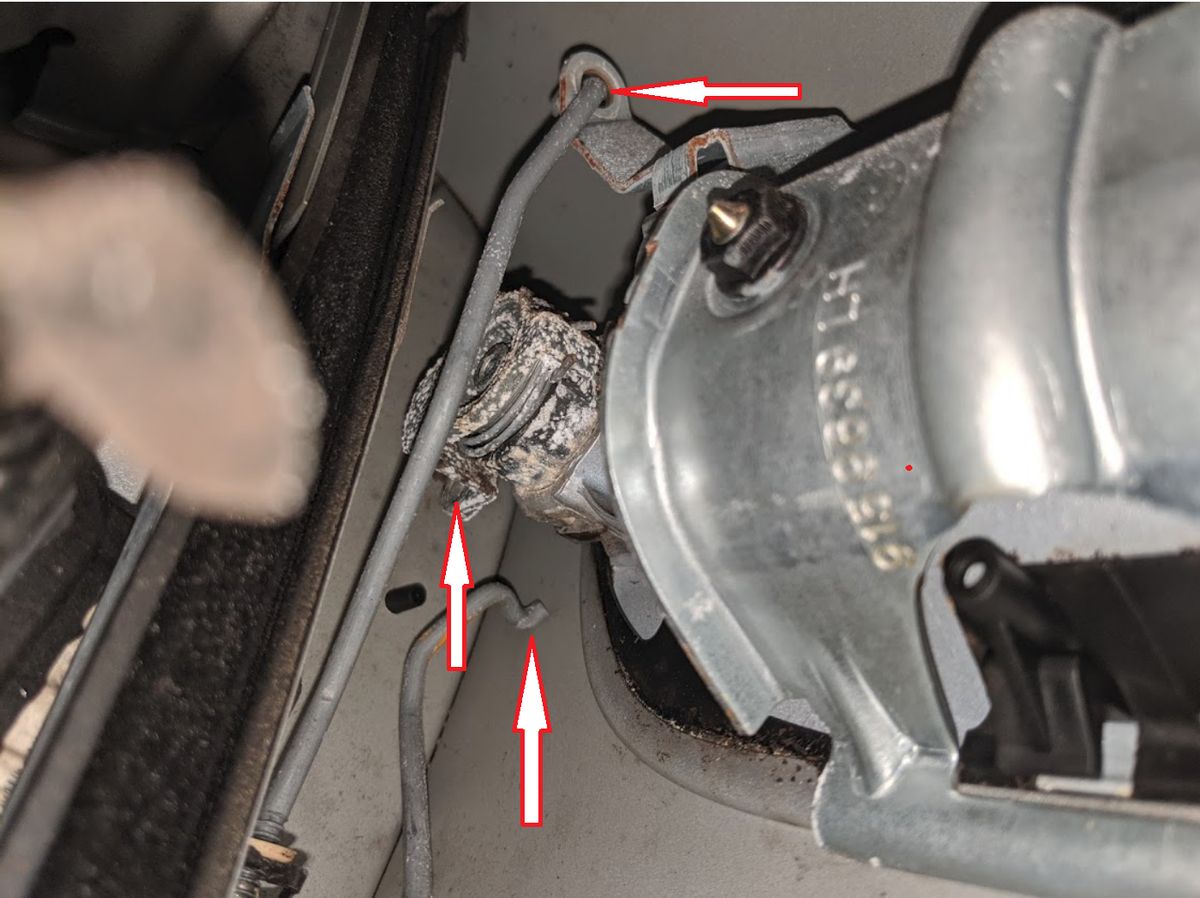

chris11211 wrote: 28 May 2019, 23:31
Should I go to the stealership and see if they can give me a little plastic piece?
Is the piece somewhere down in the door abyss? Unless someone has worked on it previously it should of just fell off.

Scroll through to see if you recognize your part. At least if you call the dealer they can pull something up to check if they only carry that piece. There are a few more websites like this.
https://parts.volvocarslisle.com/produc ... oor%20lock

Post by MoVolvos »
See Also (EDIT Below)
Missing Bushing
https://parts.volvocarslisle.com/p/Volv ... 50337.html
While the unhinged hook goes into the hole with the arrow.
(EDIT)
Part Number 16 is the hook and should go into that hole. A little hard to tell but I think that's it.
https://parts.volvocarslisle.com/a/Volv ... 77502.html

MoVolvos wrote: 29 May 2019, 00:22
Yeah it'd down there. what do you want me to do with it? Glue it on?

chris11211 wrote: 29 May 2019, 00:47
If you don't have time to pick one up ($2~3) and if it's not too broken up or worn you can try gluing it. Need to clean it well with alcohol (90% plus is best) and make sure it's completely dry before applying some kind of exterior glue.

UPDATE!!!
I just bought and put in two bushings for the holes and installed it just now. Door works 100% and it only cost almost 2 bucks a piece. THANKS!!!!
