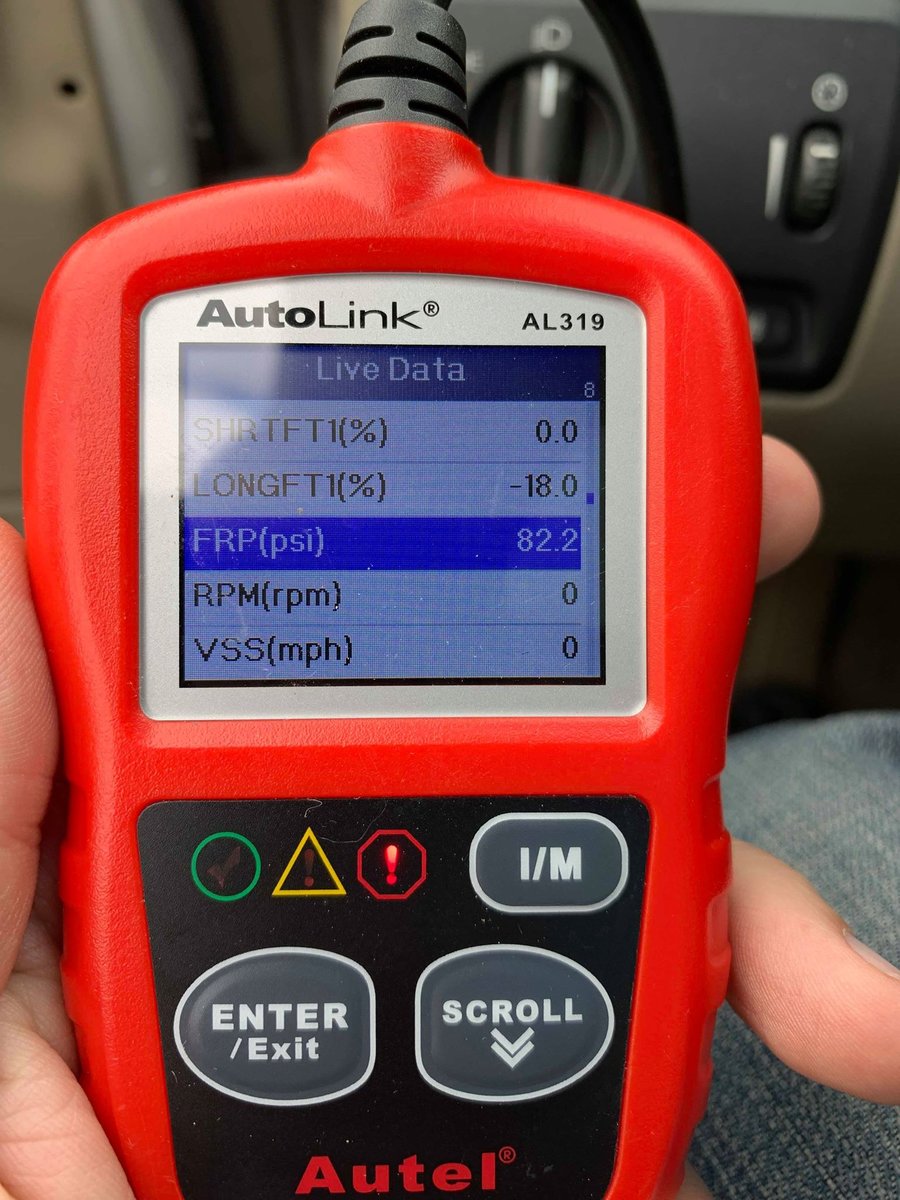

My car is getting a P2188 running rich code for sometime. Can't seem to find out the cause. I suspect it is a leaky injector. My car will start hard and surge a bit until it levels out. Once it levels out, the ]the car will consistently have 57 psi of fuel rail pressure, according to my scanner. However, I notice when I cut off the engine, it jumps up to about 80 psi, and over about a 30 minute period is will drop down to about 60 psi. Is this normal? I imagine the higher psi is causing the injector to leak, leading to the hard starting and rich condition, so perhaps an injector(s) needs to be replaced.
How about the higher fuel pressure, is it suppose to shoot up that high after the engine is turned off? I would like to know before I go looking to replace the injector, if I could remedy it by looking elsewhere. The car runs fine otherwise, its only during start up that it surges and "hiccups". Any help would be greatly appreciated.

Attached is an image of my scanner immediately after I turned off the engine, you can see the fuel pressure jump up to the 80s.

55psi is about normal for the turbo engine
The 80psi spike may be form the PEM (google). Can grab a used one off Ebay for cheap from any year, no programming (all volvo had the same, just different brackets , even the S40 had the same) . Look from a recent car, without corrosion
I'd start with that. Be aware of mechanics who want to replace the pump

Get a fuel pressure gauge in to the fitting and make a direct measurement of the pressure rather than through OBD.

Hooked it up to the fuel pressure gauge, and it was actually read low pressure at the rail (7 PSI). My mechanic thought this was from a failing pump. Do you still think this is the PEM?oragex wrote: 25 May 2019, 19:11 55psi is about normal for the turbo engine
- Posts: 36148
If your mechanic doesn’t know how to look at the waveforms from the PEM, you are paying for guesswork
Try a used PEM FOR $15

It seems to be fluctuating a bit between 2.25 - 3.25 g/s at Idle. What should it be at?

Really? Even though I am not receiving any codes for the MAF? First, P2188 (running rich) sets, and then P2178 (running lean) shortly thereafter. I hope that is the case, because I am not receiving any codes for a fuel pump.vtl wrote: 29 May 2019, 17:50 12-14 kg/h (3.8 g/s). 3.25 is exactly 18% less than 3.8, your LTFT is -18%. Replace MAF, it is common to fail at this age.
- Posts: 36148
Try the PEM first. The definitive way I see to check fuel pressure with a gauge. I don’t like that reading of 7 psi though, I don’t think the car will run at that low pressure?
