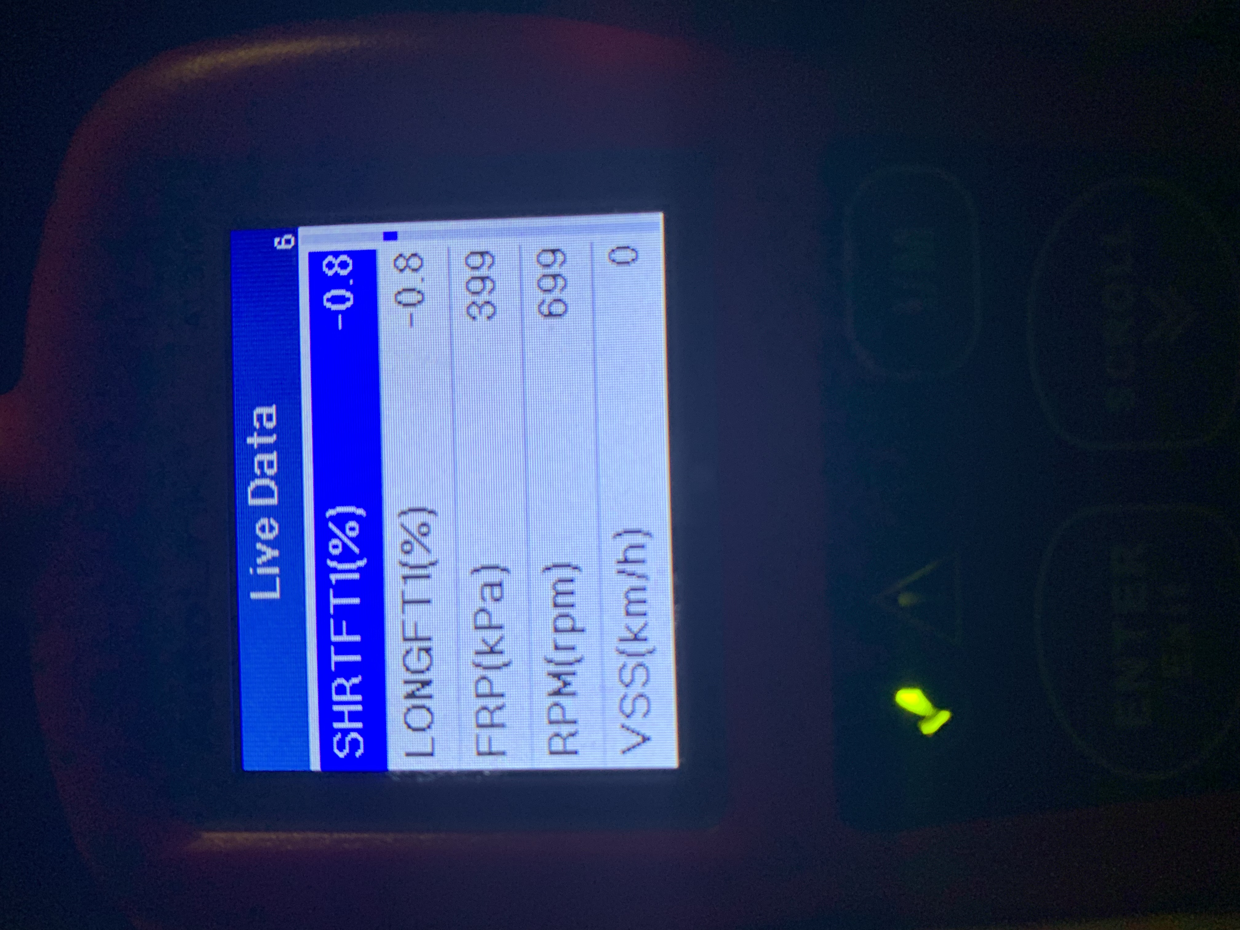

I gotta say, the fuel trim is looking much better and the green check mark light came on on my scanner for the first time. Don’t want to breath a sigh of relief just yet, it seems the engine almost wants to surge on startup still, but it doesn’t. I’m hoping the the new MAF sensor is reprogramming the computer, and will continue to improve with more cold starts, as it seems to be doing. We will see. But much better so far.
See below. Photo of the scan tool at idle just after I parked the car after driving an hour 40 miles on highway and backgrounds to work.

Look perfect. Trim adaptations will float a bit due to EVAP system purging the air from fuel tank, but that's normal for US/Canada vehicles.
