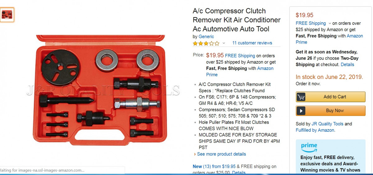

I bought this tool (see photo) but have not used it yet.
I think if you angle the compressor down 45 degrees (youtube has video of the AC compressor down 45 degrees),
then you can use the tool.
Spray some PB Plaster into the bolt hole (after the 10-mm bolt is out).
See youtube on how to use the tool: basically round circle with 3 bolts, then use the big bolt to extract the Ac Clutch.
Again PB Plaster should help b/c the AC Clutch tends to rust and bind into the shaft.
