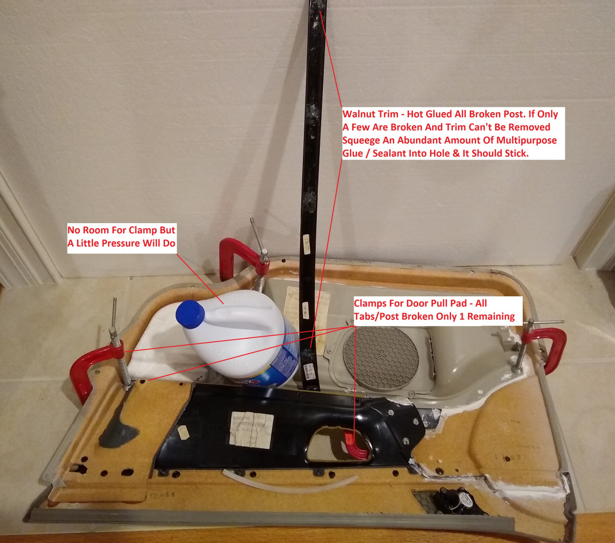

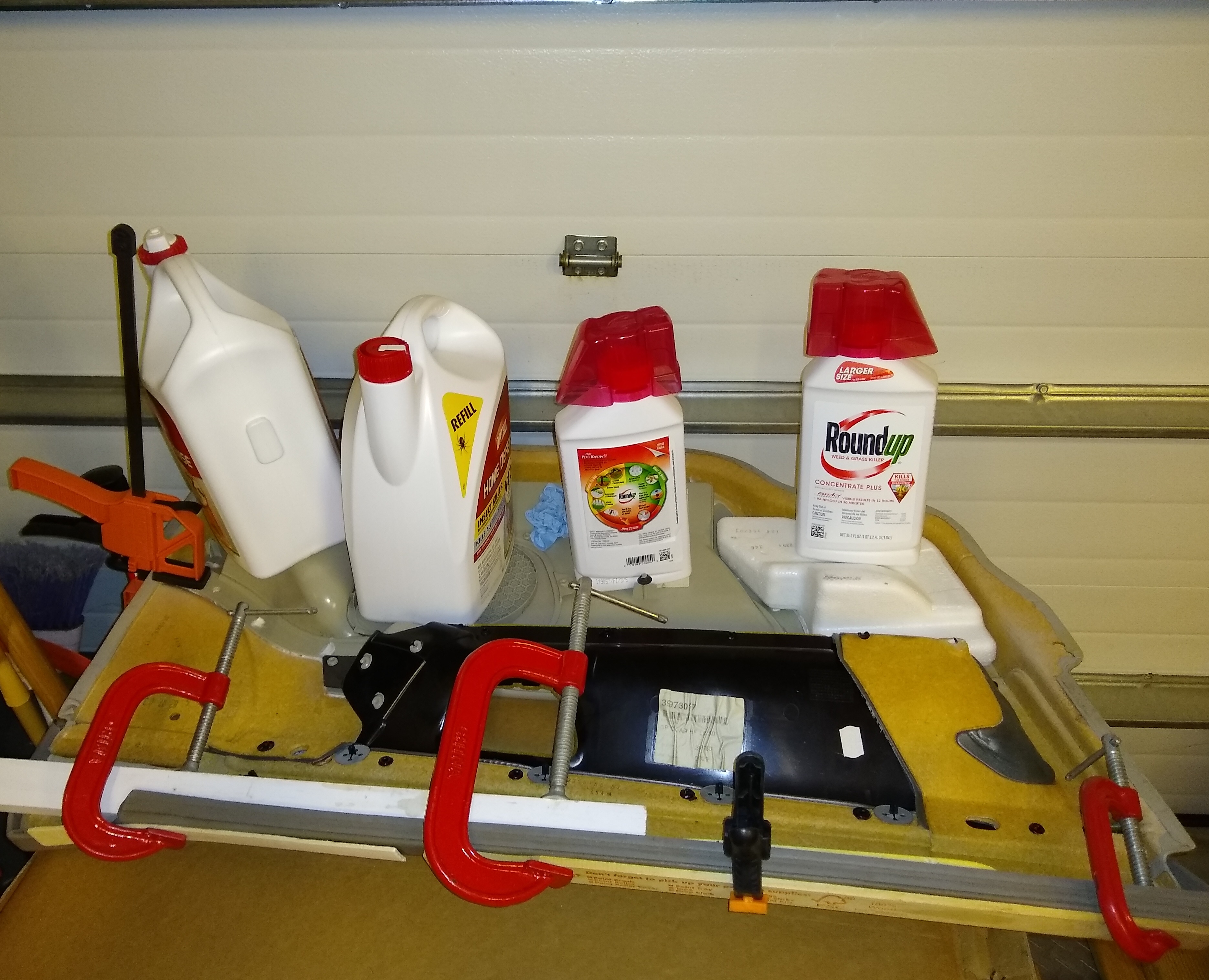

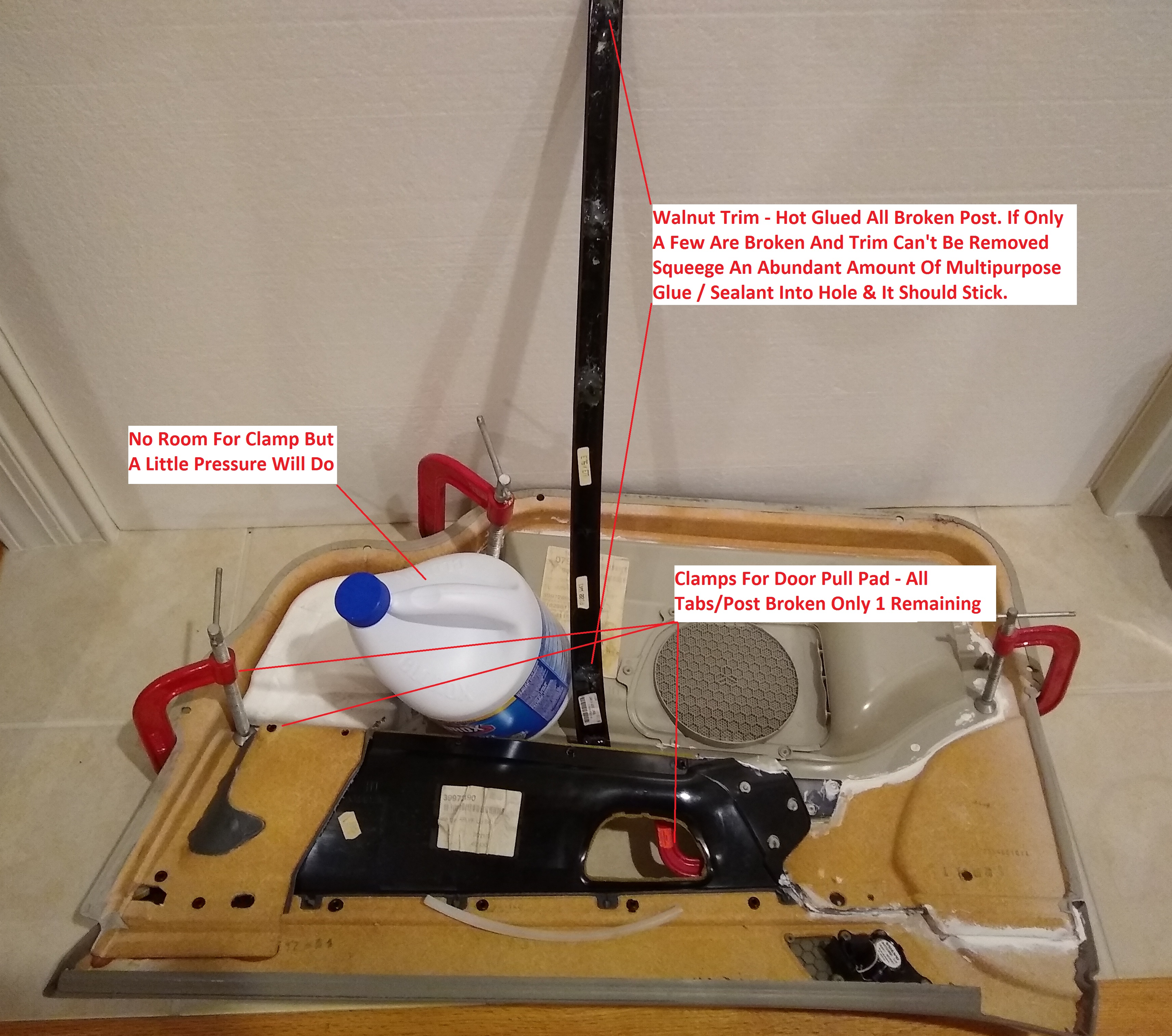

03 S80 T6 - Almost finished de-rattling and putting back all the door panels and center console. Started with repairing the driver's side door actuator motor and replacing the rear passenger door switch. Discovered the 2 panels pretty much came un-glued. The center console locking mechanism was not working and pops out easily so decided to remove the entire unit to see what was going on also.
