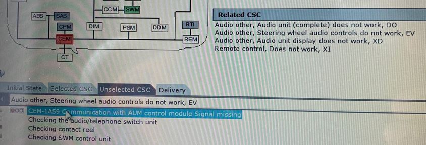

Can The Audio Error Report Be Disabled
Post by Oka »
I believe this error came from the following past issues.
Replaced the stock receiver with an after-market brand.
There is no adapter for Volvo to be able to use the steering wheel controls for the new sound system.
This car had a remote starter. It got removed and installed into another car.
So, the above three issue I believe would cause such error. Since the steering wheel audio control will never be used again and no more remote starter, the CEM-1A59 error would keep showing.
Is there a way to disable this so as not so show the errors anymore?
Thanks

Post by RickHaleParker »
If there is a parameter to turn it off, it should be somewhere under Diagnostics/Vehicle Communication. Just keep in mind the picture of a VT2000 is a icon and the gateway to the parameter programing.
