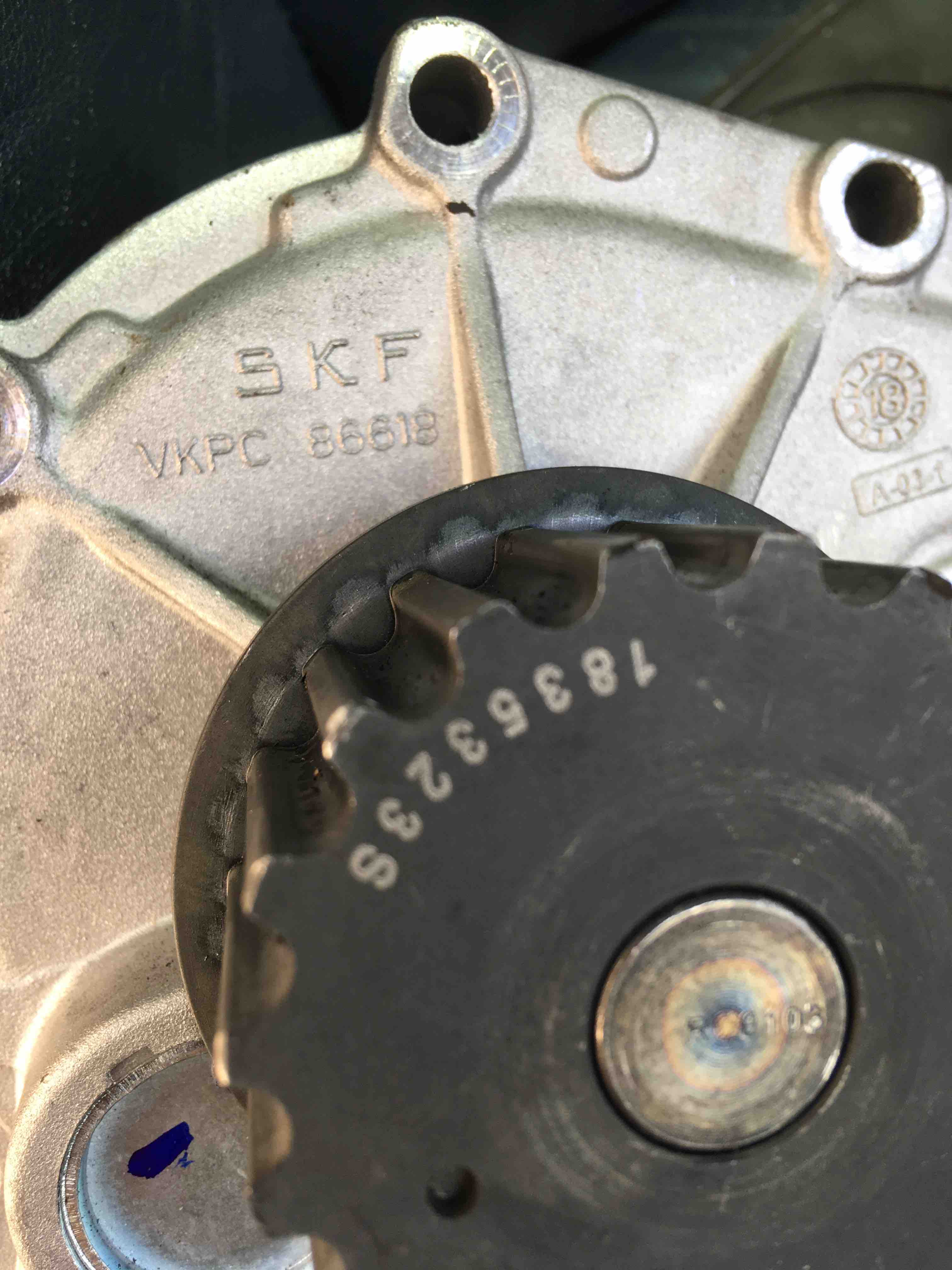

Hy buddies,
I've made a mistake while I was assembling the new water pump for Blue.
The water pump is an SKF VKPC 86618. I have to replace the paper seal because I've hurted the new one. Can someone tell m me where I could find a seller who sells this part separatly from the pump ?
Thanks to those who will help.
Manov

I think (but do not know) that the gasket design is the same for all of the water pump vendors (Aisin, HEPU, SKF, etc.) because the mating surface on the engine is what determines the shape and location of bolt holes for the gasket.
You can get a water pump gasket (Volvo part number 30677767) from a dealer or independent part vendors such as FCP:
TascaParts (Dealer):
https://www.tascaparts.com/oem-parts/vo ... dhcw%3D%3D
FCP:
https://www.fcpeuro.com/Volvo-parts/850 ... d=665&v=87
