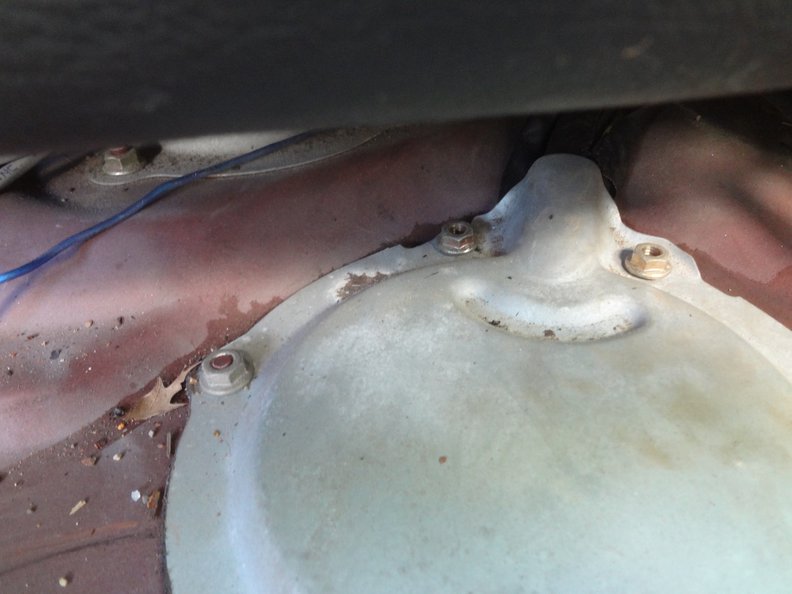

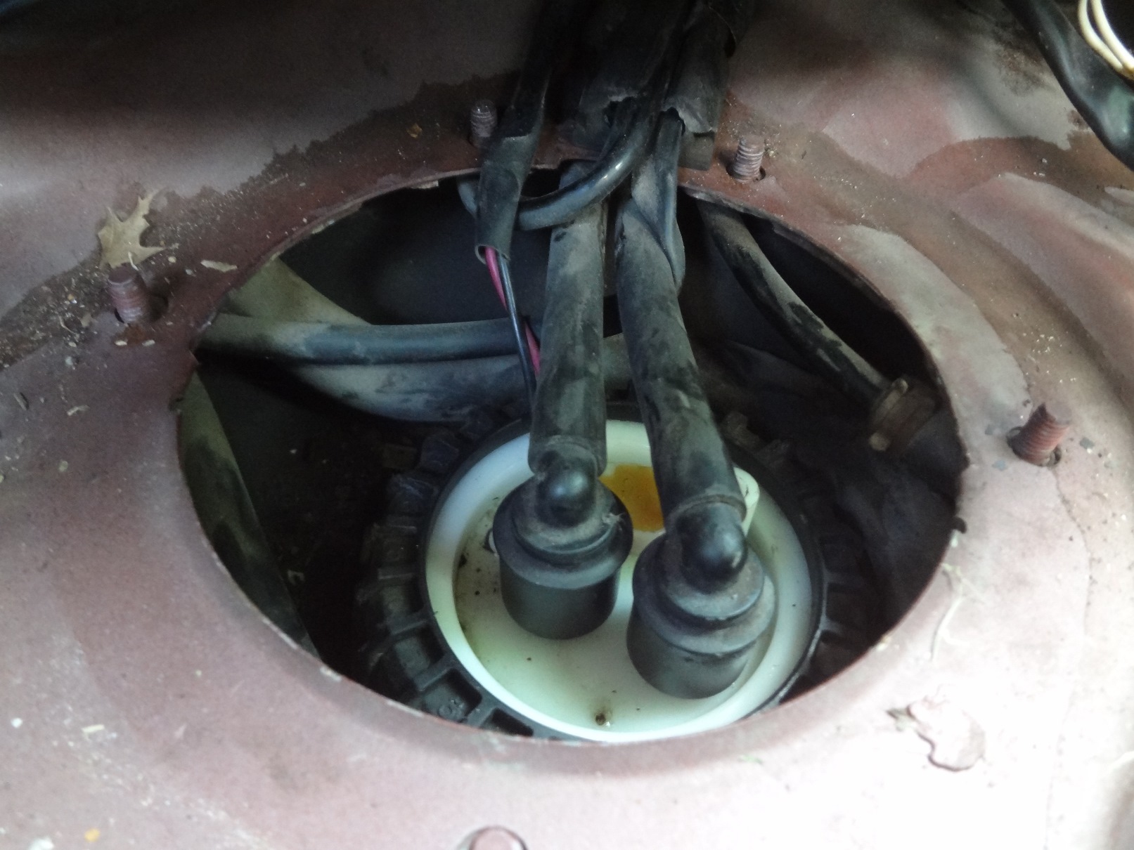

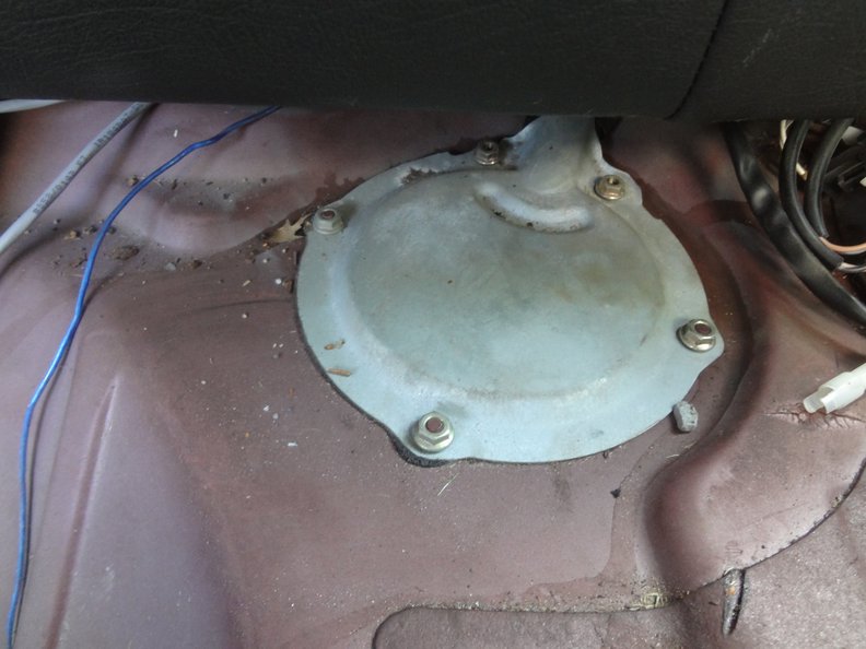

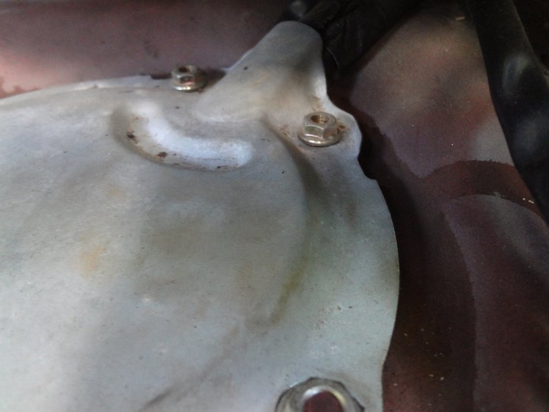

If the hoses connections are not leaking, buy the fuel pump gasket and replace it. Your local Volvo dealer probably have one in stock.southofmotown wrote:I found some evidence of leaking around the fuel pump access panel. The access panel was not screwed down, so I tightened it. Any ideas on what to do now?
https://www.fcpeuro.com/products/volvo- ... aQodLsAK3w

If that access panel was loose, someone has been in it. They don't loosen by themselves.
I would guess someone did a fuel pump or hose repair and had left something loose or did not tighten to spec. Lift it up again and check all the fittings.
Are you still smelling gas? Can you isolate it to front or rear ?
