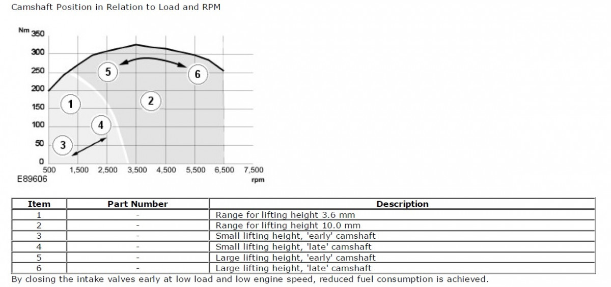

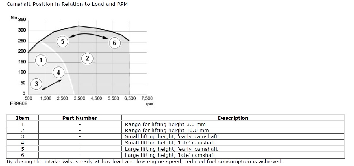

The graph above shows the Variable Valve timing and Variable Valve lift
This graph shows the regions that the the variable timing and variable lift are active

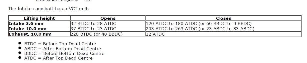

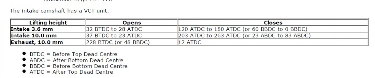

This charts shows the lift height

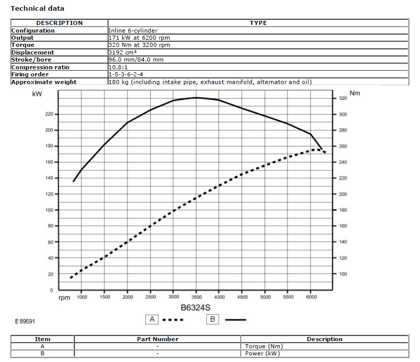

This is the end result of all that
A very flat torque curve
