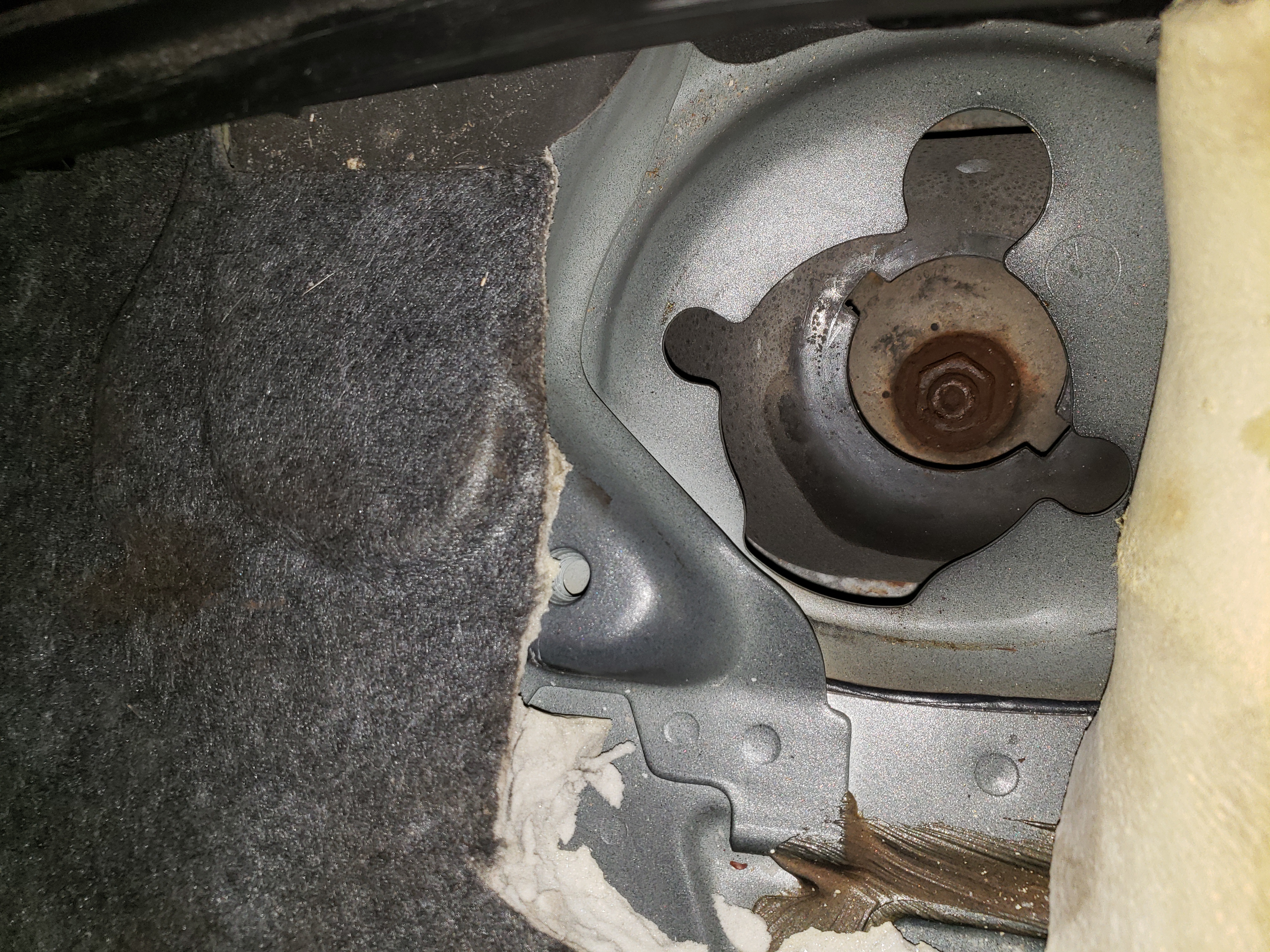

Doing my rear struts on the XC90. It is a 2011 V8. I am completely stuck. I could not get the nut to come lose on top inside the vehicle. I did get it to turn but the whole assembly turns I dont have a deep enough pass thru socket to be able to get a star key up top to try to hold the piston and break the nut free. I also dont have a tool to cut off the nut that is small enough to get I to the access hole. Any ideas on what to use? If it has to be cut is that a bad idea since passenger side seems to be near fuel tank door... I am new to the rear strut removal but there has to be a simpler way to get this out. The bottom bolts come out fine just the top ones have an issue. Please help. See attached pic. Thx

If the shock cover is plastic you could potentially cut it and put a pair of vise grips on the piston and use a socket on top. Before that lubricate and let it sit for a day. It you have a torch heat it first then lubricate after it cools. Regardless you'll need something to hold the shock piston from below if you can't use the Torx on top.

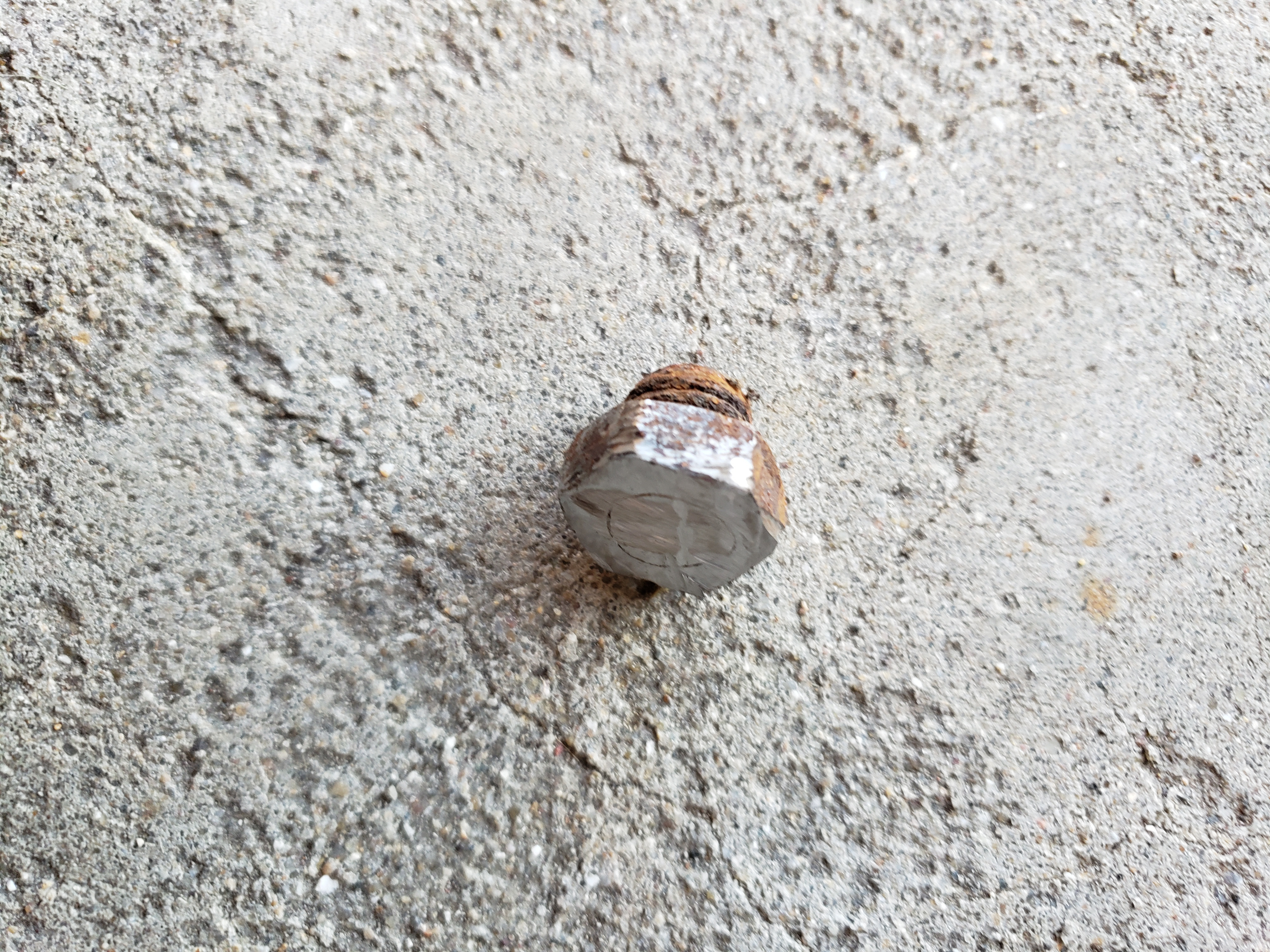

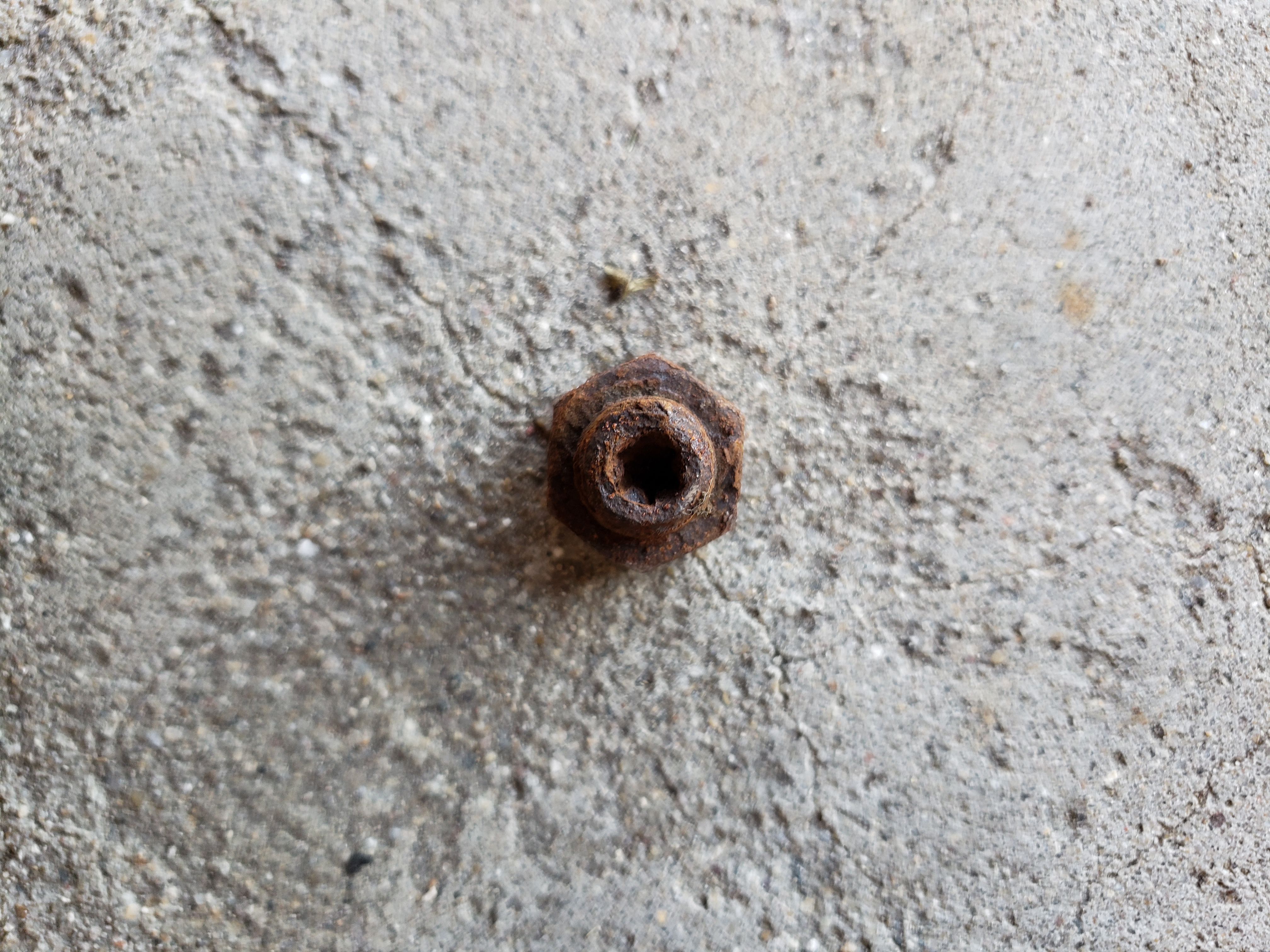

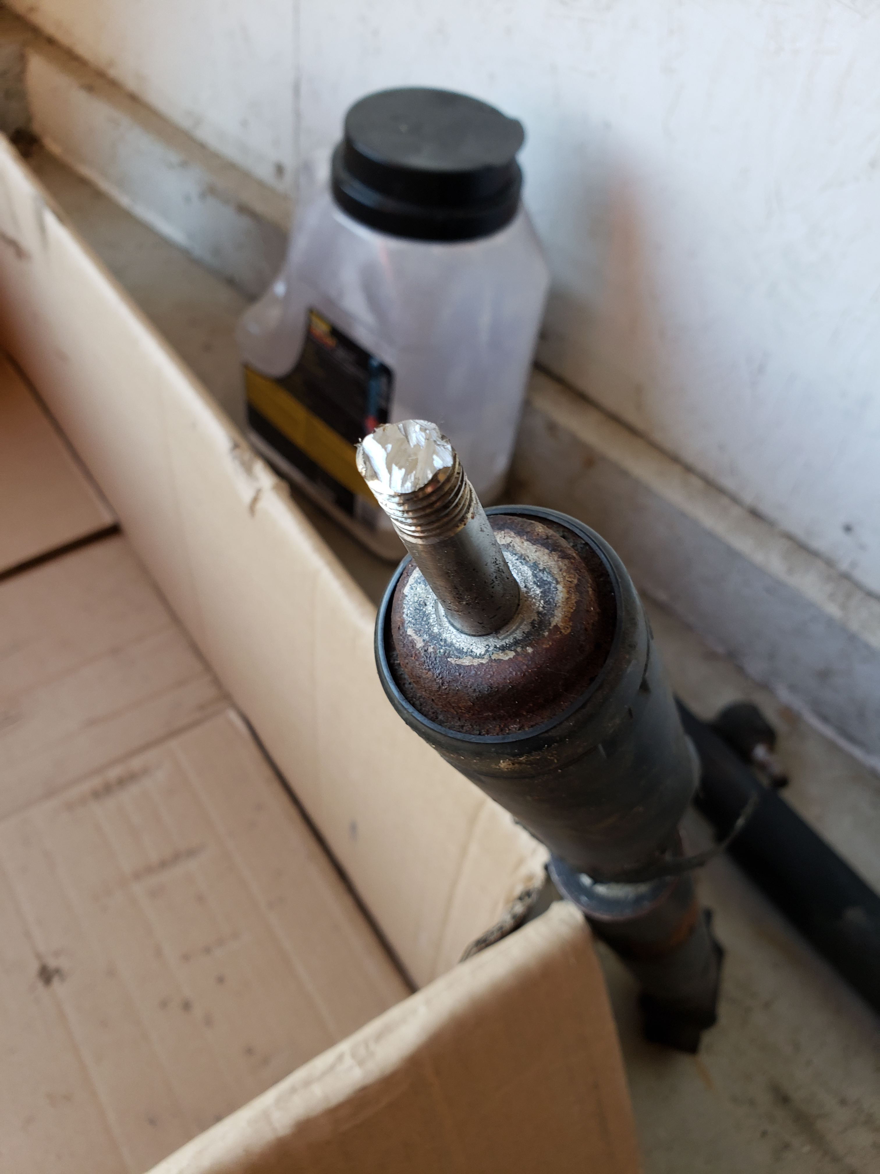

Pretribrapper
- Posts: 116
- Joined: 10 December 2016
- Year and Model: 2011 C30 2.0 T5
- Location: Wisconsin
- Has thanked: 51 times
- Been thanked: 6 times
So sorry. Attached are pics of end result for removed strut and tools. I was able to use 1" reinforced cutoff wheel on rotary tool to go straight in and cut around the nut to sheer it off and the strut then dropped out.
