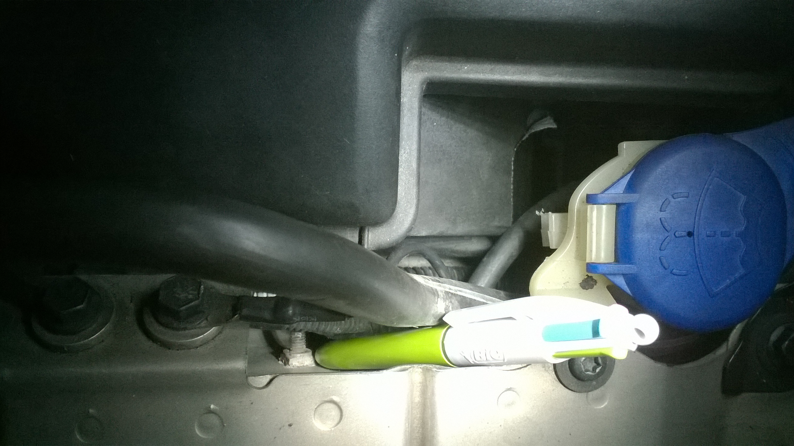

I agree with the post above. The module bracket is fixed on the chassis with a regular screw which protrudes into the engine bay. It can be grabbed with some pliers from the engine bay side and unscrewed. Then a regular hex screw can be placed to keep the bracket for the new siren module.

This is the bolt that keeps the siren module bracket in place. Picture from the engine bay side. To get access to the bolt, remove the upper half of the ECM box, like shown in this video
