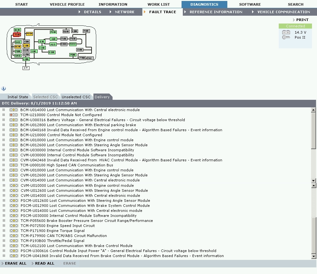

I finally got a dice that works and feel lost reading this list
what does it mean lost communication with this and that?
with so many problems, how come the car moves?
anyone can help find source of info?
lost communication with "everything" why??

Explore around a little. If you go into each one, it will tell you when it occurred, how frequently it occurred, and how many normal cycles since it occurred. If it hasn't been read and cleared in a while, these may be old. (Perhaps when the battery went flat 2 years ago, or whatever happened to your car along the way.) Document them, clear them, and see what comes back. That will tell you what are active issues today.
