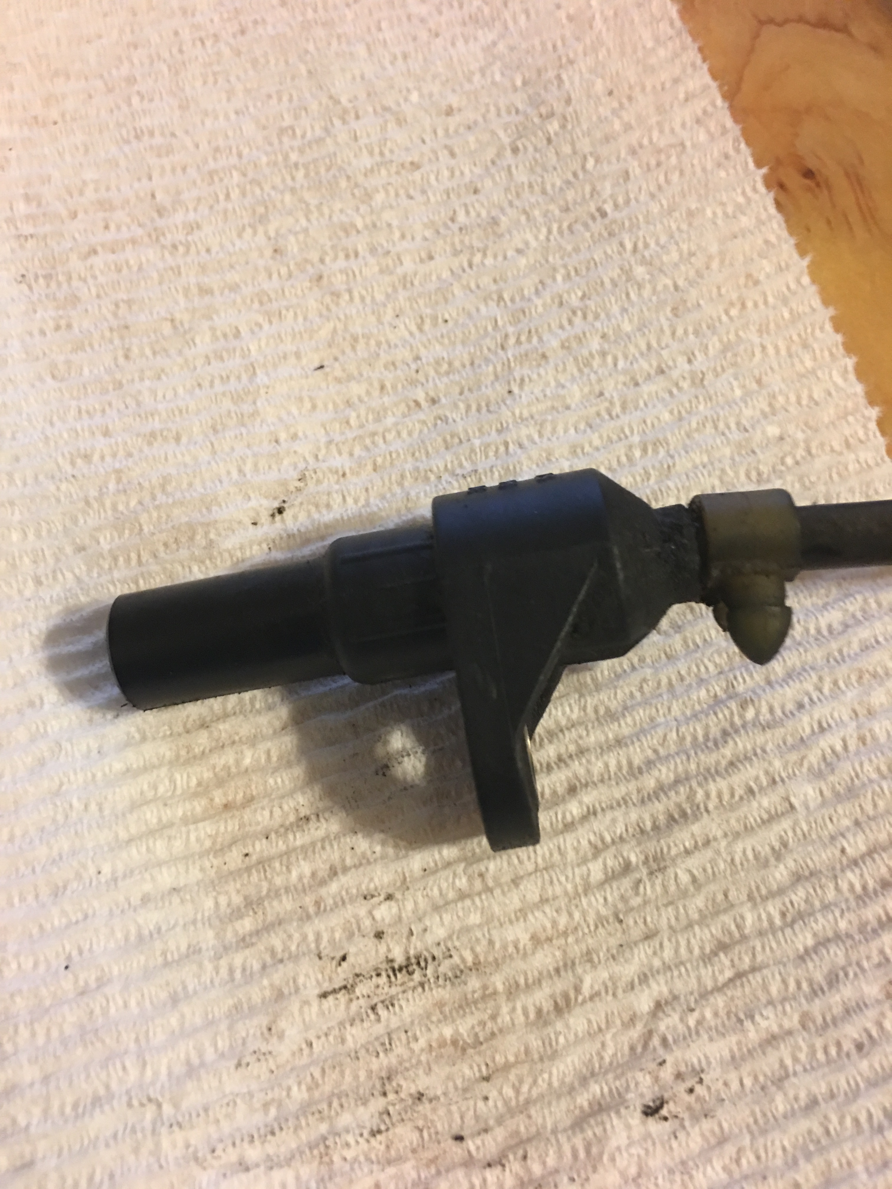

I pulled some parts off of my 1998 V70 base last night, hoping I can transfer some of these to the 96 850.

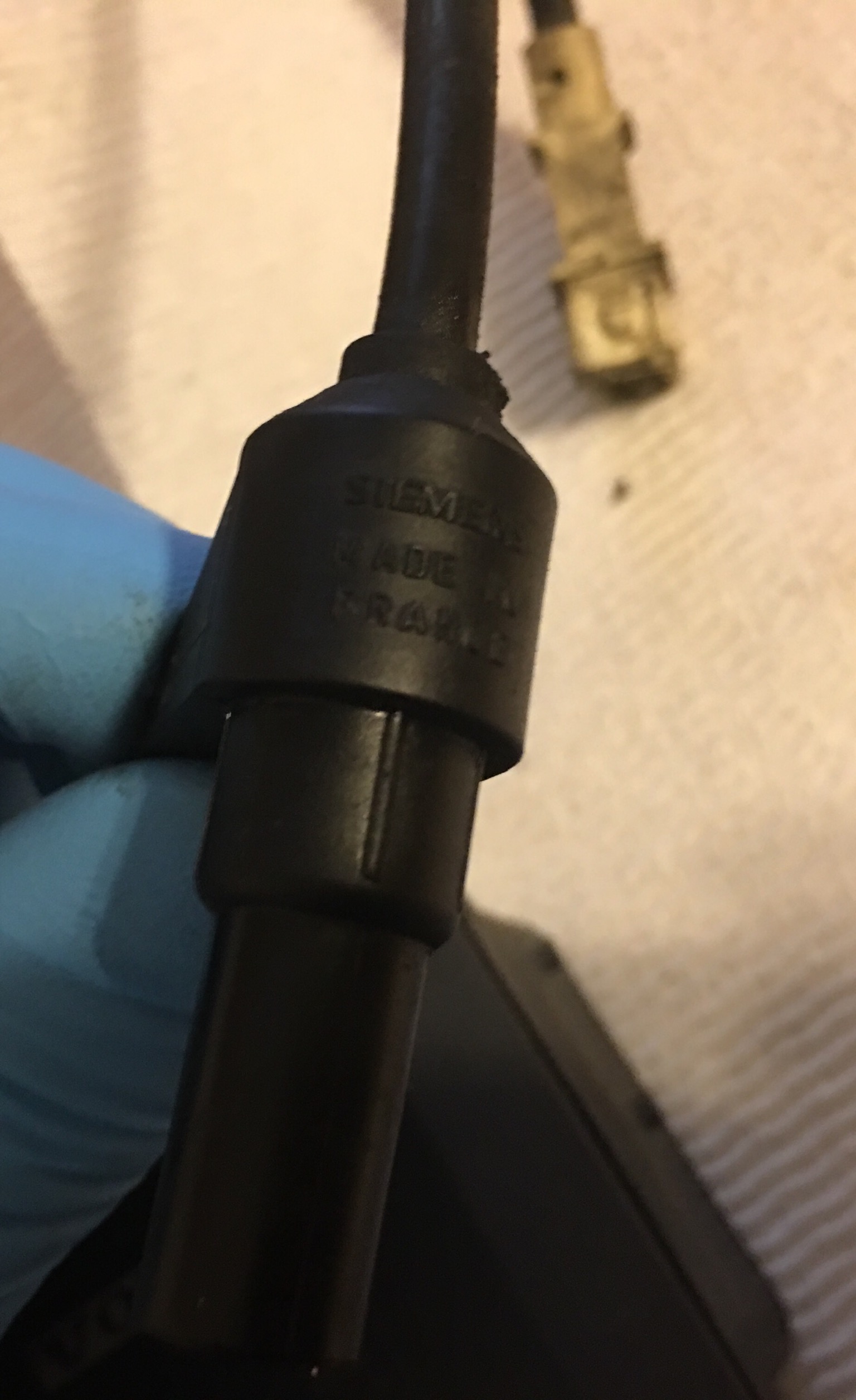

The crank sensor from the 850 is all black plastic and says “Siemens, Made in France” on it and I don’t see a Volvo part number. Some internet searches seem to confirm that this is the correct part for the 850, so say it’s not.

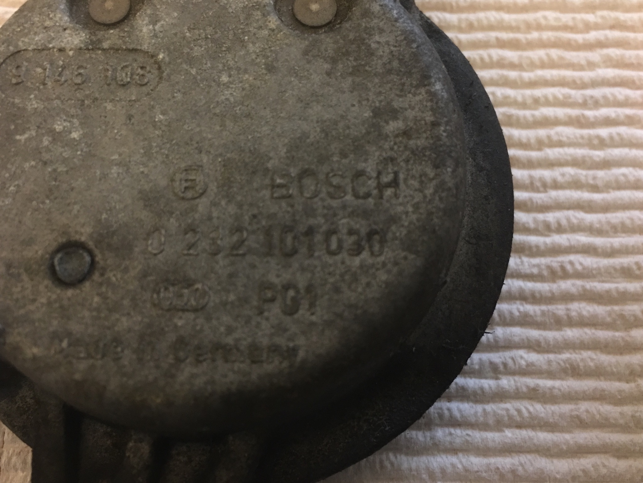

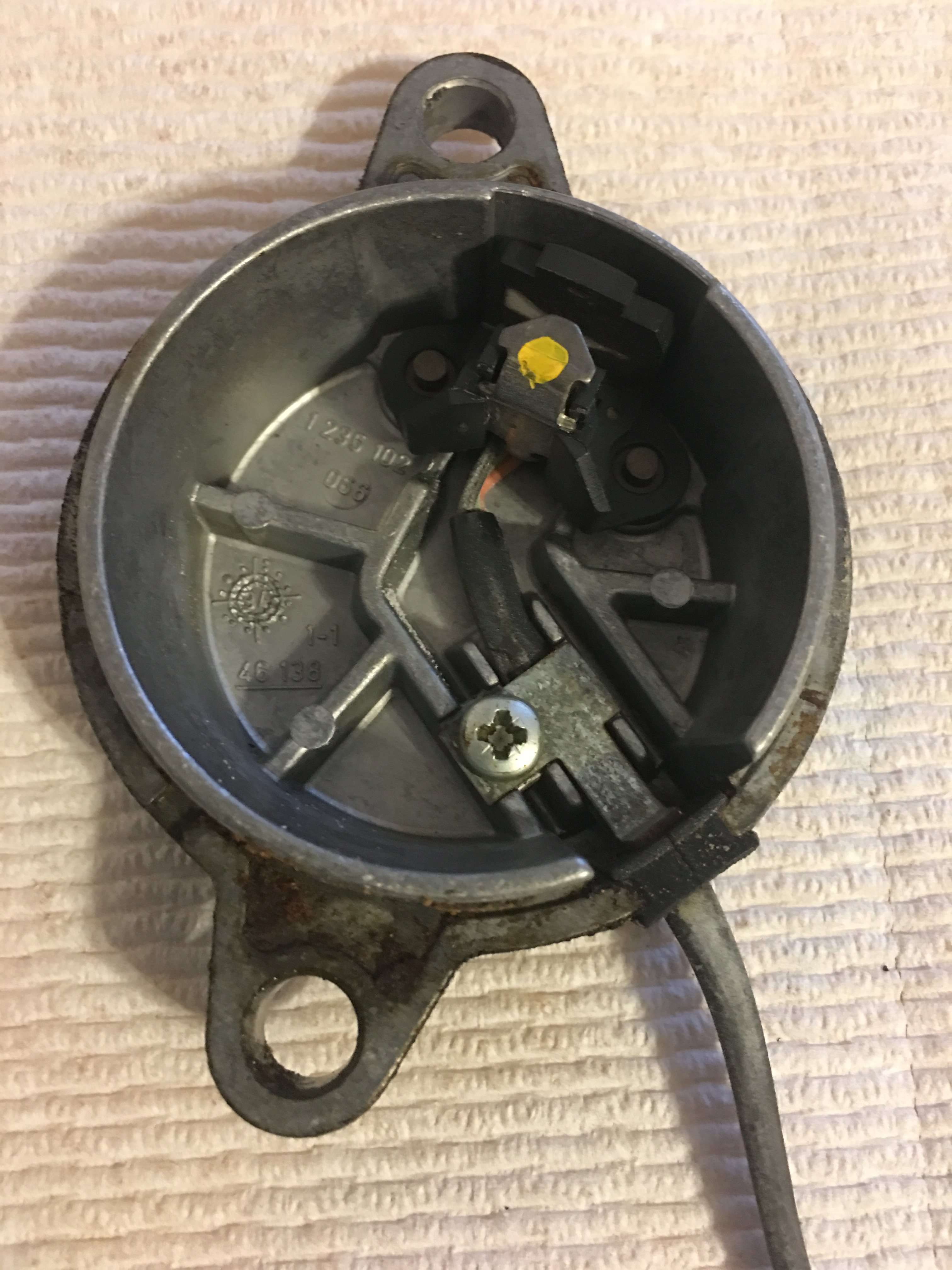

I also pulled the cam position sensor, and I feel pretty confident this should be plug and play on the 850.

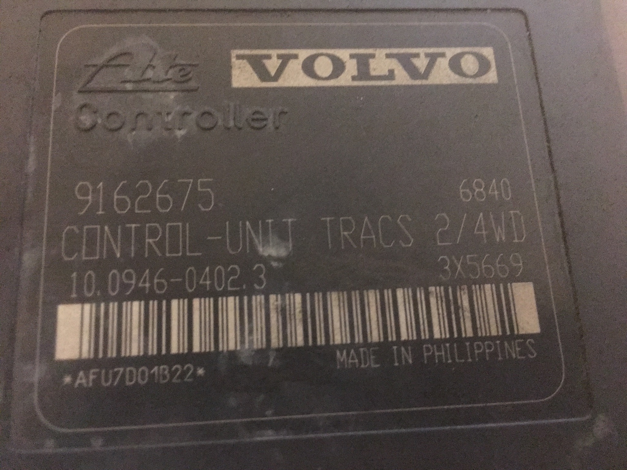

I also pulled the Ate ABS module from the V70. I never had a problem with TRACs not working in that car.

Pretty sure if both cars have TRACS, that '98 ABS module should work on your '96.
Cam position sensor should swap, as well.

You can check the ABS module part number for compatible part numbers on Matty Moo's website at Mid-West ABS.

9140774 & 9162675 has been replaced by 8602266.
8602266 Fits These Cars
Volvo 850
1996 Volvo 850 ABS Control Module
WITH Traction Control, Marked "ABS"
1997 Volvo 850 ABS Control Module
Volvo C70
1998 Volvo C70 ABS Control Module
Volvo S70
1998 Volvo S70 ABS Control Module
Volvo V70
1998 Volvo V70 ABS Control Module

Sorry I didn't see this thread previously: There is no question, all three of those parts (cam and crank sensors, that ABS in the pic) swap between your 98 V70 and your 96 850, no problem. They are exact matches.
The ABS bulb must be out, you are correct. I would definitely swap in that ABS module, as a troubleshooting method.
I'd also assume the cam and crank sensors are good, given that the V70 was working fine. But replace them one at a time if you're going to do that. It would be unusual for either them to show misfires, for the record, but worth a try because it is trivial to swap/test.

That said is it safe to assume all base 96 850 vehicles did have ABS as standard equipment? I checked with Matt from MidWest and while he confirmed the part number photographed above from my 98 V70 base would work in an 96 850, but I assumed and think I told him that they were both ABS cars, without knowing about this light not working
