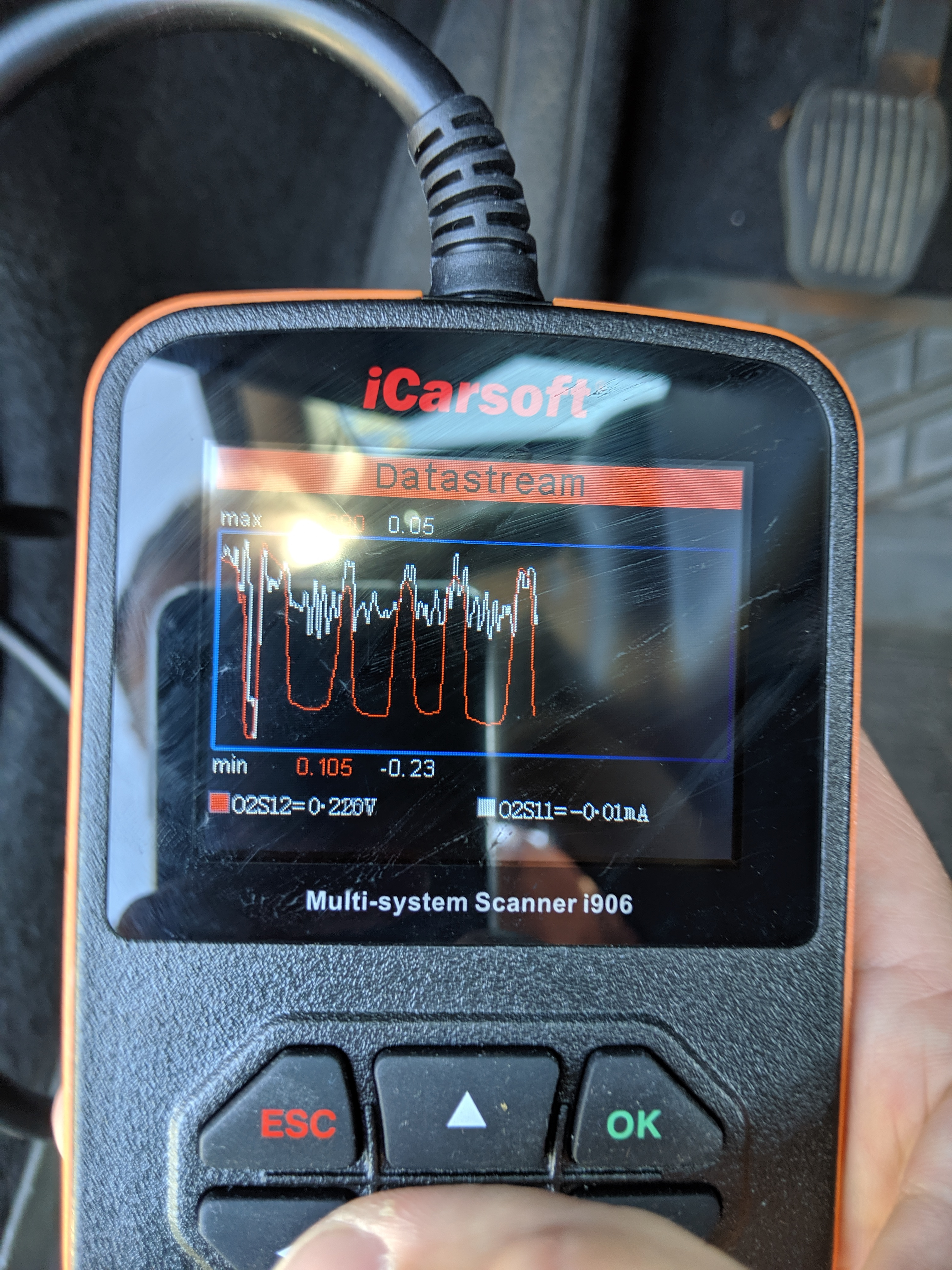

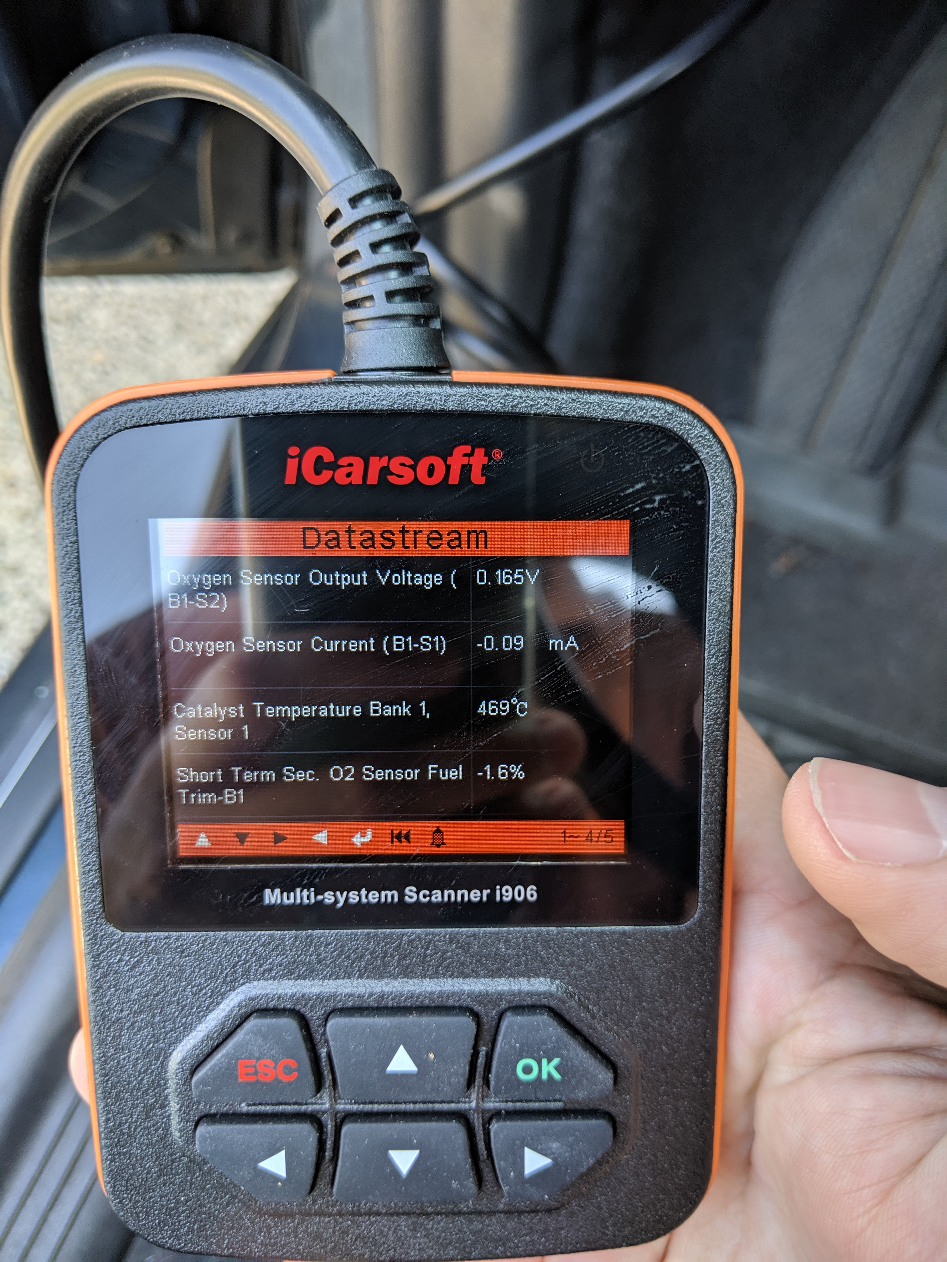

The Volvo has no other codes; below you can find the read-out of the O2 sensor while running 2000 - 2200 rpm. The CAT was around 400-500 degrees Celsius (according to the sensors).
I`m wondering based on this data (as one sensor is in amp i/o voltage) if I can exclude the sensors as a problem?
