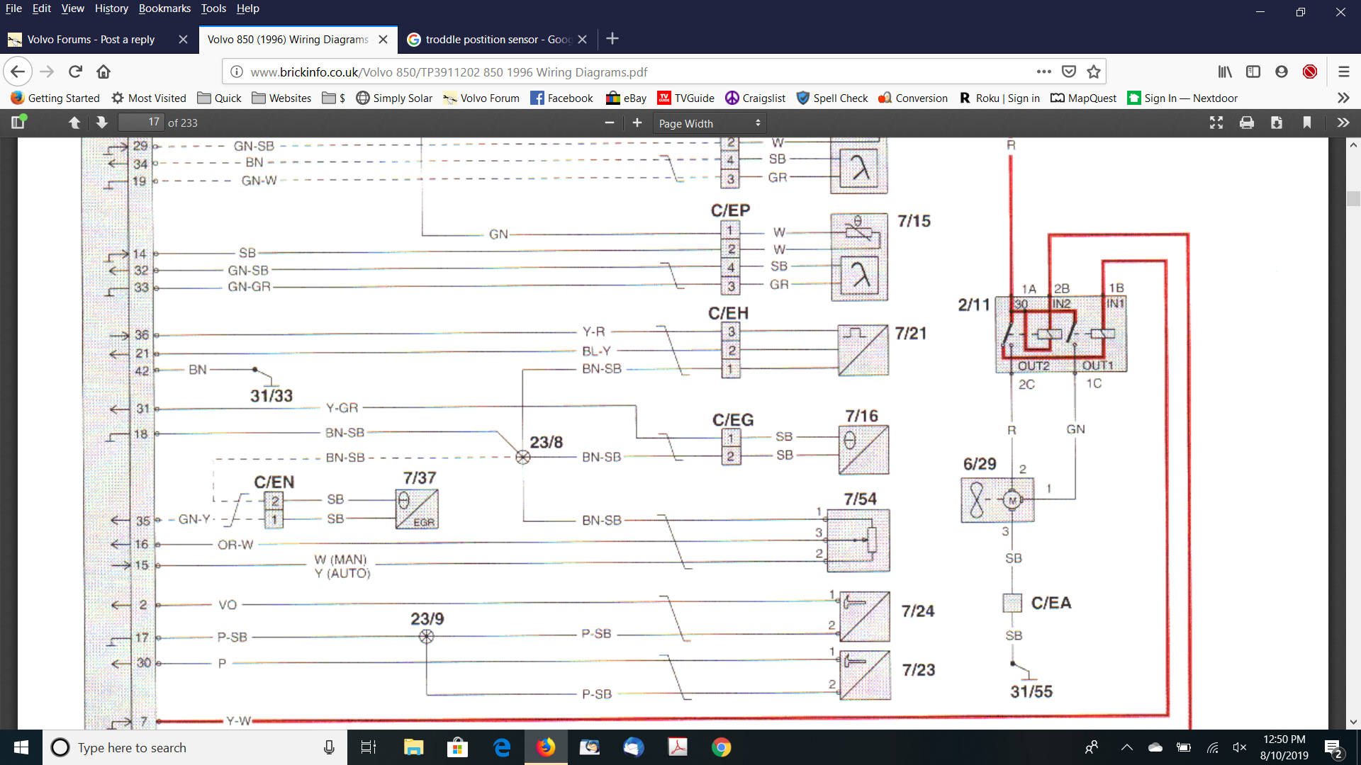

Thank you for all the great responses. It seems like you all agree that the issue is in the wiring connections. I spoke with the mechanic who performed the test at the dealer and he did do a resistance test with ohm meter from ECU pin to TPS connector. They also moved the wires during the test. No problem found. With all the other variables removed such as TPS and Throttle body replaced. ECU swapped. The only thing left is to replace the 3 wires from the TPS connector to the ECU. So my question is, will that help solve this problem? I only have the Haynes manual and it doesn't show wiring diagram. Can anyone tell me which ECU pin I should test along with the TPS connector. I just want to make sure to double check dealer mechanics findings before I dig in. After reading about Volvo's with plastic manifolds going up in flames and newer models braking without warning needlessly, I'm even more motivated to keep this car going!!!

See sticky thread above on wiring diagrams.

ECU pins A15, A16 & A18.
A15 TPS Out
A16 TPS IN
A18 Ground
Check Junction 23/8.
The Electrical Wiring Diagram for the '96 850 is document TP3911202.
7/54 is the TPS.
