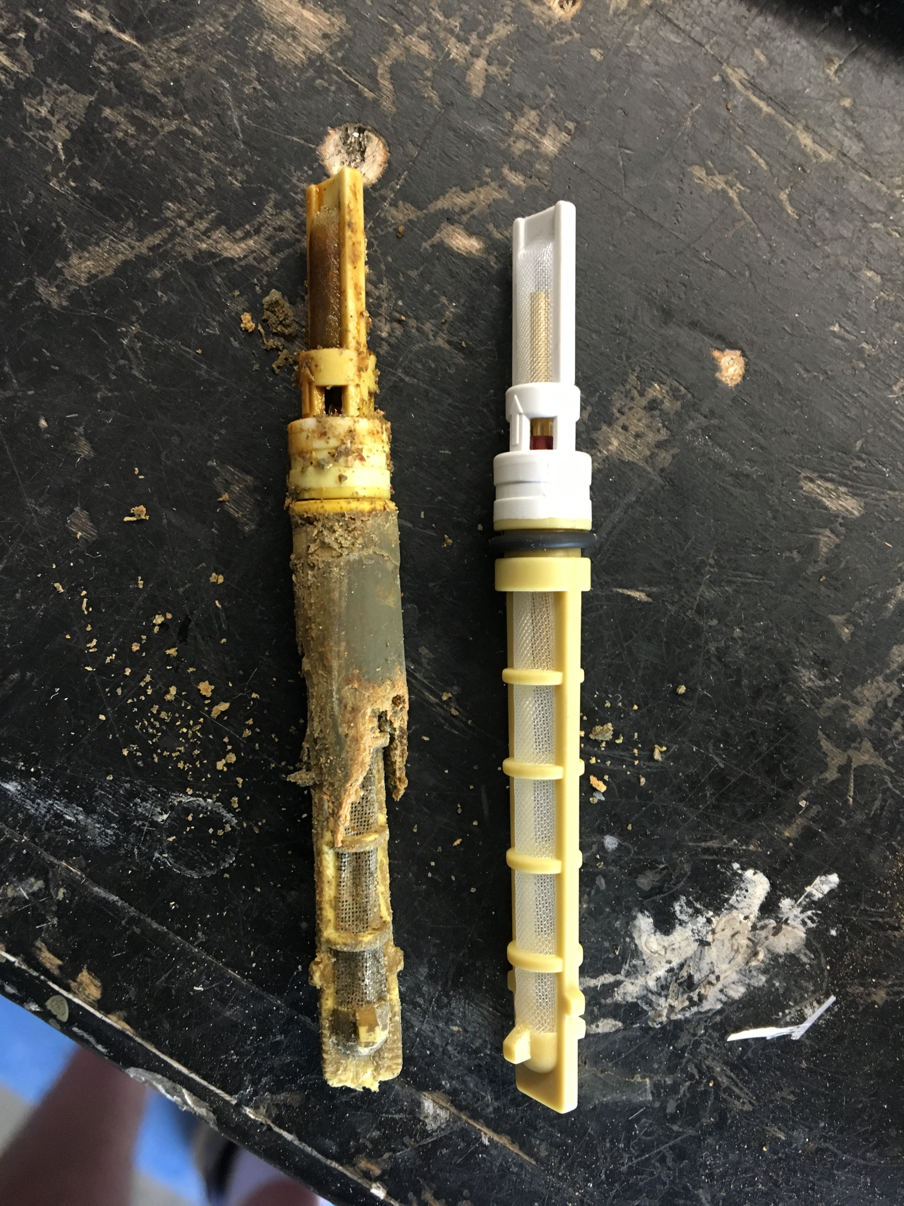

Anyway, have a look at this expansion valve! I’m glad I decided to change it along with the receiver drier!

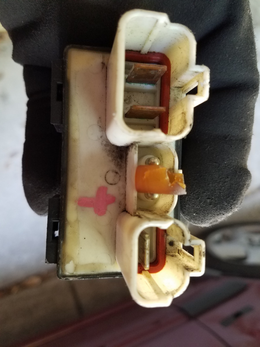

Spent the afternoon trying to diagnose why my low speed fan doesn't seem to work.
Things I'm noticing:
At 206F the overflow tank is filled to the top
At 208F the lid begins leaking
Turning on the AC engage the fan and brings the temps down quick.
The yellow wires for the center relay plug were crammed full of whatever orange insulating rubber material was originally put in there. It wasn't doing its job anymore so I removed them from the plug housing and connected them directly to the relay pins.
Things I've tested:
Low speed and high speed both come on if I ground out the yellow wires on the relay.
The yellow wires correspond to A7 and A22 of the ECU. I am measures 3-5 ohms for both wires up to the ecu.
I tried switching the yellow wires
I swapped out the relay for a spare
I tested the relay outside the car with a meter.

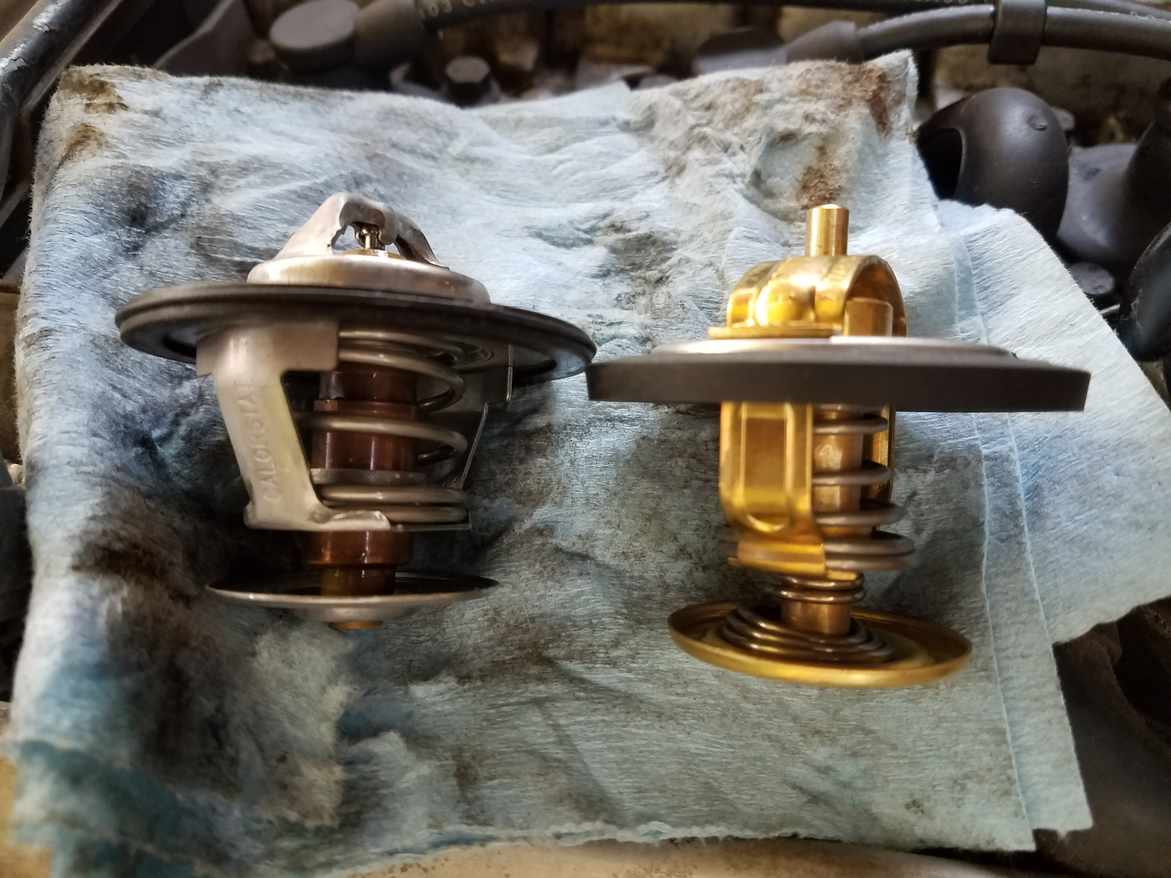

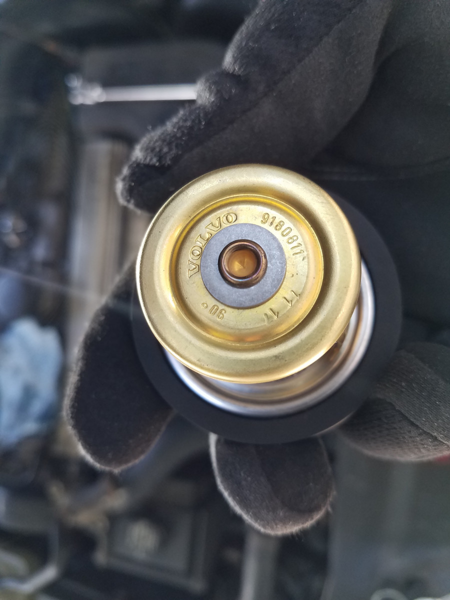

Also changed out the thermostat today. A craftsman T40 ended up doing the trick. The new one is made in Germany where as the previous one is stamped France.

Errr , now we know why we don’t use “stop leak’ in a “COTS “ or orfice type ACbmdubya1198 wrote: ↑11 Aug 2019, 22:09Yeah, I definitely believe that... it’s a big job. Granted, I’ve taken quite a few breaks to do other stuff (helped my cousin swap out his rear brakes on his S70 he just got back on the road with a new Xemodex ETM, that only took 20 minutes though. Also helped my dad bleed the brakes on his E39 which also got new rear brakes today) but this project is going on 3 days.

Your '96 should have the OBD2 diagnostics, correct?ZionXIX wrote: ↑12 Aug 2019, 15:30 Spent the afternoon trying to diagnose why my low speed fan doesn't seem to work.
Things I've tested:
Conclusions:
Theory 1: bad ground --> cleaned as many as I could find a few weeks ago with a brass wire drill brush.
Theory 2: ECU is not grounding the relay properly = bad ECU
Theory 3: I could have 2 bad relays
Theory 4: reservoir cap is not holding enough pressure, not sure what they are supposed to withstand or what temps activate the fan.
The "850 OBDII" app allows you to test the high and low speed fan function (through the ECU). I just recently used it and it works well. That will help rule out ECU wiring or ECU issues.
