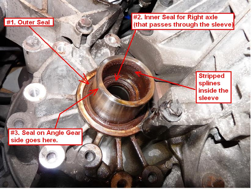

-Axle seals (not as nice): Sort of self-explanatory, but these will usually get ATF spraying around the axle area and should be easier to identify by getting under the car. On your car, the driver's side is relatively easy to get to. On the passenger's side, you likely still have your angle gear attached (I don't, but that's another conversation!). There are two seals between the angle gear unit and the transmission, one that is a seal for the angle gear power transfer spline, and one for the axle connection itself. You can't access or change them without removing the angle gear, which isn't terribly difficult, it's just heavy.

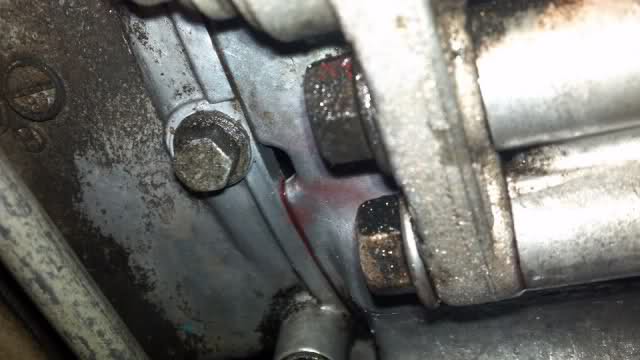

-Trans input/torque converter seal (bad day :( ): This is what I had initially, and even after replacing it, I still had an internal leak. This is the seal between the input shaft to the transmission/torque converter and the engine. It's a $20 seal, but to fix this, the transmission is coming out, no way around it. If the car/trans is warmed up and running, and everything is cleaned up, look for fluid coming from a little weep hole between the engine and transmission (pictured below). This leak is more rare, so I hope it's not the case for you.
I recommend trying to clean down the whole area with rags, brake cleaner, or whatever. Fill up some ATF and see if anything drips with the car off. Turn on the car up on jacks (or safer, ramps) and watch for leaks. Your description makes it sound like it was a big and fast leak, which makes me think it's more just a hose or axle seal. The input shaft seal is in there pretty tight, and even when it did leak for me, I was only filling up ATF about a quart every 1000 miles or so.

Since the car does not have an angle gear, it gave the sleeve a means to fall out, and it did. That was the only problem lmao! I just drove her home with a mallet and now I'm gonna put the car back together. The only reason I didn't immediately know that was the problem, was when I looked at it, this isn't a 90's Honda or Saturn (the cars I know in and out). Without that pic ecbsykes (how do tag on here?) posted I would not have figured it out. For now I'm just gonna put it back together, and keep an eye on her. Now that I do have a little time I think I'll order good seals and use high heat thread lock or adhesive to bond that sleeve on to the splines (unless someone has a better idea).

So I've had my angle gear out for years. I'll tell you that no adhesive or anything will keep that spline in where it should be. The most effective method is using two larger hose clamps wound into eachother, clamped around the axle. Push it up against the angle gear sleeve to hold it in place and tighten the clamps. Had worked well for me for years. I can grab a pic tomorrow if you're interested in this setup.
