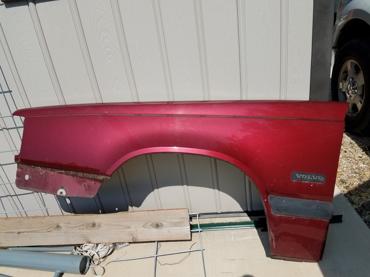

Found a perfect fender panel in the junkyard Monday.
Does anyone know how to install the outer door trim? Does it just snap onto the plastic pieces or is it better to slide it on?
