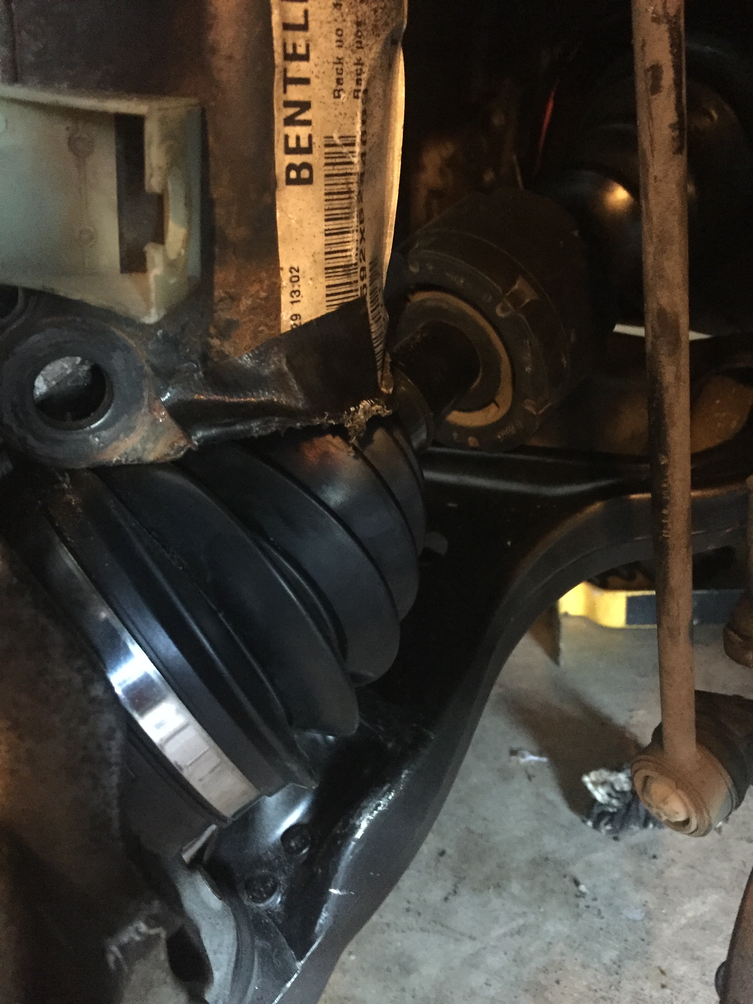

So I can make the strut wobble over to the other side, the CV boot is literally in the way of it though.
Here is a picture of the situation from a different angle, I'll be giving it a go tonight, and if I fail I'll consider removing the link or try something else or god forbid buy some kind of new tool just to pull harder on the control arm.

Just careful not to let the spindle hung free and pull on the CV joint - the outer CV joint may dismantle inside and be tricky to be put back in place

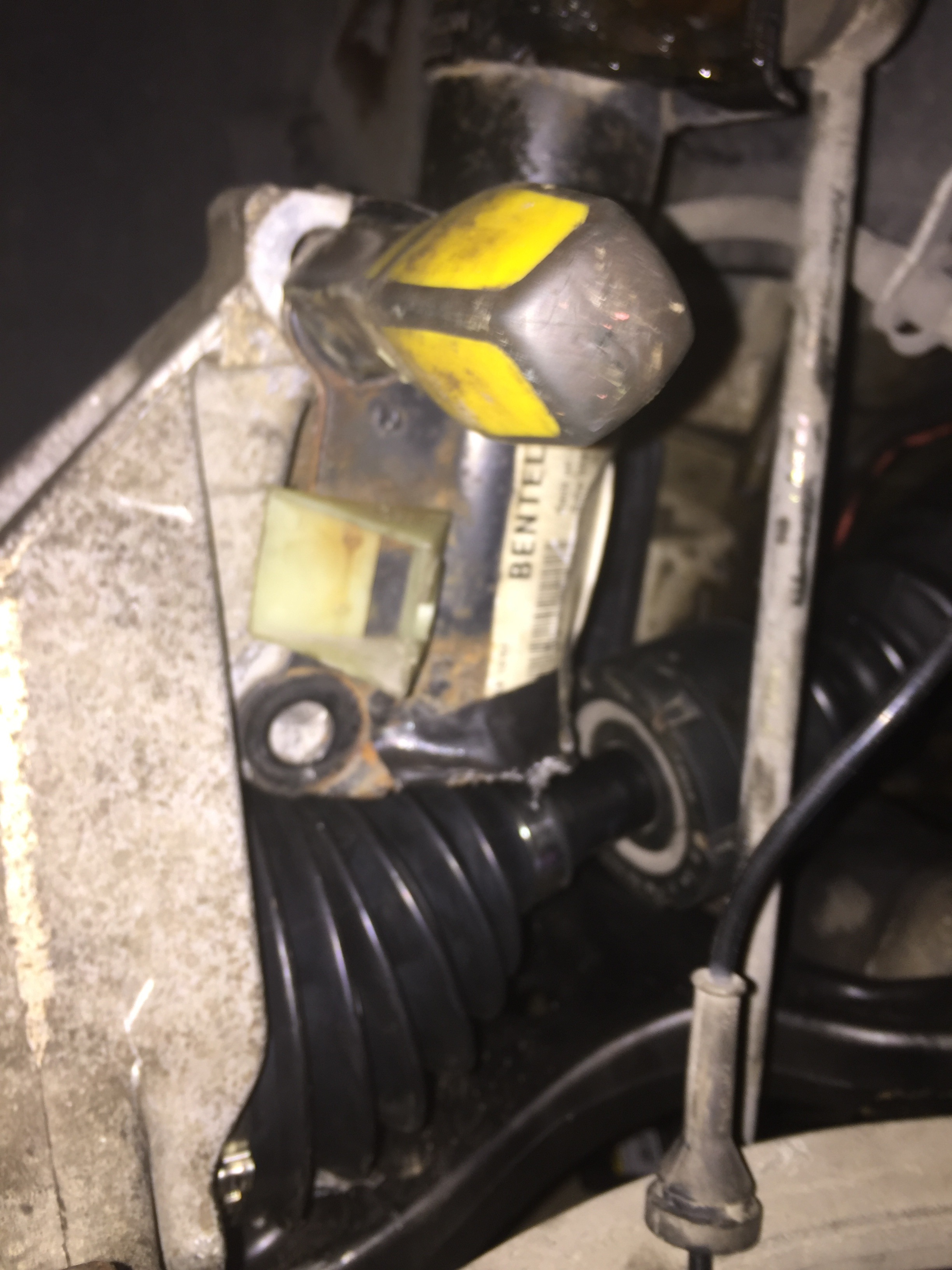

Here is the outcome of the project, Success!
I did make use of the tip to "catch" the hub using a screwdriver to jam in there. It was resisting me a lot and I never would have gotten it done without that trick. I had to use all the force I could muster. I did ultimately pinch the fins on the boot in doing all this, as the strut had no play in it. The damage to the fins wasn't bad enough to cause much concern, just a little scrape.

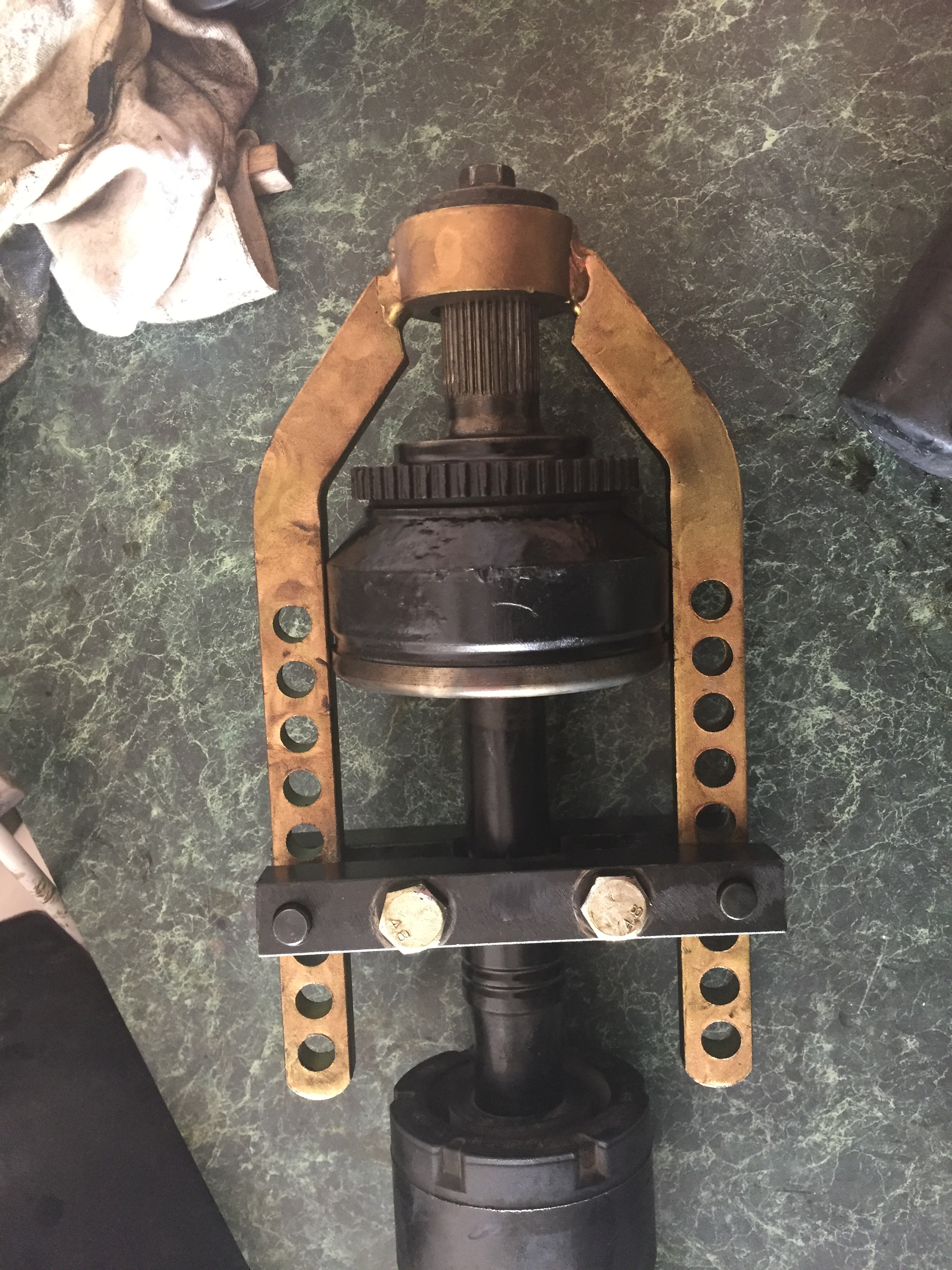

photo of the CV puller in the 3rd photo ($17)

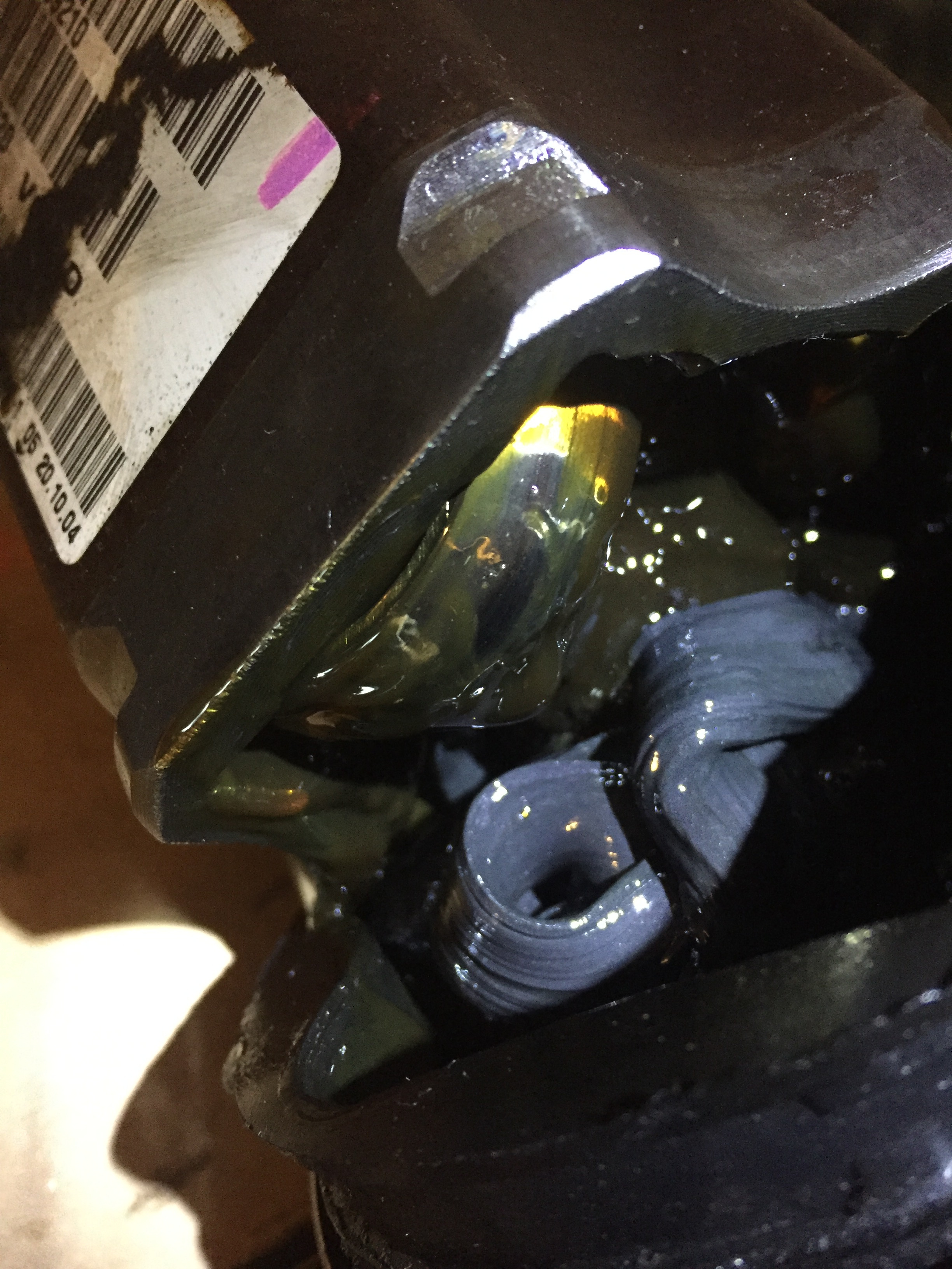

* the 4th photo is of the inside of the inner joint. I left the joint and original grease as-is even though the grease seemed corrupted. The grey glob is new grease I added.
