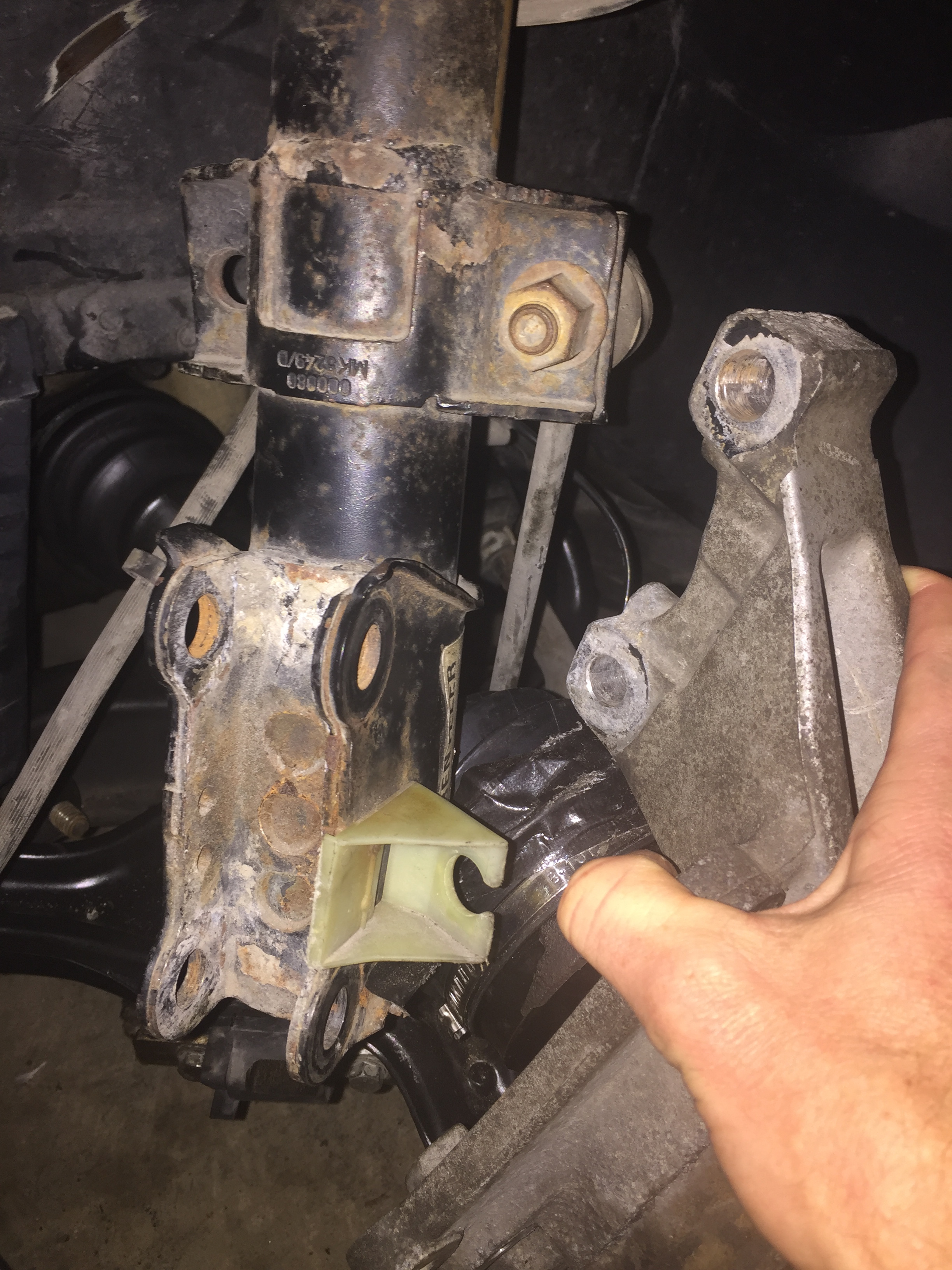

The question: How do I force the control arm back onto the steering assembly? I lack skill, tools, and strength.
UPDATE on the boot. The car parts place didn't even have a brass "drift" as called for by Haynes. I had to buy a CV joint puller tool off Amazon (which after I hooked up wrong the first time and squeezed the vibration damper inward an inch... dumb).
I have reinstalled the axle, and put the knuckle back on the strut. I'm protecting the boot with tape over the bottom edges of the strut. I also reinstalled the control arm. The problem is that nothing wants to go together and I'm not strong enough to push the control arm downward to get over the stupid bolt coming out of the ball joint.
It seems I need to do one of two things:
A) Remove the axle from the transmission to keep it out of the way while reattaching the control arm to the steering knuckle.
B) Remove the control arm and reattach the axle to the wheel bearing and tighten things up. Then force the control arm back onto the ball bearing bolt.
I am thinking B) is the best way. I simply will need to force the suspension upward to get the bolt up and into the control arm. Or else I will need to reinstall the ball bearing bolt into the control arm first, and force the control arm on the inside of the car to fit toward the bolts on the frame.
One you tuber who did the control arm talks about using ratchet straps to force the control arm into position when reinstalling.
What I previously did to remove the control arm was to force up on the side bolts of the ball bearing with my trolly jack. It doesn't seem especially elegant or safe....
I've spent a lot of time now and my car is very much disabled.... just a little tip or something will get me there. :?

gcha8e
Posts: 45
Joined: 16 May 2019
Year and Model: 2005 S60 2.5T AWD
Location: Kansas City, Missouri
Has thanked: 20 times
Been thanked: 2 times
Post by gcha8e »
Mr Brian, thanks. Might give that a go.
Oragex, I think my issue is merely that in your video the end link is clearly detached, the distance he needs to push down on the arm seems to be very minimal, the strut seems fairly well in position where it needs to be to get the hub to align.
But in my case I have what seems a significant more distance to overcome, I figured by freeing the strut from the link, the strut might go upward. It is currently frozen in place, I can only move it side to side.
my beautiful hub!
my beautiful hub!
