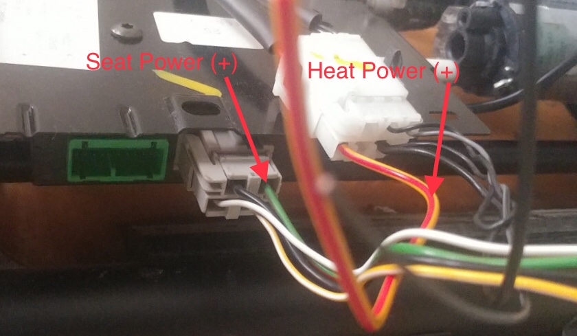

Finally got a minute to review the diagrams.
There are only 4 wires to worry about here:
Seat Power 12 VDC (+) is Green/Red protected by an auto reset
thermal circuit breaker in position 11C/39 - Amps Unknown...
(Anybody have the cover off their fusebox that can have a look?)
Ground is the black wire next to it on the same connector.
Put 12 volts and ground to these two leads, plug in the control switches
and it should work. ( You may have to power up the Yellow/White
wire that shows a connection to the key activated accessory
overload 105 relay 2/30 - Not sure).
Seat Heat Power 12 VDC (+) is Yellow/Red @ 25 amps
Ground is the big black wire on the same connector.
You can tape and stow the extra wires.
