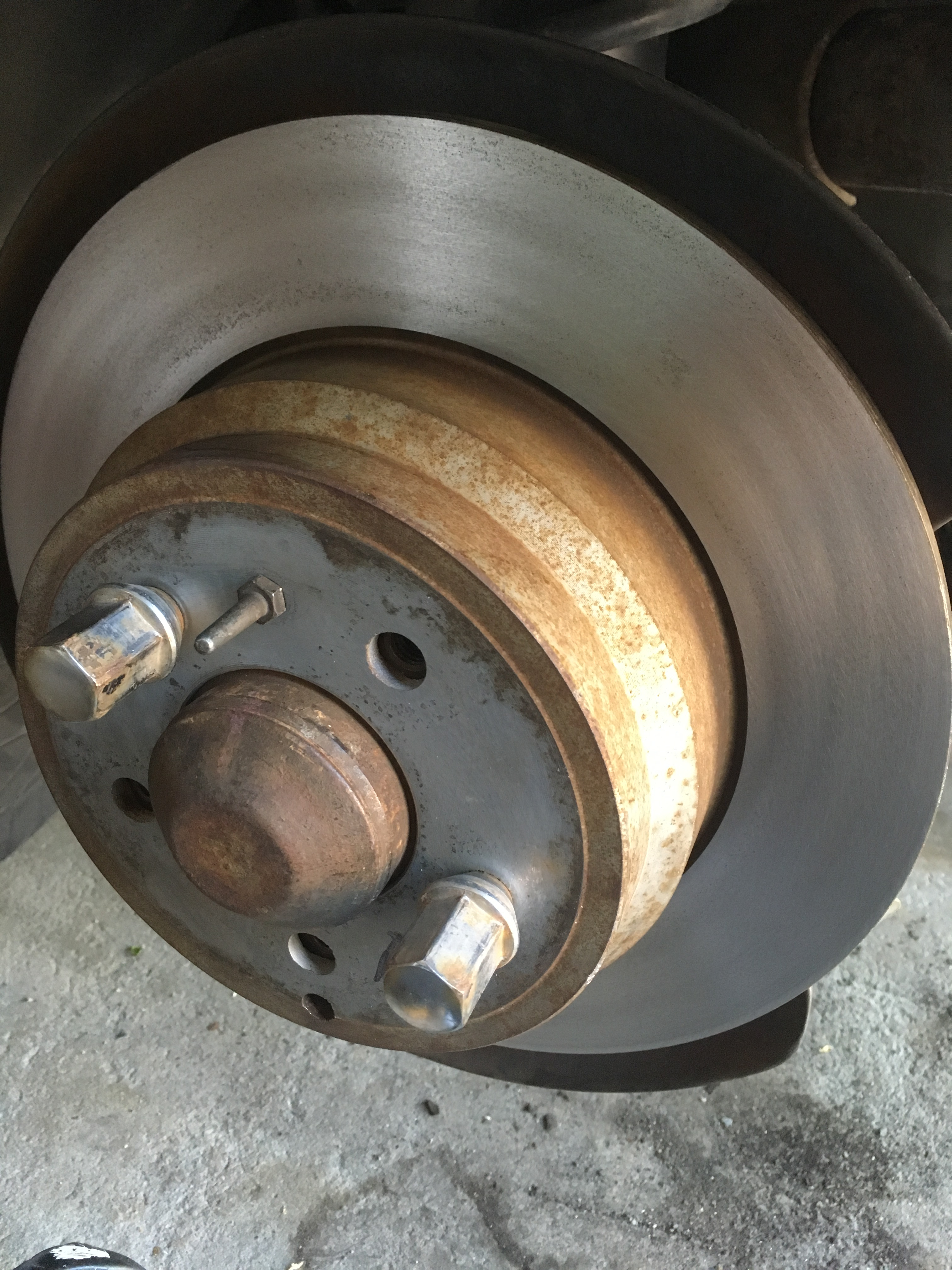

Eddystone - not rambling at all. Thanks. Bad steel is an interesting thought - I think they were a moderate price option from ipd or FCP. It could be that's a rust spot from sitting in the snow, I don't know - it's the only one on 4 sides. But for a bit, I wondered if I had an out-of-round rotor. My NAPA will turn rotors for $10 apiece - worth doing I think, to see if that spot carves away.
abscate - thank you. As you suggest, I'll run fluid through both rears and bleed. Earlier you suggested using a block that allows the pistons to travel inward about half the pad thickness. Are you saying press the pads towards this block with the pedal, then manually press them into the bores and repeat a few times to get some movement?
scot(Neil) - I did not know that about bedding parking shoes. But I've never actually messed with a parking brakes other than some adjustment. (remember when American cars adjusted themselves when you braked backing up?) Some of my cars have had a parking brake mechanism that pinches the regular disc pads into the rotor. The drum interior is a bit rusty dusty because I had the shoes backed way off after installing the rotors, and they were just barely touching on the left side.
Cables seem to be fine. Everything underneath looks very sound and surprisingly clean. Brake handle now grabs solid at about halfway up - didn't count the clicks yet.

LR rotor is scraping on rotation ('94 855T)

Pull the pads out and put a block in about half their thickness. This lets the piston move farther out in the caliper and flushthe working area of the caliper. Feel the piston and see if it I still smoothly moving

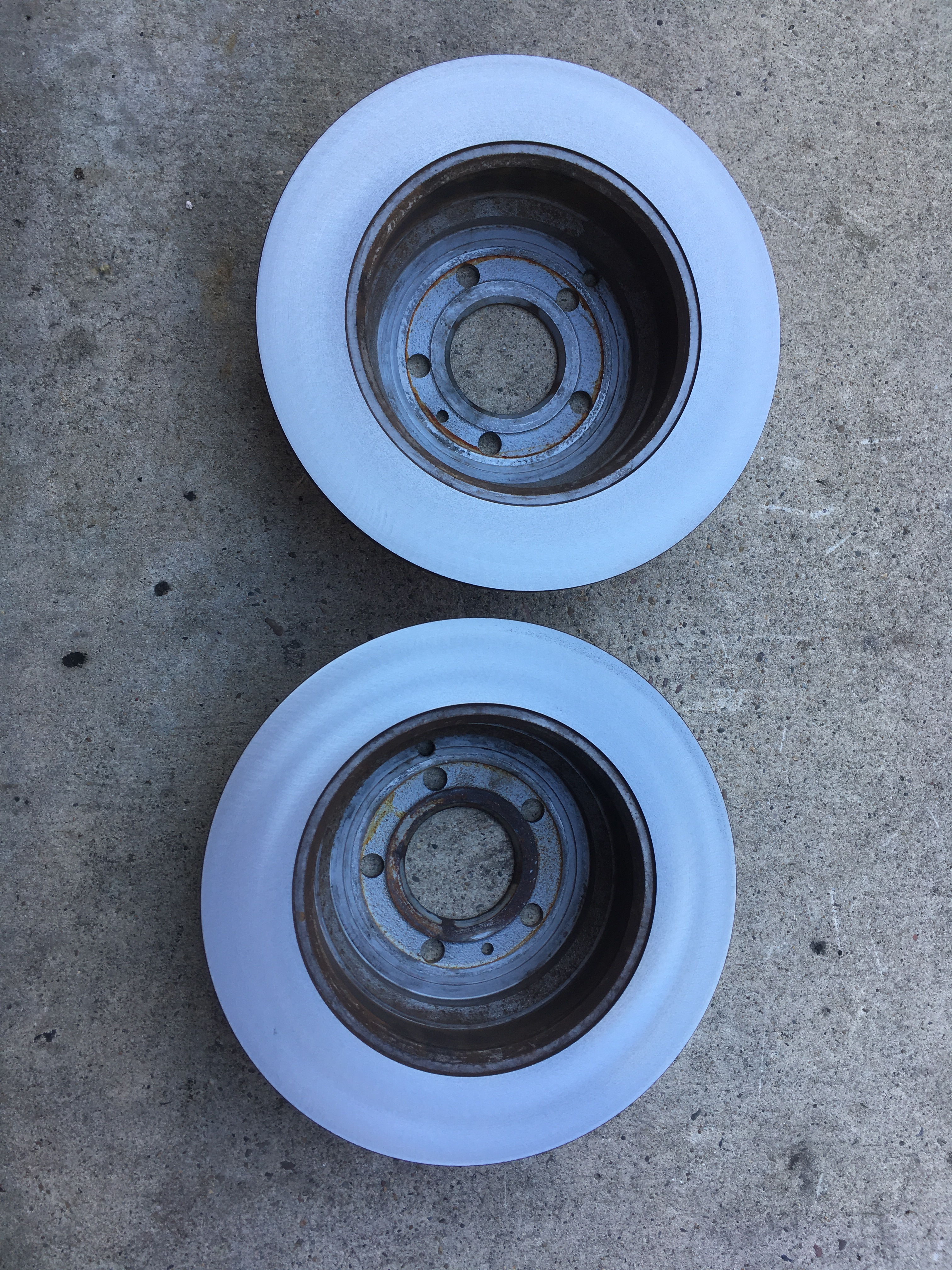

I think these are Zimmermann, from ipd. They are pretty new mileage-wise, and have never been cut, and have no rust ridge at the outer edge. I just want to clean them up and make sure they're flat.

Shiny flat rotors....10 bucks apiece at NAPA. It looks like they use a rotary stone rather than a cutting lathe as they have a swirl texture to them.
I think I'll replace the pad hardware too, as it's a bit rusted and the left spring clip might be just touching the rotor.
That funny spot on the inside is gone and he only cleaned off a thousandth.
I took a block with rough sandpaper to the pads to clean any glaze off.
