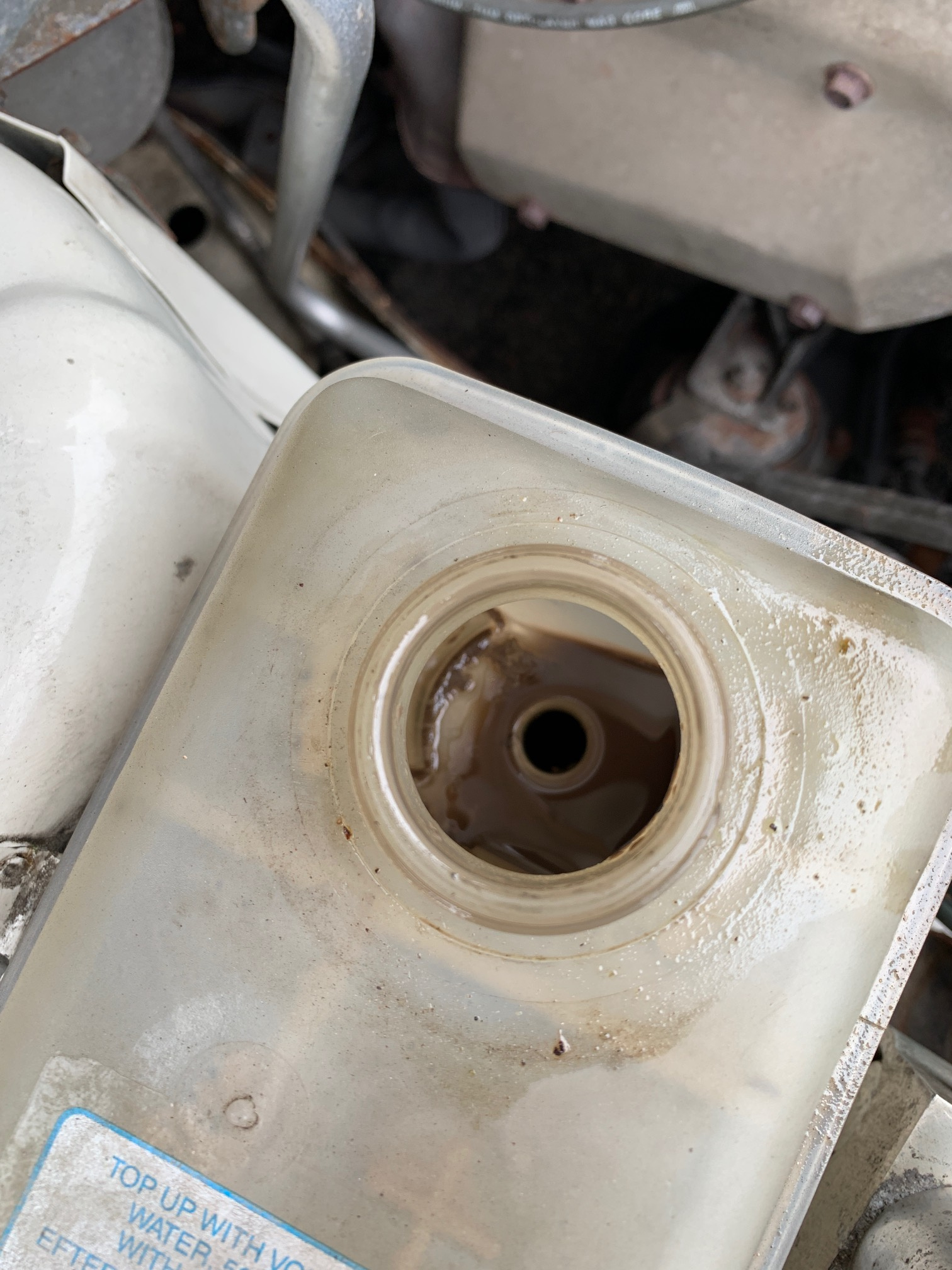

Once I parked, i popped the hood. There wasnt a lot of steam, nothing seemed blown out, but the engine sounded like it was boiling/gurgling, and the expansion tank of coolant was empty. Looked like it had some black sludge in the bottom. Upon further examination after letting it sit for a few days I also noticed my transmission dipstick was bone dry as well.

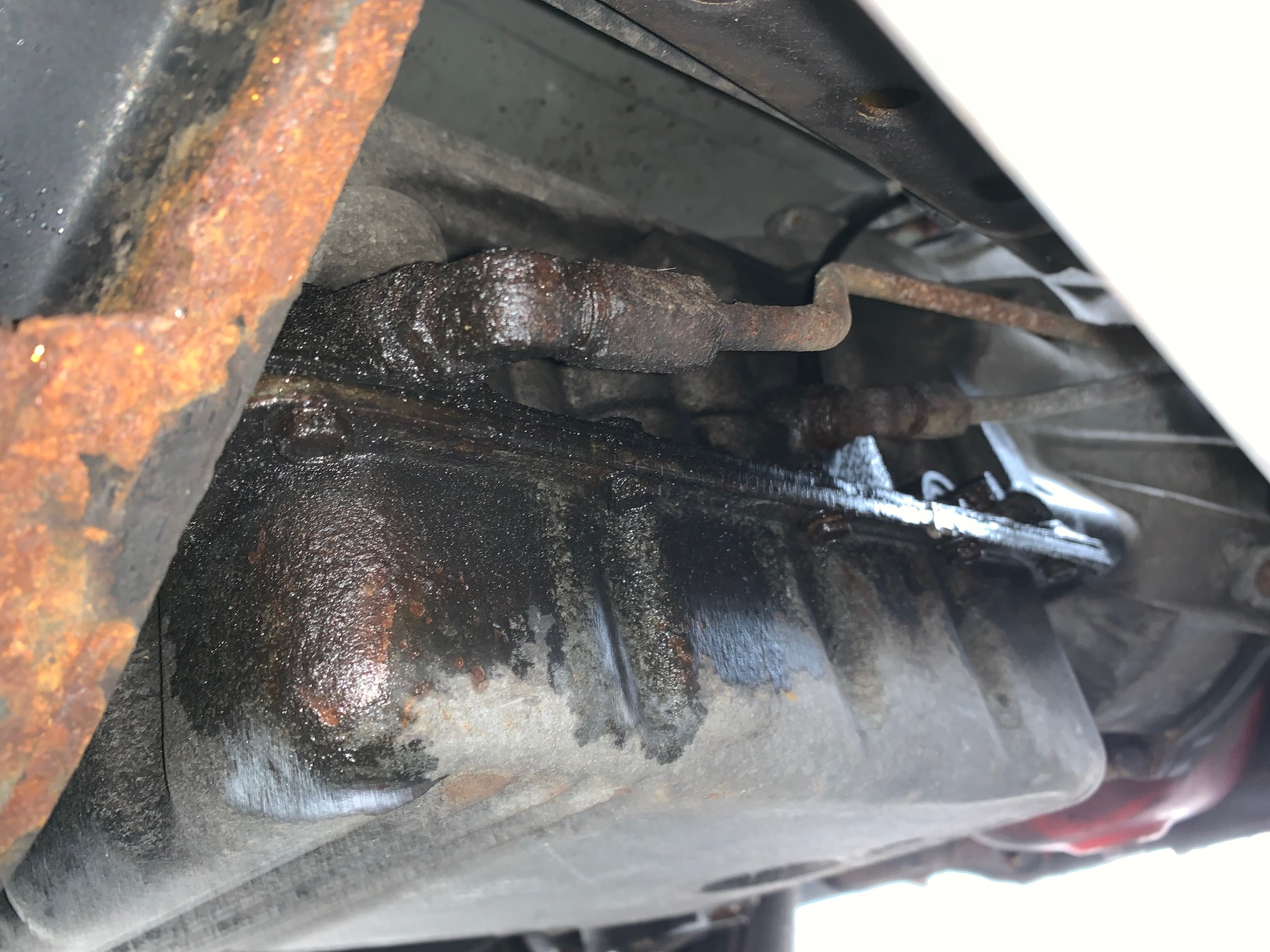

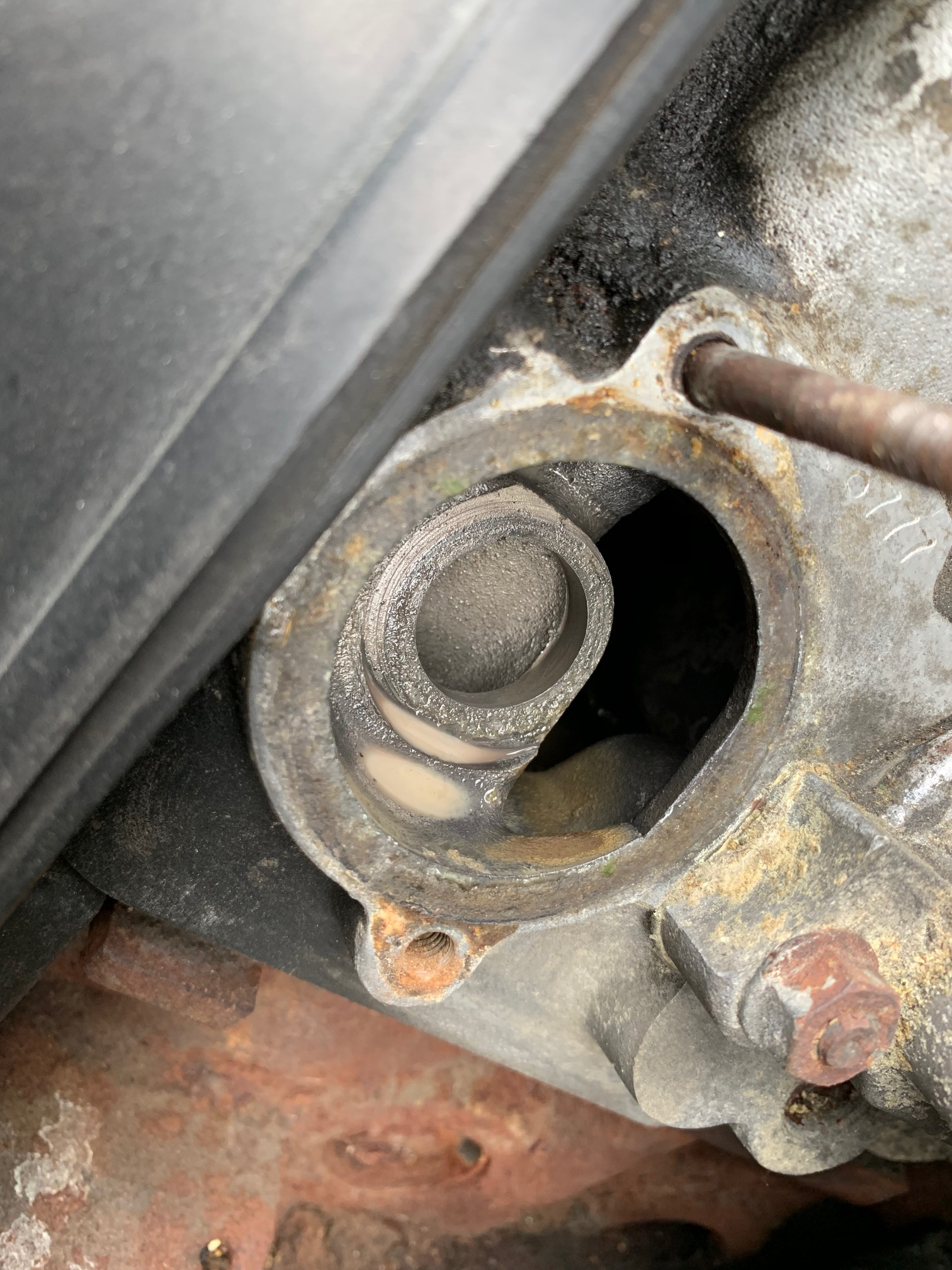

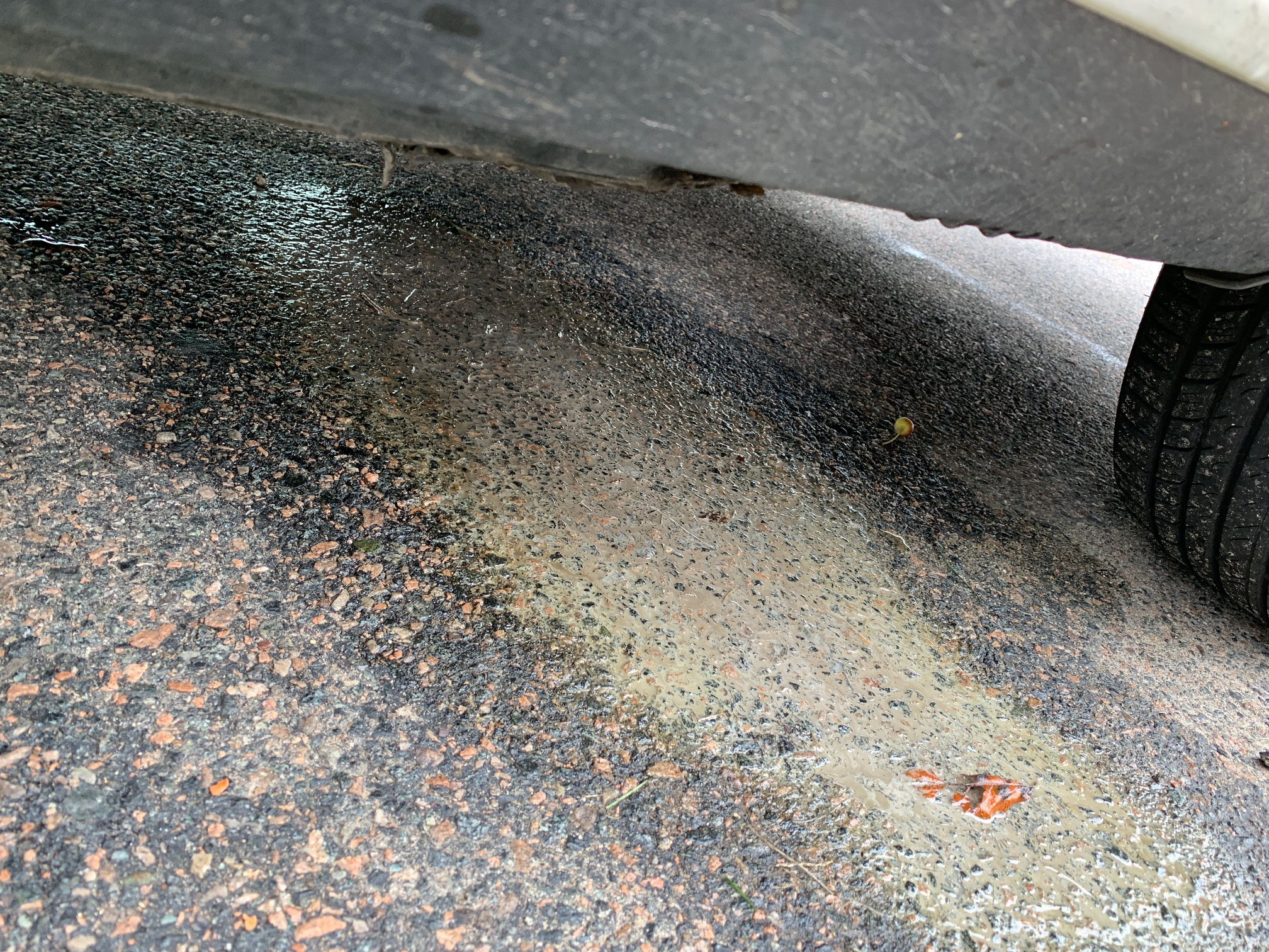

Today, I changed the thermostat, and filled with coolant to prepare to flush the system. I noticed a grey, milky sludge in the engine that seemed to also be bone dry, instead of green coolant when i took off the thermostat housing. So i poured a gallon in to slosh things around, and was going to drain it when i noticed a puddle of this same grey milk pooling on the street under my transmission. I checked the dipstick, and it was halfway up the stick of the same grey, frothy fluid.
I never noticed any leaks before this so, based on my DIY knowlege of how this car works, I believe the issue is that the coolant and the transmission fluid is mixing in the radiator, which would explain both my overheating issue and my shifting issue. I cant tell exactly where the leak is coming from from the tranny though, its either the send/return line or possible i blew the transmission pan gasket? I'll attach some pics, any confirmation or direction would be hugely appreciated!!! Thanks!

This does not sound good for your engine or transmission. The milky liquid is typical of oil and coolant mixture. The transmission cooler could be cross contaminating the coolant if there is a leak in the transmission cooler portion. I would start with a pressure test of the trans cooler by disconnecting both tubes at the radiator and then clamping hoses to the cooler fittings. Plug one of the fittings and apply low pressure air (maybe 10 PSI) to the other fitting. Try to tee a pressure gauge in the air line. Apply the air and see if the cooler will hold pressure. If cooler will not hold pressure you have confirmed the leak.
Then get another radiator - it must be for an auto trans car to have the cooler. Clean and flush both engine coolant and the transmission. I would drop the trans pan and change the filter after you determine where it the trans has leaked. The trans may be toast.
