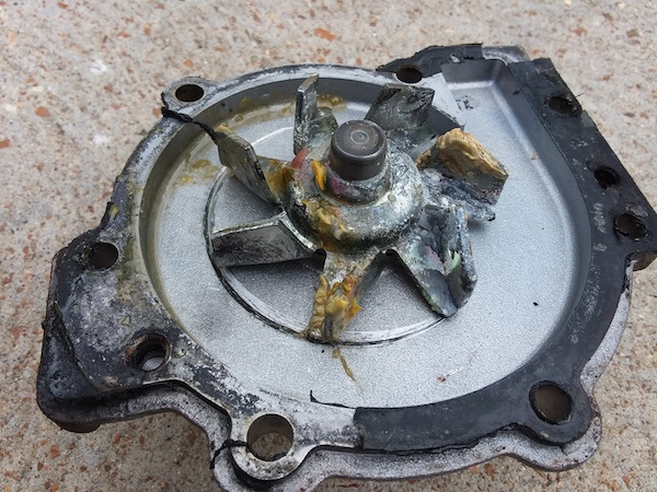

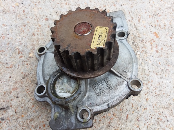

This was one I bought and a quick look under the timing belt cover to verify it had been done recently as marked caused me to figure I was ok for awhile. Cost me a motor.

Did that seize up and strip the timing belt?

Sorry to see the seized pump.
Any idea how long the pump had been in use? Is there a date code on the body of the pump?

And what's that cheese on the impeller? Did someone try coolant stop leak on it maybe?

If they did, that could explain the bearing going south... Assuming the pump wasn't the leak point to begin with...
