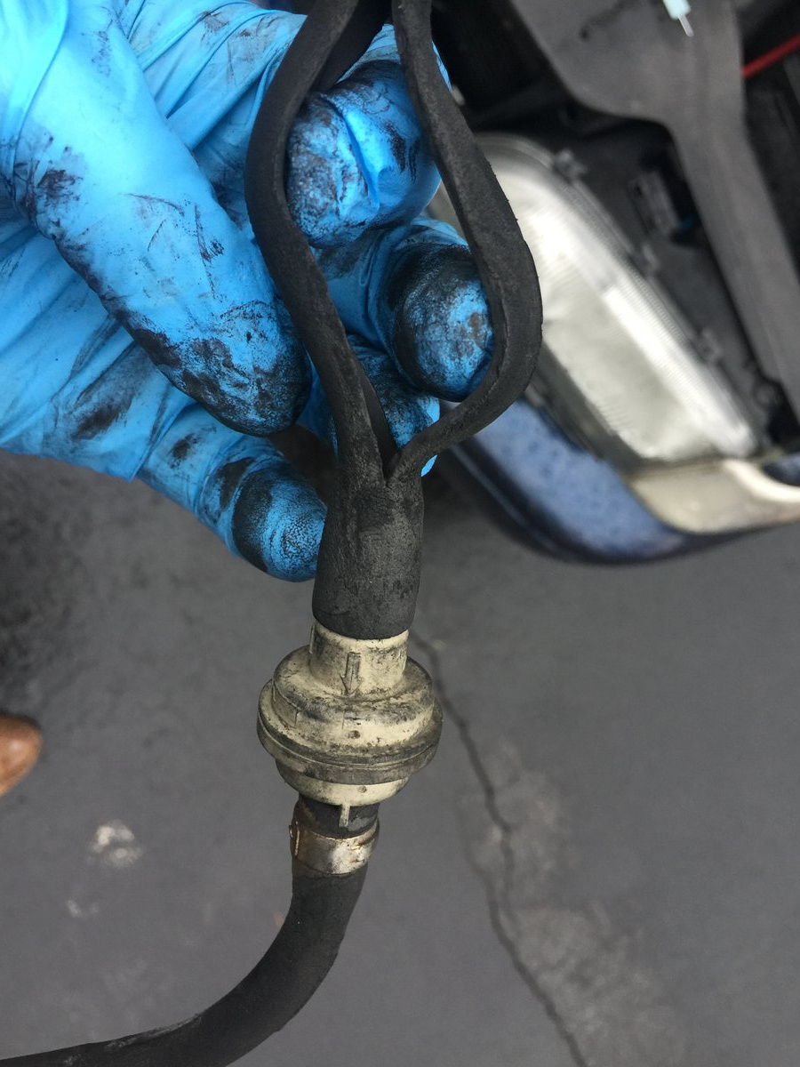

Latest update. On the cycling of the purge valve I swapped valves with no difference. I then decided to check the previously replace 2 size vacuum line that comes from the center of the manifold to a T fitting. This contained the line that split along the length of the larger of the two lines. In the middle was an "adapter". Actually it is a CHECK VALVE. It only is supposed to allow vacuum to be applied from the engine to the purge valve. However it is a line that goes to a T fitting and I suspect under boost the valve prevents any pressure from affecting the dynamics of the manifold. When I compared my check valve to another from the PnP, mine would not seal in the "closed" direction. I replaced this and the purge valve has stopped cycling. Maybe just a coincidence. Still have not made EVAP monitor go to ready.

Some success. I have replaced all the vacuum lines for the EVAP/Purge valve system and another Purge Valve with OEM parts from a PnP. This is the line that originates at the (1999/2000 year) intake manifold's center nipple (approx: 1/4 " or 6mm diameter). I also reused the original 3-way adapter (sealed with "liquid electrical tape" ) that comes from the cylinder #5 exit port (approx: 1/2" or 12mm diameter). I most recently replaced the vacuum line from the T fitting that goes to the nipple on the intake tube near the PTC valve. ALL of the adapters used on the vacuum lines are ONE WAY CHECK VALVES.
If you check out the photo of the spit hose and check valve you will notice the adapter/check valve on the line that caused a P0455 code. I have no idea how long this split existed. What I realized is that this created an unfiltered source of air being sucked into the check valve by manifold vacuum. I suspect that dirt OR disintegrating rubber from the hose was introduced into the valve and contaminated the check valve and prevented it from functioning properly.
In the picture you will notice there is an arrow. This indicates the flow direction of the vacuum. A quick test of sucking and blowing into the valve will show whether it is closing and actually functioning as a one way valve. Mine did not seal.
The 3-way adapter on the larger line is also a one way valve and there is an additional small grey one way check valve that goes toward the brake booster.
In one sense these valves allow for vacuum to be applied where and when they are needed. As an example if your engine stalls you still have vacuum in the brake booster for at least one application of the brakes. If you pump the brakes you eventually lose the "boost" on you brakes. This is one reason that the check valves are important. Another is when we are running under turbo boost pressure. Others can contribute about how that effects the vacuum circuits but I am guessing the check valves play a role in keeping the engine performing under all conditions.
