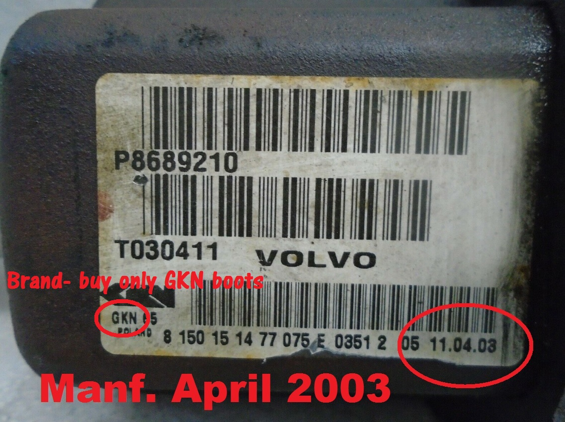

If I were to look for a set of used OEM axles to rebuild, can anyone tell me how I would go about verifying that they were OEM? Does anyone know which cars had the same axles? (2003 V70).

Post by oragex »
OEM have the Volvo sticker to them, at the bottom of the sticker you have the manufacturing date. Also notice the GKN brand - this is the boot brand to buy for replacement
GKN drive shafts and boots:
https://www.carid.com/2003-volvo-v70-dr ... %5B%5D=GKN
They also come originally with heavy duty clamps like on this one www.youtube.com/watch?v=1mkWzAaHyJE
The best choice would be an OEM one that was recently completely replaced. Many get just the outer boot replaced - replacement boot is hard plastic
Getting a used axle is a gamble - even with just a slight play to them, they may vibrate on highway
Not 100% sure but I think compatibility wise is all about having the same transmission. There are about 2 automatic transmissions I think, the Aisin 5 speed and the Aisin AWTF-80 SC 6 speeds with man shifting - at least the right drive shaft is longer on the 5 speed.
