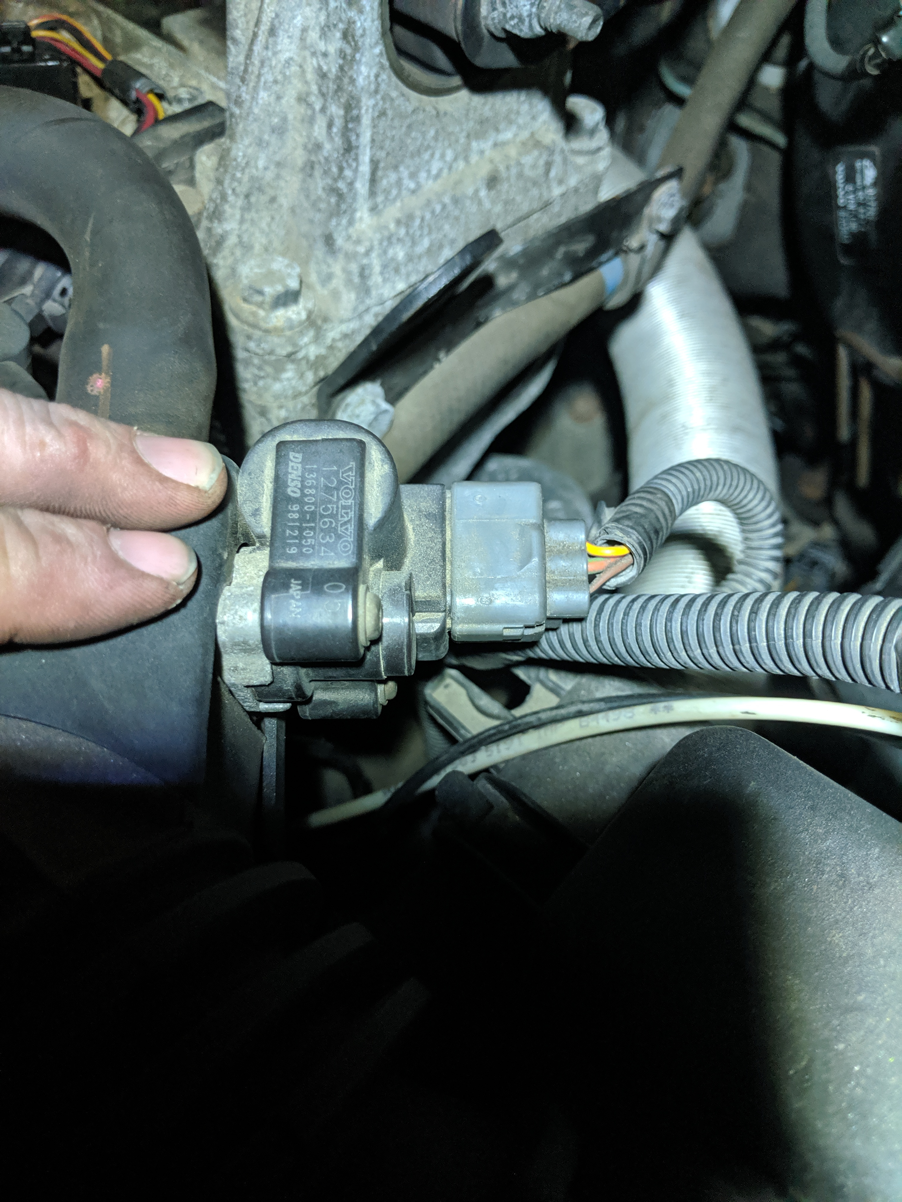

Just replaced the battery and still having the same problem. I noticed that after trying to start it that I can hear an electrical noise coming from this piece. When I touch it I feel it vibrating, when I unplug it it stops and starts again. After about 1 minute it stopped vibrating and I heard a click.. so maybe it's stuck open or closed? Or a relay?
