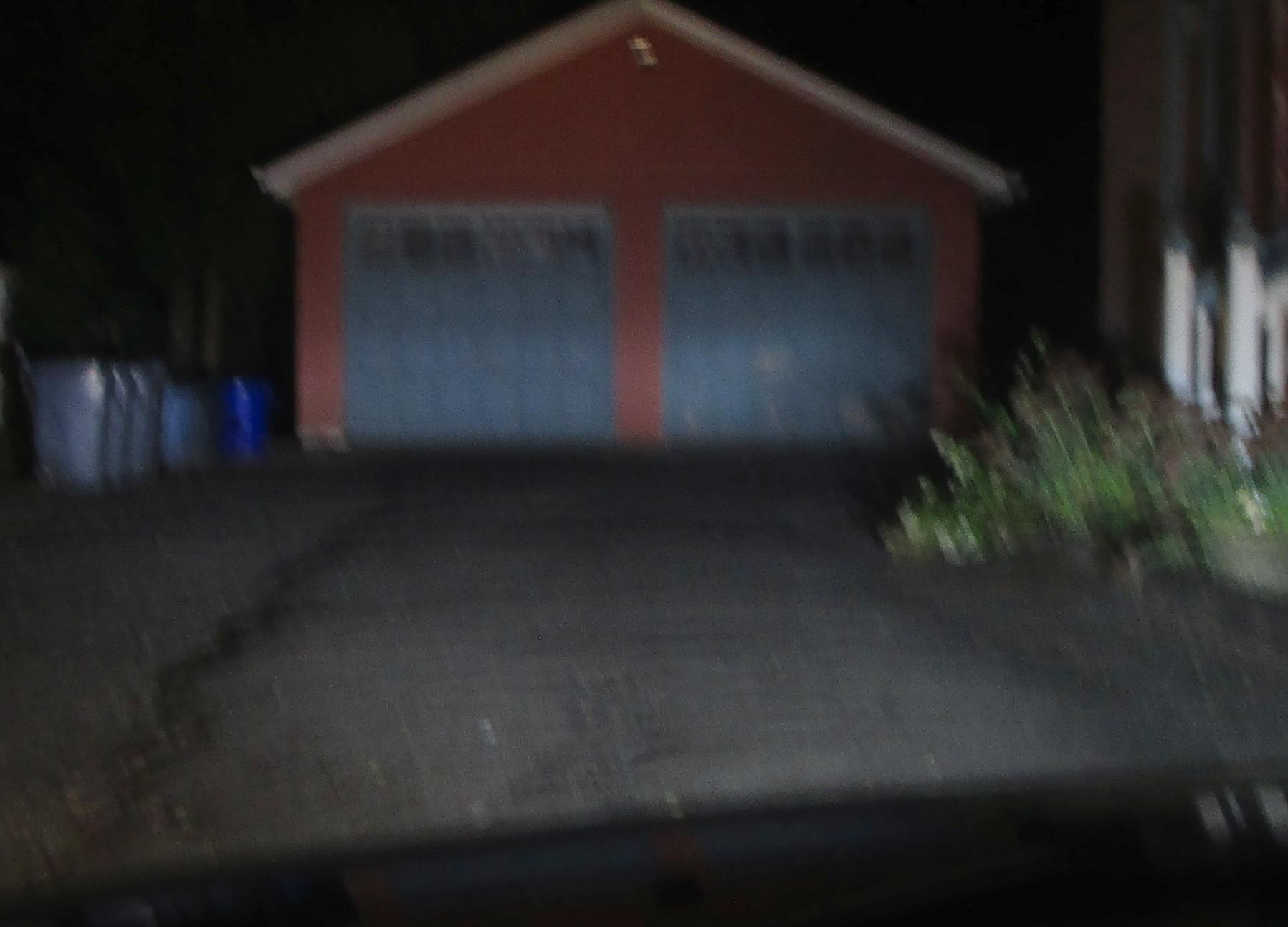

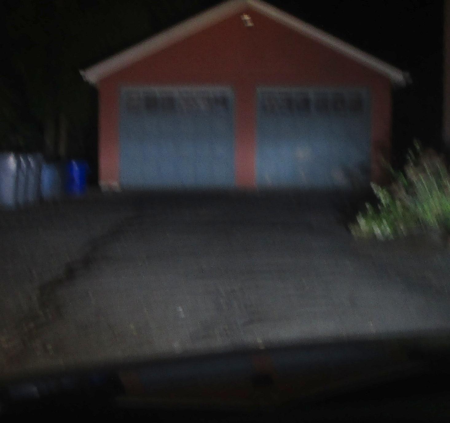

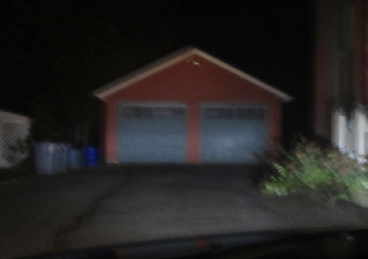

Here is a brief comparison of an LED headlight vs a stock Halogen.
For the test the passenger side halogen was replaced with an LED unit while the drivers side was not changed and so has the stock halogen that had been in the car ever since i had it. This means the right side of each pic depicts the brigntness from the LED light while the left side shows the halogen. The target was a set of garage doors painted a yucky green color. The photos were taken with the flash turned off.
As we can see from the photos the right garage door appears a little brighter and has a bright spot (that is the LED headlight) while the left door is a little dimmer but is more evenly lit.
Also note that the lighting just out in the immediate front of the car appears to be about the same on both sides.
I did not get to do the color rendition tests yet i was feeling a little under the weather yesterday/last night.
